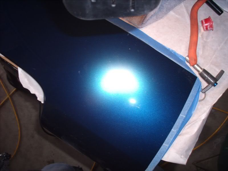

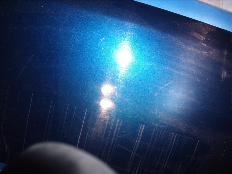

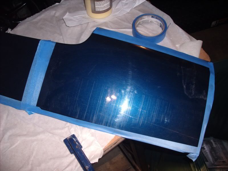

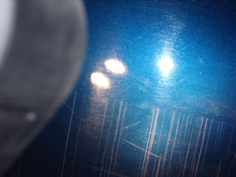

This is just a piece of a bumper I ripped off from somewhere (I believe it's a GM clear, but not entirely certain.
(lighting is under a Brinkman)
Before
After - 1 pass with cyclo, orange pads, and evolution extreme cut.

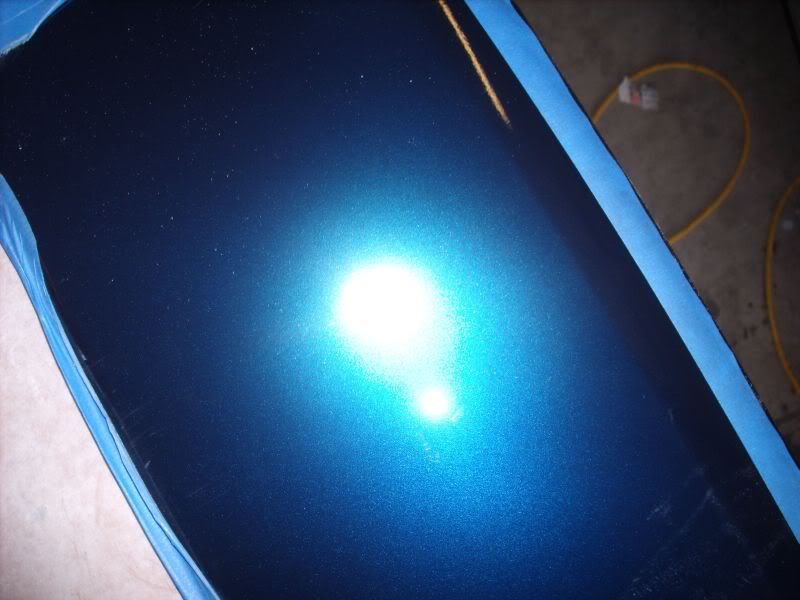

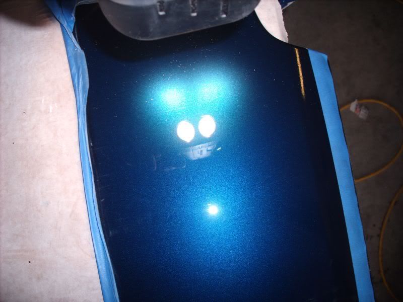

After 1 pass w/ cyclo/orange/evolution extreme cut followed by 1 pass w/ cyclo/green/evolution polish (least abbrassive)
Based on my highly unscientific and unthorough testing, the cyclo does seem to like it more-so than Menzerna (I usually do orange/SIP, green/106, then seal and wax).
Also, I was able to remove 2000grit sanding scratches with it and a cyclo and orange pads using moderate pressure.
