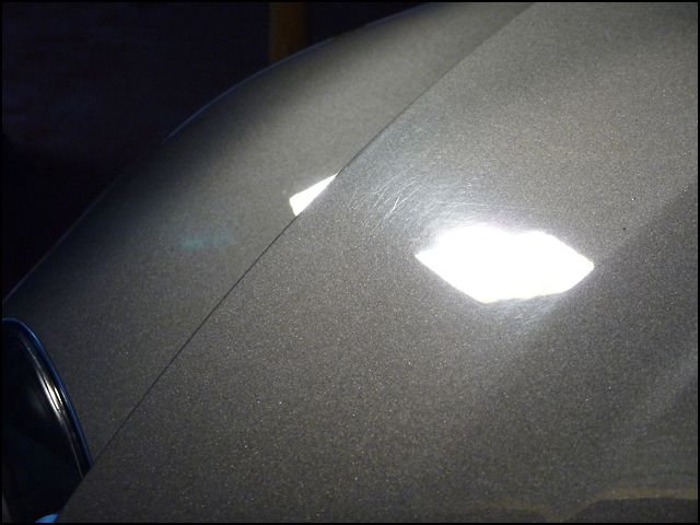

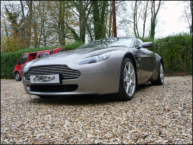

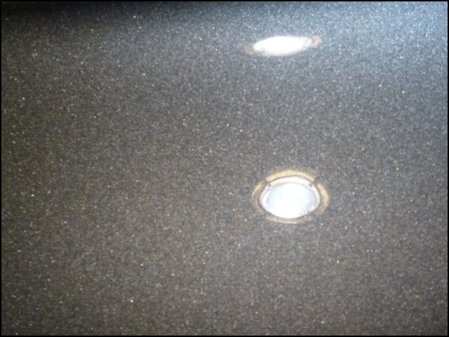

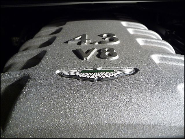

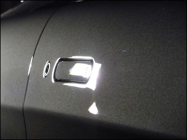

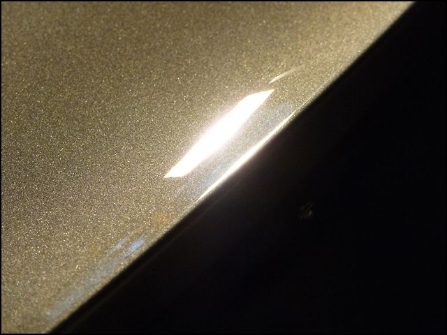

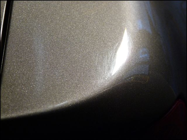

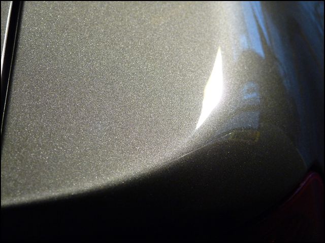

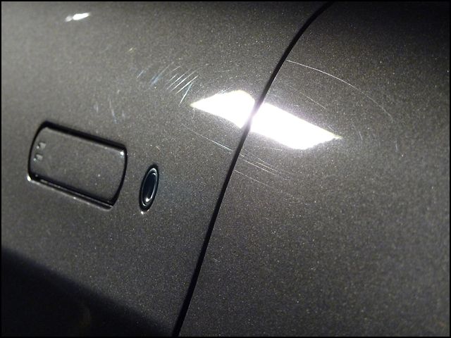

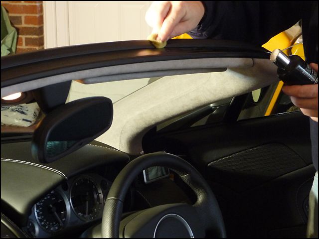

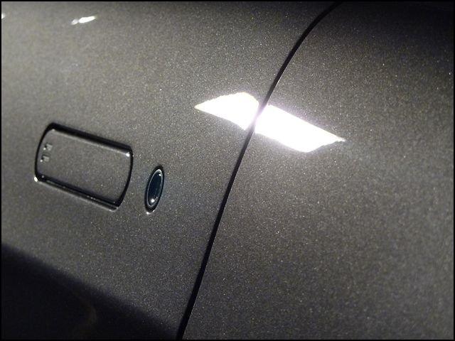

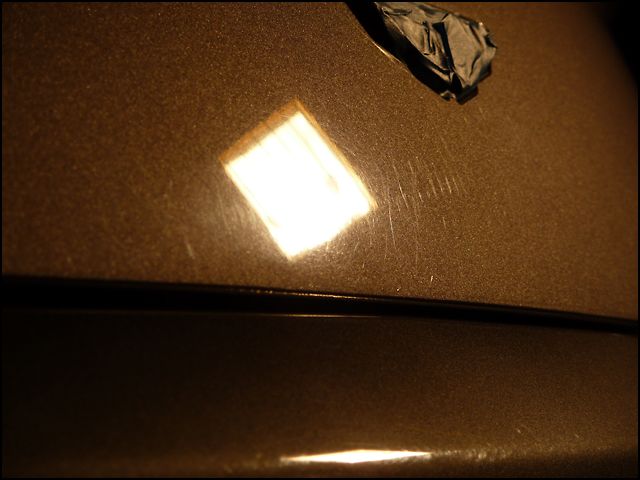

Vehicle given the usual wet stages - foam, wash, clay. Convertible top was cleaned and then protected with 303
Correction was carried out using Menz 3.02 on a Megs cutting pad, a drop of FCP was used in some area's
DA sanding marks were found on most panels, common thing with Astons
Paintwork was then refined using Megs 205
Cleaner fluid applied and then a coat of Swissvax Divine. Left this to cure whilst I carried on with some of the small jobs such as polishing the exhausts and cleaning the leather
All seals conditioned using swissvax seal feed
Cleaner fluid applied to wheels and removed and then each recieved a coat of swissvax autobahn. Tyres dress with Swissvax Pneu
End result

Beautiful job...I can't believe that these expensive exotic cars are sent out of the factory with sanding marks all over the place like that. They should be ashamed...Anyhow, nice work...
