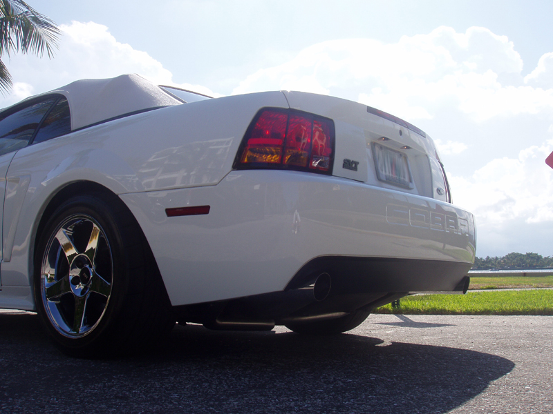

I used Menzerna IP, AIO and Zaino ZFX/Z5 x3 on my white "beater" last year and it looked awesome!
