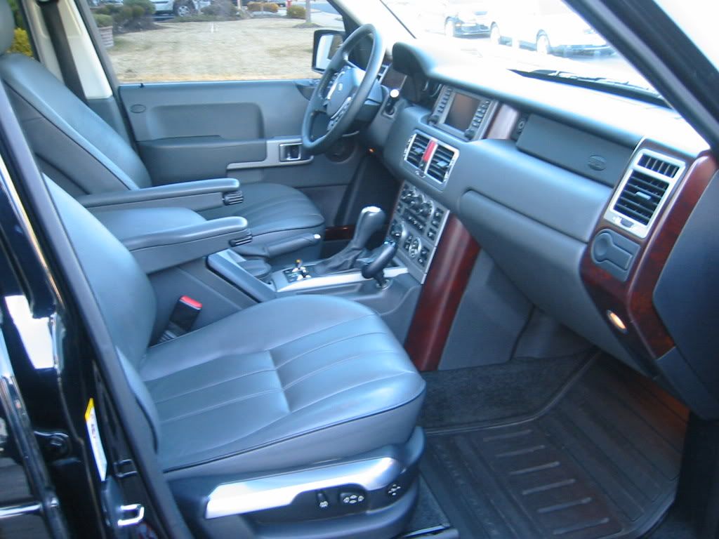

Interior
- Vacuum
- Steam/ Xtract all caprets.
- clean all interior plastics
- Clean leather and then condition
- clean all windows.

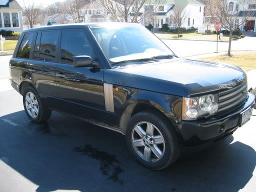

Sorry my pics are not great I am working on getting myself a new camera soon.

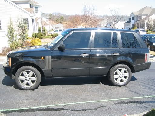

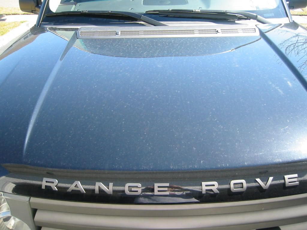

Before

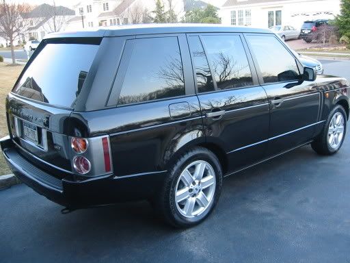

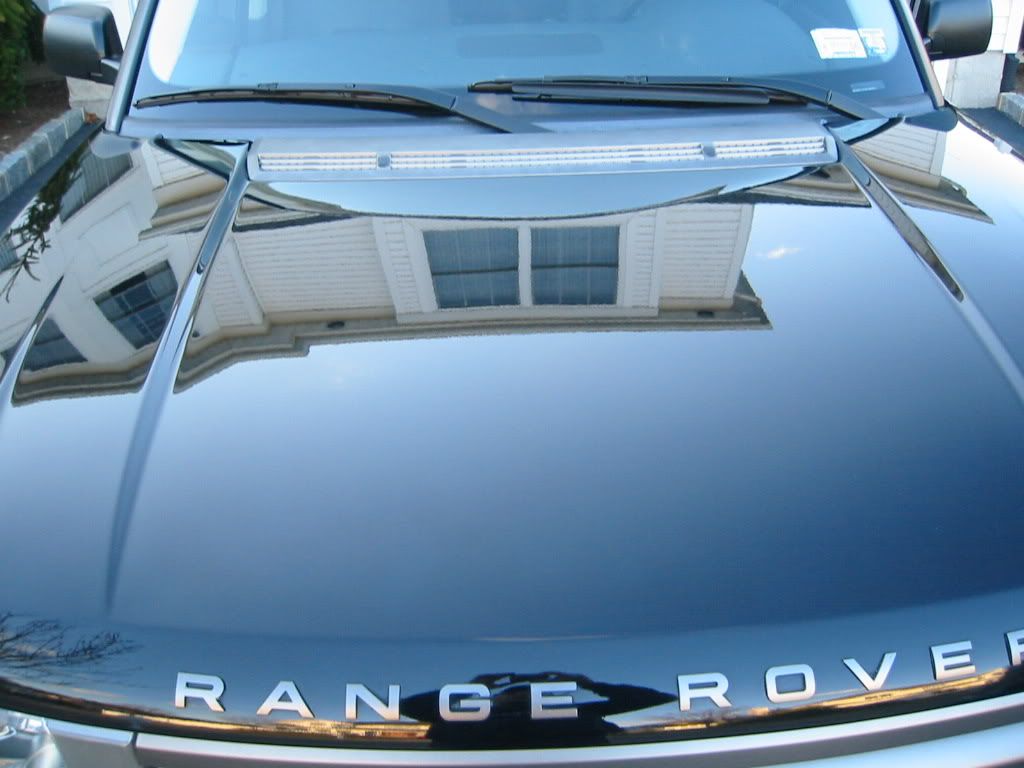

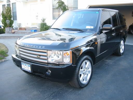

After
I wish I had time to post more of my details, with 2 jobs and a wedding to plan I have no time to even post pictures of the work I take most pride in.
I found the clear to be easy to work on. I did wetsand some spots out though with 1500 and then 2000 grit sandpaper, but that was due to the finish being in such poor shape. Car was full of acid rain spots and scratches.
