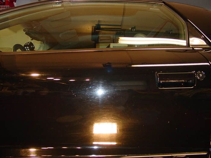

I went up to help him today with this one. The swirls were terrible, to say the least. They were very deep and VERY hard to remove. We tried at least a half a dozen polishes before deciding on a nice combo.
Patrick had me over to watch me on the rotary and also so I could critique him on it. In the end, we were all happy with the results (owner too). I'd say about 90% of the defects were removed and the exterior took about 4+ hours. Final processes:
-Wash and Clay (Patrick had it done before I got there :))
-Meguiar's DACP and tufted cutting pad via rotary @ 2000 rpm
-Poorboy
s SSR 2.5/Menzerna IP and Edge 2000 Cutting pad via PC @ 6 (front bumper)
-Menzerna FPII and LC Polishing Pad via rotary @ 1500 rpm
-Mystery LSP spit shined with PB S+G

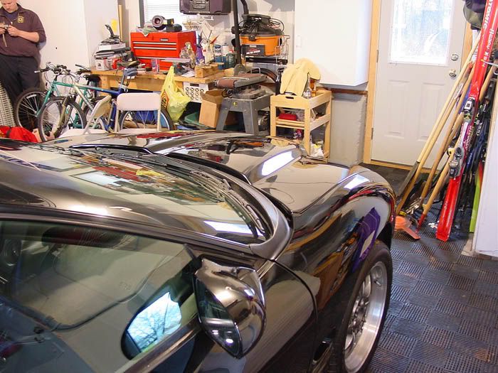

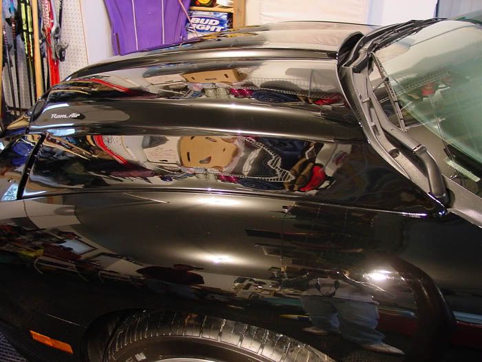

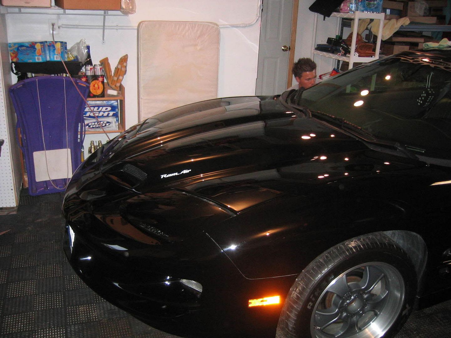

Before

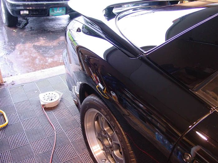

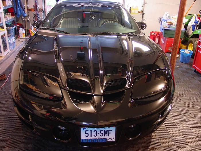

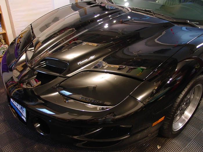

After

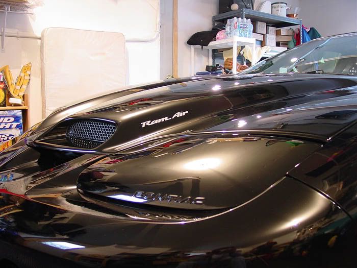

And my personal favorite
You can guess all you want, but you probably won't get the topper. I was VERY surpried on how good it looked when we finished.

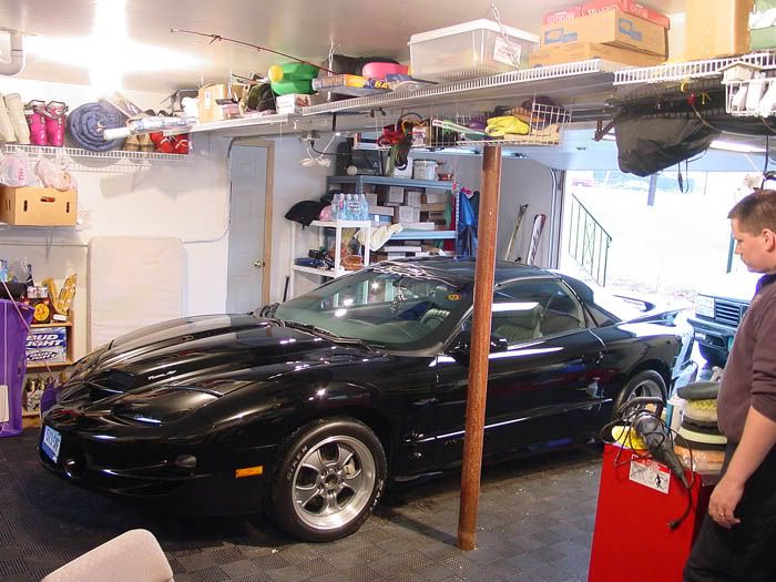

BTW, just a little trick I've found that works for me that will work for you and everyone else. Dress the tires/fenderwells before your final polishing so there is no chance of any overspray on the freshly waxed paint. I notice in the one pic the car is shining like crazy but the fenderwells weren't yet dressed. Just thought I'd pass along the suggestion. ;)
