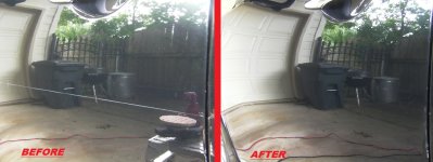

Below is my Client's door where she thought she was going to have to pay the shop to get it repainted, this was one long scratch that went from her front fender all the way to her quarter panel with some of the areas being deeper (you can only notice those if you're at a certain angle and a handful of inches away). Surface prep work is VERY important when doing touch up cover up to ensure it'll last you a decent time before having to finally re-paint. Hope this helps and good luck!
*EDIT:Note that the below was wetsanded with 3k grit, followed by M105 on Yellow LC CCS Pad,then Orange, then White on a pc , 4" Pads. Touch up paint was not needed*
