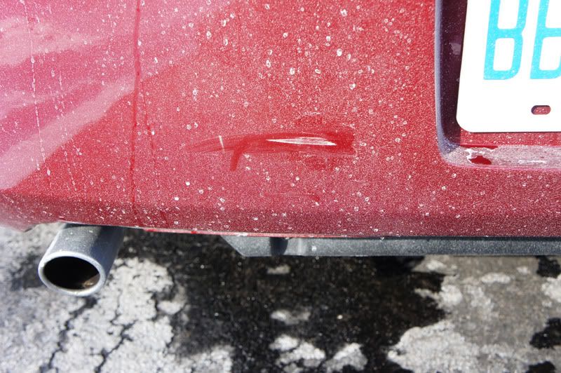

Anyways, one week after I pick up the car someone decided to jam a shopping cart into the rear bumper.
Damage:

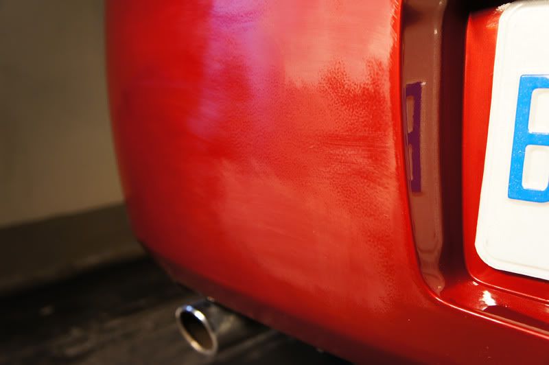

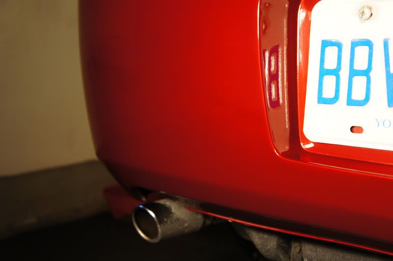

Sanded w/ 2000 unigrit and 3000 unigrit by hand. Blended the area around the big gouge and a small section of scratches a few inches above. I need to sand all the repainted panels anyways but I'm not doing that in the middle of the winter. Compounded with Meguiars M95 / Optimum Hyper Compound on orange ccs, polished with Optimum Hyper Polish and sealed with FK1000p.
95% removed, there is a slight crease where the damage was.

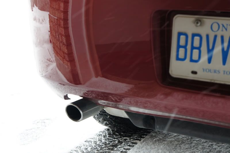

And a picture outside (forgive the colour difference, and snow. The first picture was taken 1 hour prior and it was a beautiful day)
