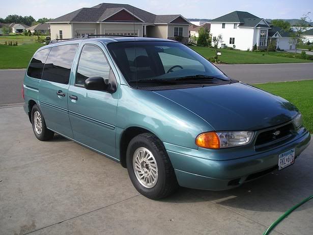

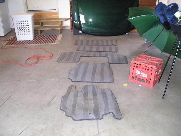

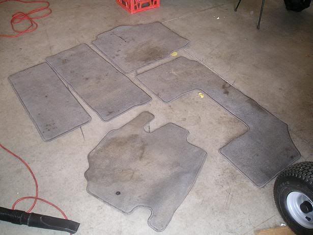

Hello everyone! This was a detail I did for someone in our neighbor hood. It took me 9.5 hours to complete. I was shorted $25 on this detail to so Im not the happiest of campers. More to come on that in a seperate thread.

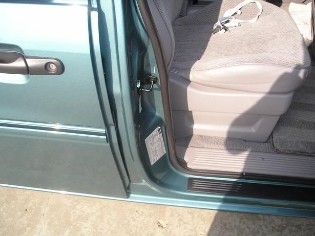

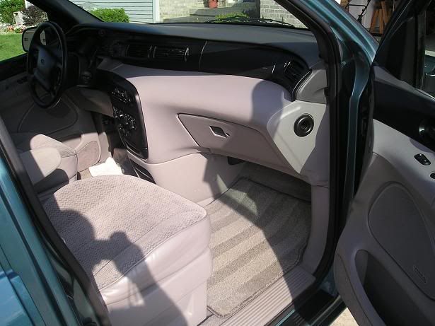

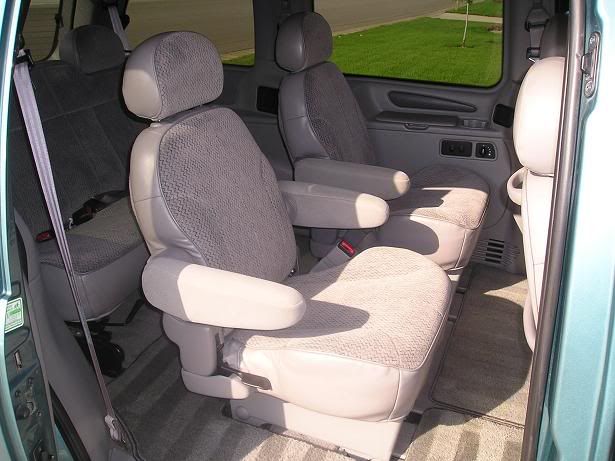

Interior
Oxy/Folex/APC
Extracted shop vac
Magic Eraser to clean scuffs
#40

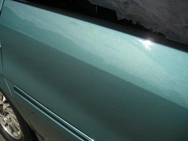

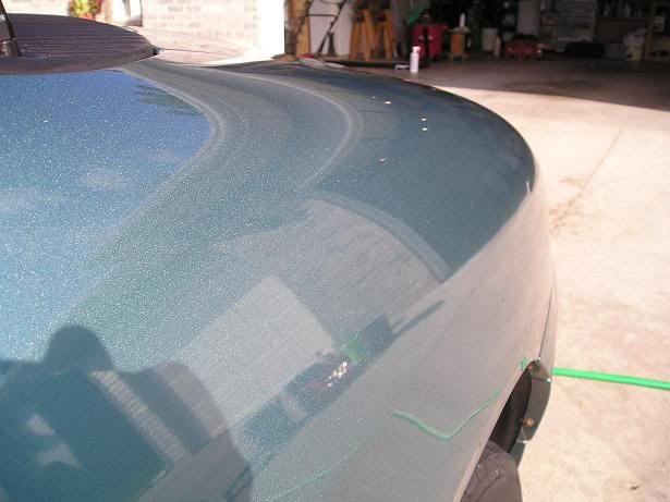

Exterior
Wash HT bubbling suds
PB clay
optimum via orange light cut pad on hood @1500 rpm
optimum via white polishing pad on everything @1500 rpm
PwC blue via hand
Pinnacle Signature via hand
Spray and gloss before pictures
#40 on tires and wheels and trim
wheels got PB wheel sealant
IG on windows
