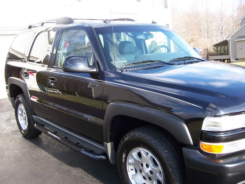

Here’s my first go-around with Zaino products. I was a skeptic of Z, and really didn’t have my hopes set too high. After years of reading and hearing about Z I had to try it. It's one of the few product lines that I haven't tried.
This detail was done over the course of 4-5 days. I spent the majority of my time on the polishing steps. The Z application was a piece of cake.
Process Used:
Wash: Optimum Car wash, with Vinegar/APC mix.
Clay: Optimum Clay
Wells/Wheels/Tires: Optimum APC, the tires and wells were dressed with NL.
Polish:
Menzerna IP, FPII, P085RD
Tools Used:
Metabo & PC. LC Polishing/Finishing pads. I was installing holograms like a mad man on the Metabo, and decided to switch to a DA early on.
After the polishing process I wiped down the paint using Z6 QD spray.
Seal:
ZFX/Z5 x 3, ZFX/Z2 Pro x 2, Z8 wipe down. In-between coats, I used Z6 to wipe down any residue on the paint.

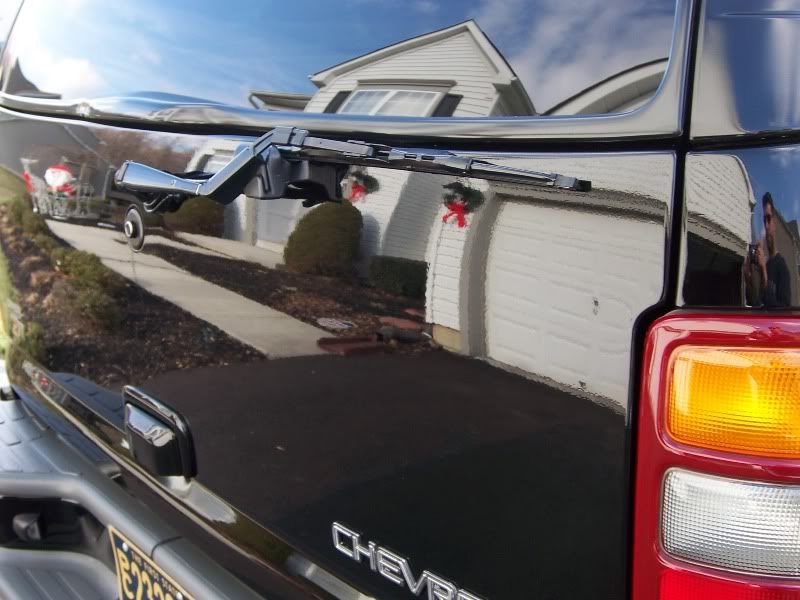

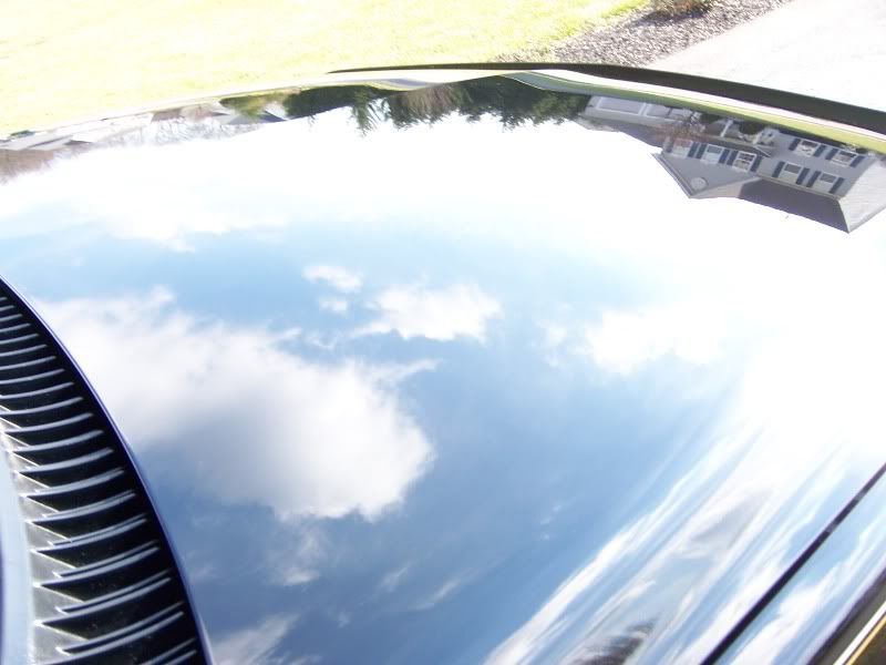

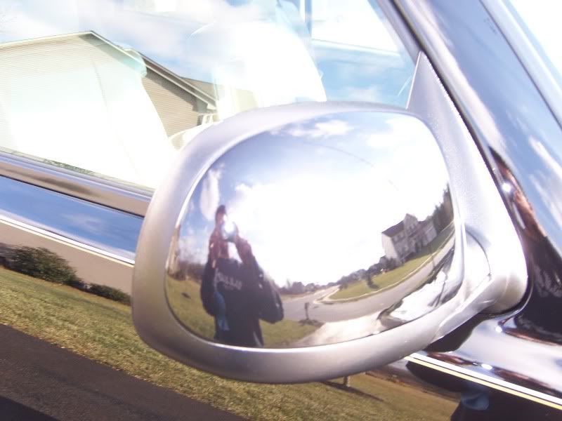

Here are a few after shots:
I plan to detail the STS over the weekend using ZPC and ZFX/Z2 pro. So far, I’m VERY impressed with Z5, Z2-Pro, and Z8
