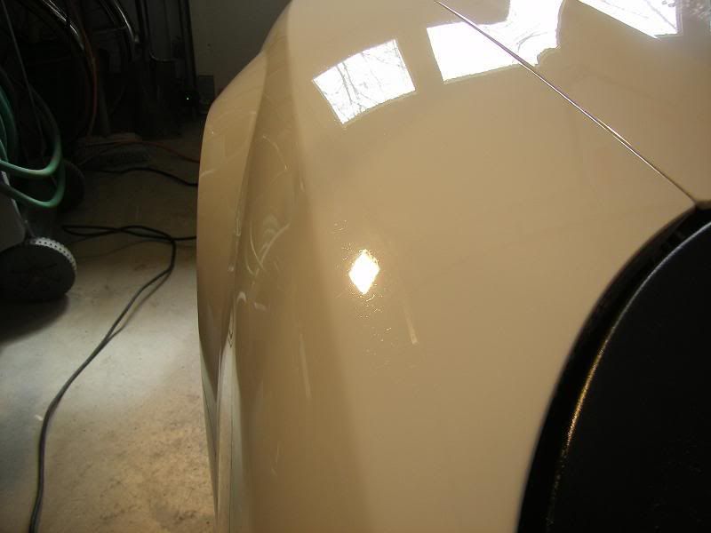

These are all the waterspots I was dealing with:

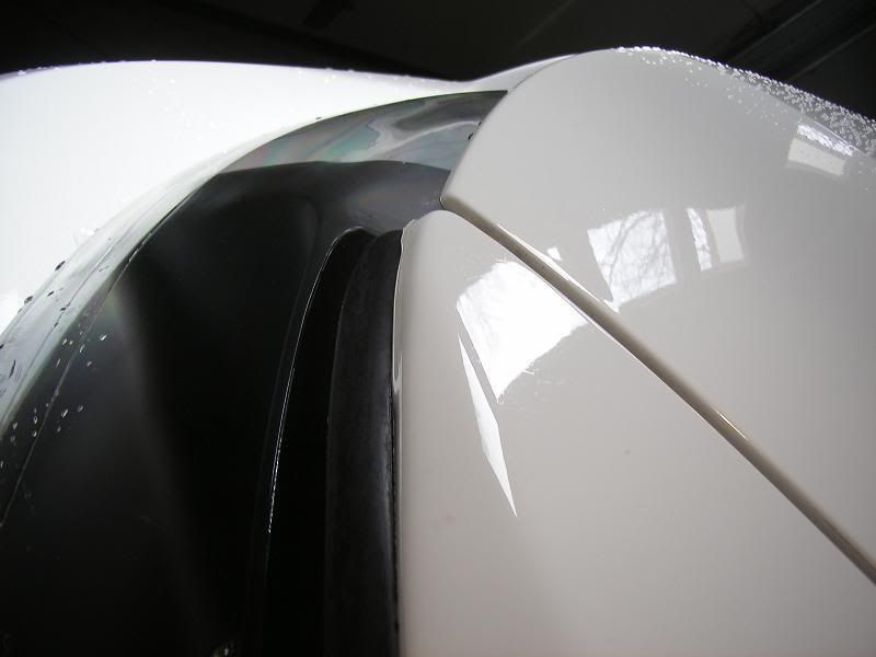

After Wetsanding:

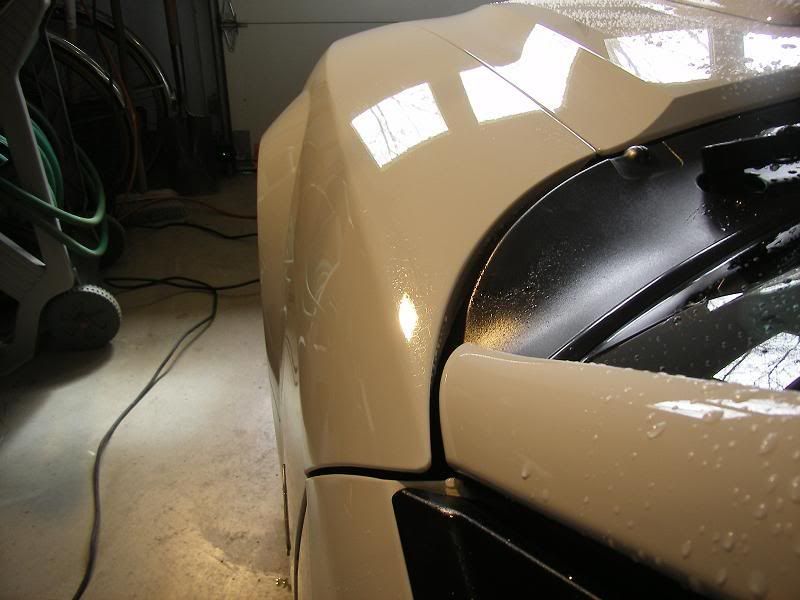

After Wetsanding:

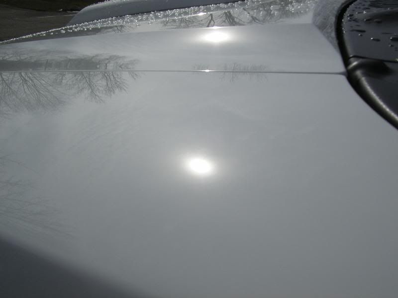

Final Product in the sun!
