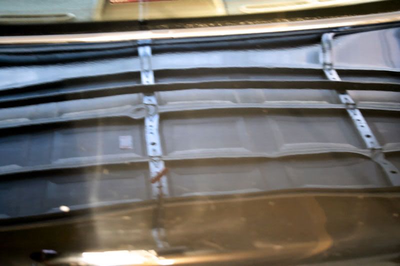

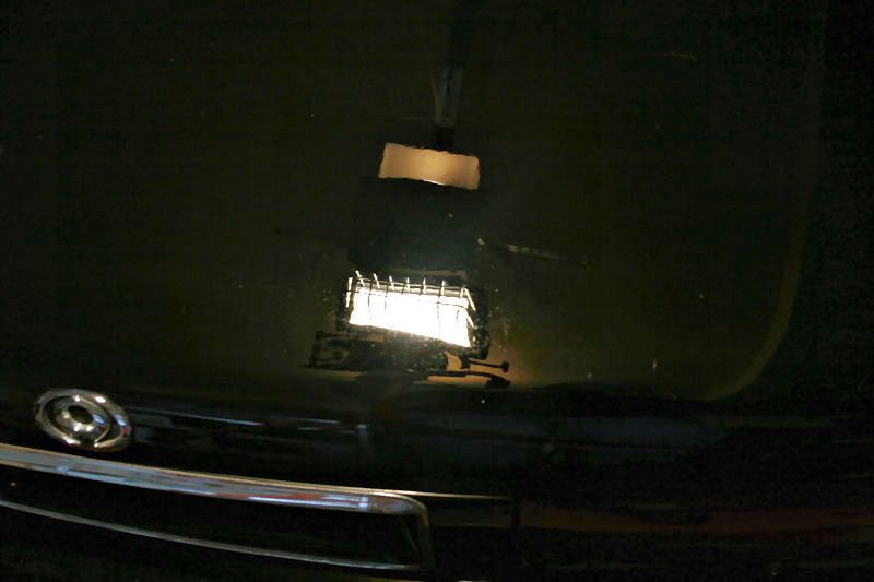

BEFORES:

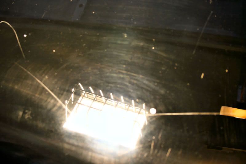

AFTER the first Step (IP and Yellow Pad):
little haze and some spider webs
not too bad of holograms

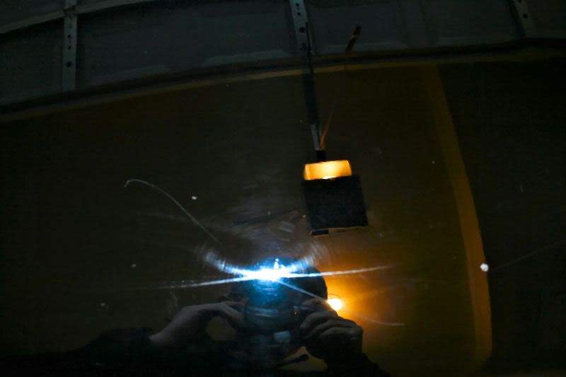

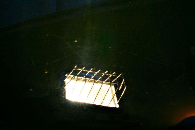

AFTER the second step (IP and Polishing Pad):
very minor spider webs, cant really see them but they were there

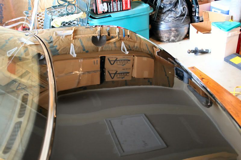

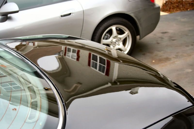

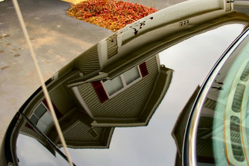

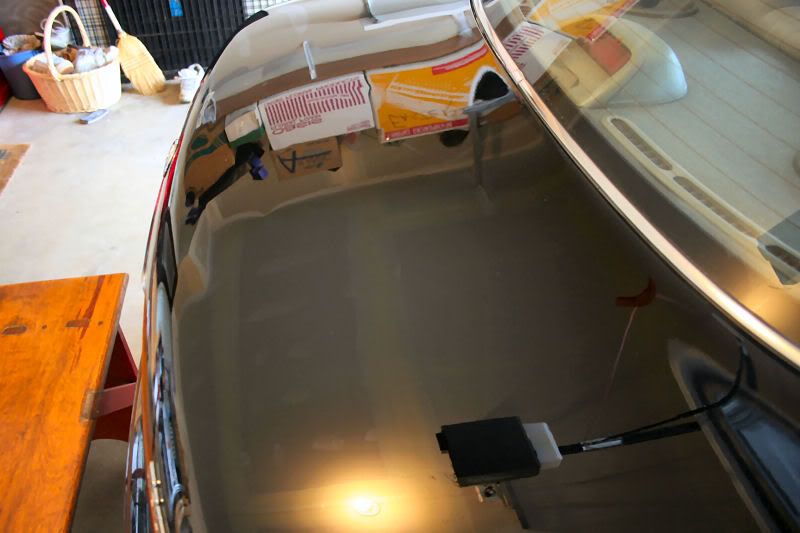

AFTER the last step (PO106FF and Polishing Pad):
Awesome job with the rotary, and its good to see you posting again. :up
Menzerna polishes are no joke, I only use them and Optimum.
Your photos really show off the final results well. You really brought the finish back. What did you decide to use for a LSP? I guess it is safe to assume that you like your new Makita?
