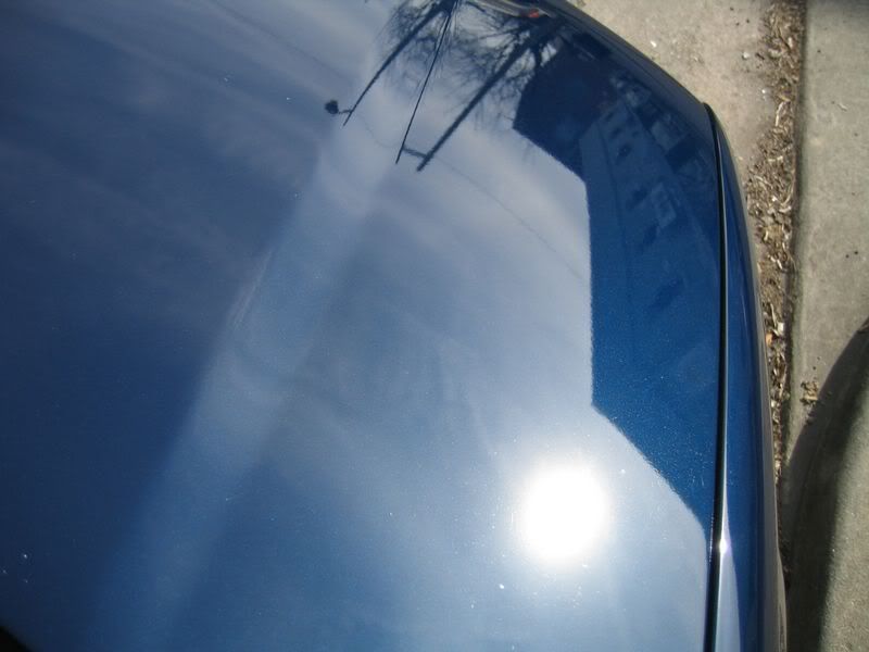

FK1 wash
TOL clay (wheels too)
IP 1200 rpm to remove swirls with Edge 2000 blue pad (8")
PwC and blue Edge 2000 pad speed 5 PC
FK1 #2180 with blue Edge 2000 pad speed 5 PC
FK1 Pink Wax by hand
Before
After

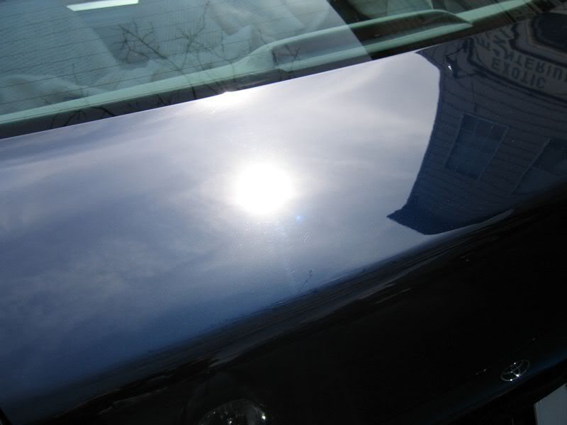

These pictures are a little better but the sun was almost gone and may seem a little to dark
ANOTHER FUZZY ONE :D

It wasn't hard at all, except the vertical areas needed a bit more muscle to control. My first time was really to see what it felt like. On the shady side while detailing I missed some spots that I saw at the supermarket parking lot. No biggy.

You will Scott! :D I know that the hood, trunk and the roof looks swirl free but I do have waterspot issues everywhere.
The other parts of the car was worked on with a cloudy sky so god knows what I did?!:confused: I think I should have changed pads or clean the one I was using before I started on the doors.
In anycase I am very relieved because it isn't that hard to use a rotary. I'll never use my PC to remove swirls/scretches from now on.
I started on the trunk and did one half of it and in about 30 seconds at 1200 rpm there were no more swirls. I will need to get smaller pads though. ( I have these 9" pads!) They are huge!
