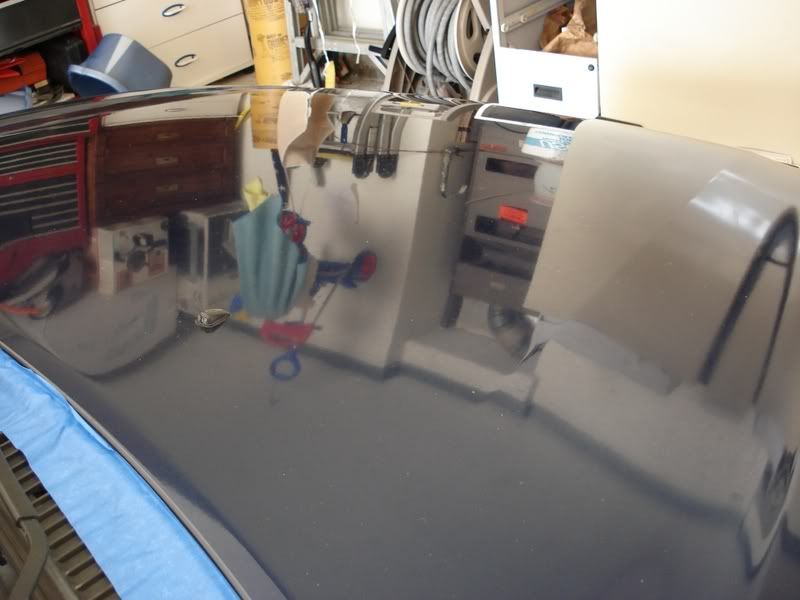

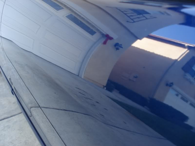

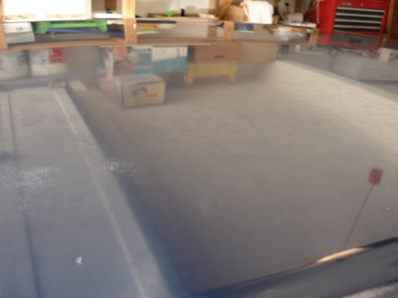

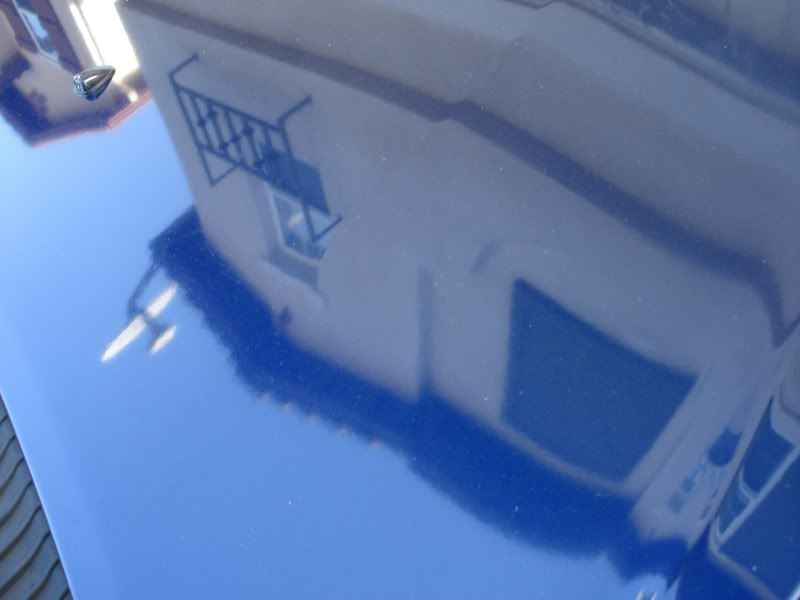

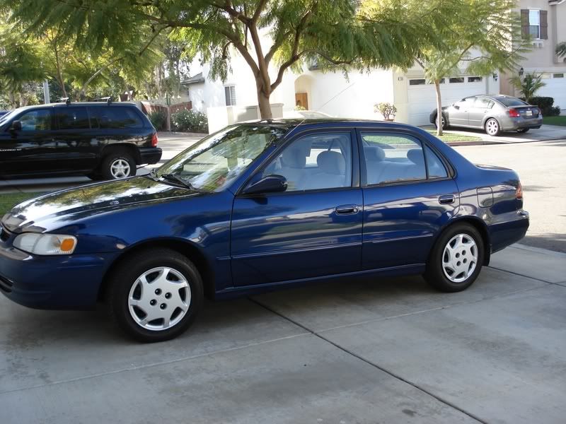

I did this a couple of months ago. Just got my PC and wanted a "practice" car, so I detailed my girlfriend's Corolla. Severe oxidation and paint defects were everywhere. I wasn't expecting any miracles, just improved looks. Here's what I used/did:

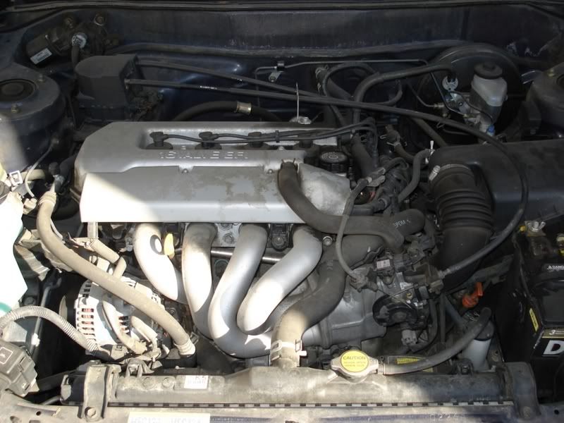

Engine Wash
-Gunk Foaming Degreaser
-P21S Total Body Wash
-CD/2 Engine Detailer
Wash
-ABC Decontamination kit
-Eagle One Car wash
-Clay
Compound polish
-OHC w/ yellow pad
-OC w/ orange pad
-OP w/ white pad
Finishing
-RMG w/ grey pad
-JW Prime w/ grey pad
-JW AJ by hand
Headlights
-Meg's Plastx w/ yellow pad
-Plexus plastic polish
The initial wash, this car would not bead at all. The water would just sheet on and it was nearly impossible to dry. Now it beads and its a lot easier to wash.
Before:
After:

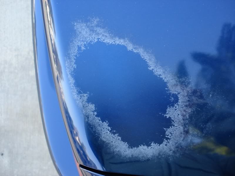

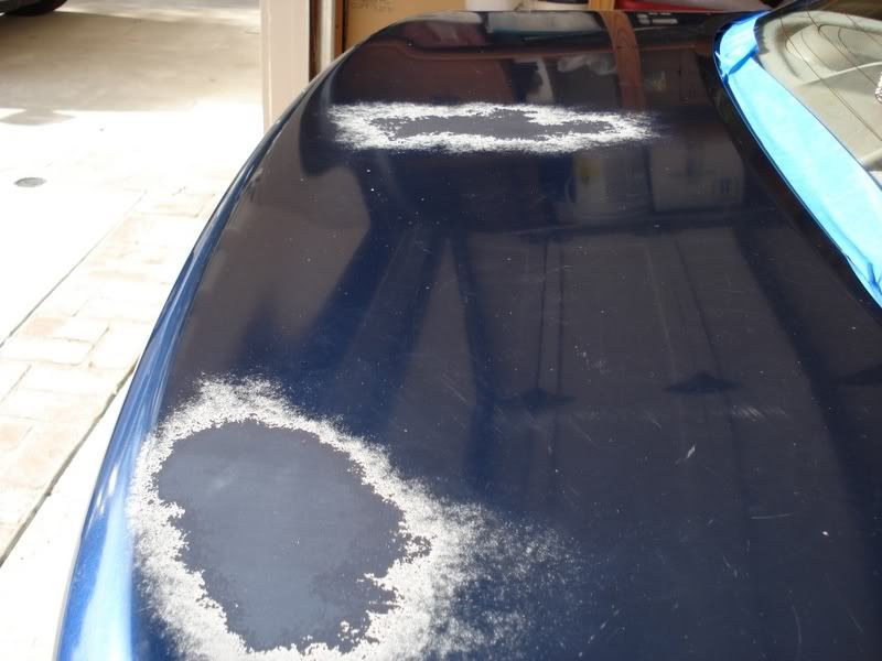

Definitely better, the sides look great! Too bad about the clearcoat failure though, there is no detailing solution for that.
Great results!!!
Shame about the CC, but what can you do?
Do you think the RMG was needed as the prime might have removed it anyway?
Thanks for the compliments. Yes, this little endeavor took me 4 days to complete.
Someone else suggested that I skip the RMG as Prime was going to remove it. But I had already ordered the product so I thought I might as well use it anyways.
