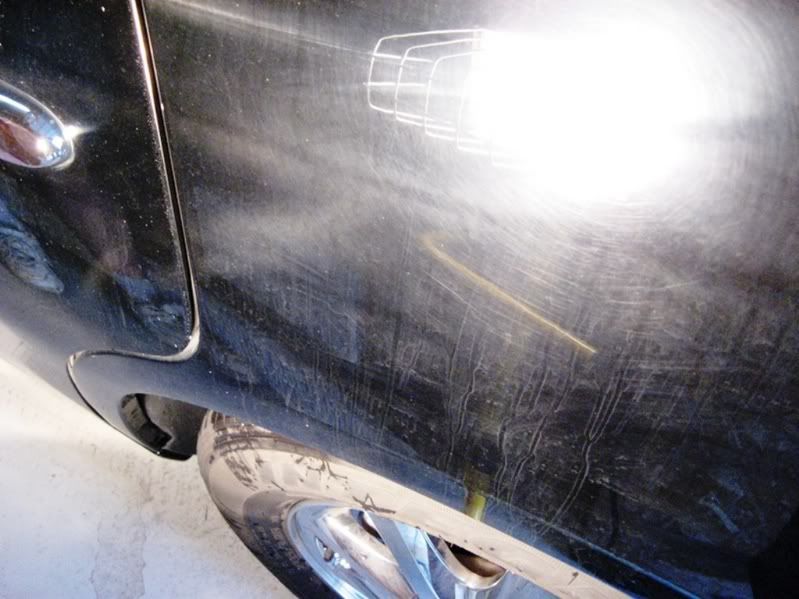

2005 Buick CXT.
This car sits outside 24 x 7, and was in the body shop this past October for a fender-bender fix-up.
The kind folks at the shop absolutely hammered the paint via an inexperienced rotary operator, then filled it with some glaze to make her ‘good as new’ looking.
The paint looked nice initially, but after some exposure to weather (i.e winter), the true condition of the paint reared its ugly head.
Here are a few before shots taken after a wash & clay.
The paint was air dried.
I only wiped down the jams (to remove any dirt/debris before polishing):
To correct the paint, I used 1 polish product, 3 Lake Country Pads, and a rotary.
This one took some time to correct, but the results were pretty nice in my eyes.
Here’s my process:
Wash: Car wash x 2 the recommend dose and a wheel cleaner for the tires,
wheels, and wells.
Clay Bar (2 full bars on this one to deal with tar, over-spray, build up on the wheels, etc..)
Polish:
Rotary @ 1800 via synthetic wool
Rotary @ 1500 via light-cut pad
Rotary @ 1200 via finishing pad
Protect:
The paint was topped with 2 coats of sealer.
I’m not submitting this to win a contest. The reason that I’m submitting this is to show you guys that it’s more about process than it is about getting into product wars.
At the end of the day, if you find a combo that works well for you,
stick with it, and teach others how you do it.
Here are a few after shots:

Since you used a rotary and evidently still made three passes to clean up the marring, I had a question.
Do you think that given enough time, the vehicle could have been cleaned up with a PC?
While I have had good luck using the PC for minor correction, I doubt that the damage you had to work with was something I would want to tackle with the PC.
Charles
That is definitely some very good work. I sure wouldn't want to tackle that with a PC. I don't even want to think how long I'd be polishing to try and remove all of that damage.
Those before pictures are NASTY (esp. #3), I've never seen a car look like that out of a body shop, that's pretty sad. But you did a helluva job transforming the finish to a "like-new" state :bigups

Charles, Thank You.
How have you been?
Taking good care of the folks on DC I'm sure:bigups
I've had good luck using the PC to correct defects. You need to use a more abrasive product & pad combo to 'cut', which is effective. The hard part on the PC is to clean up after abrading the surface. Producing a marr free finish (that looks great under full sun) takes time and patients.
I had to step into this one pretty hard on the rotary. I honestly don't know if the PC would have produced the same results.

Did someone complain to the body shop that created that mess? That was just horrible and shows you that a rotary in the wrong hands can be devastating.

The speeds posted worked for me on this detail, but I would not call them 'go to' dial settings.
It all depends on the condition of the finish. As a rule of thumb, I try to keep the RPM's as low as possible, and don't mind if I have to take a few passes at a panel.
