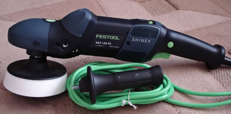

I thought it about time to do a review on this. The New Festoon Shinex Rotary.
I recently purchased one a few months ago now and have been putting it though its passes. The main reason for this purchase was two fold.
One the Branding. Festoon are renowned as a major player within the power tool market. Offering great build quality and fantastic after sales service if needed.
Two. The weight of the machine. Only 2.1Kgs total weigh. Great ergonomic design and the soft gel like coating. Which aid grip and feels nice in your hands.
On the negative front its not the cheapest machine. By an means. Coming in around £368.00.
This Rotary was designed and built with one purpose in mind. Same as the Flex 3401 Polishing. So my expectations where high. Difference being the Flex has a forced orbital rotation.

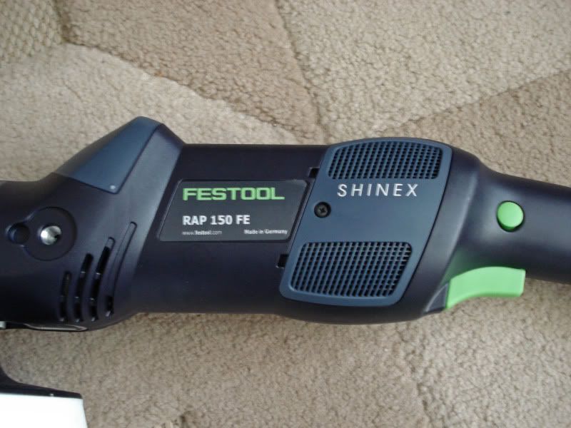

First impression of the machine that you will notice is the way it fits very well into your hands. The soft gel like covering even if your hands are sweaty or wet seams to aid grip and feels so natural. Next thing is the weight you almost forget its is there. So light and easy to control. User and machine as one.
All the curves and contours of the machine have been thought out also. The main handle with the trigger. Has a nice down wards slope to it, not large and bulky. Aiding your wrist to feel comfortable and your hand to wrap around nicely.
The raised section just behind the head again designed to support your wrist while you hand wraps nicely around the head of the machine. It also doubles up a support when the machine is laid down on its back.
Trigger and locking button can easily be reached with fingers and thumb, as so can the speed control. Which is located just at the top of the machine. Again visually there and within reach with your thumb, if needed.
Cabling although rather loud and roary as in colour is a nice length being 6 m long. So again something that is normally over look had been considered.
Maintenance of the machine is basically none existent. There are two vents located at the side of the machine. Which Festoon recommend you remove and clear with an air line. As these are responsible for the built in cooling system.
