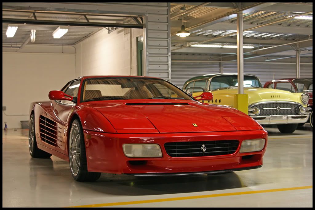

Just a preview.
Did another with Sean today. More to follow.

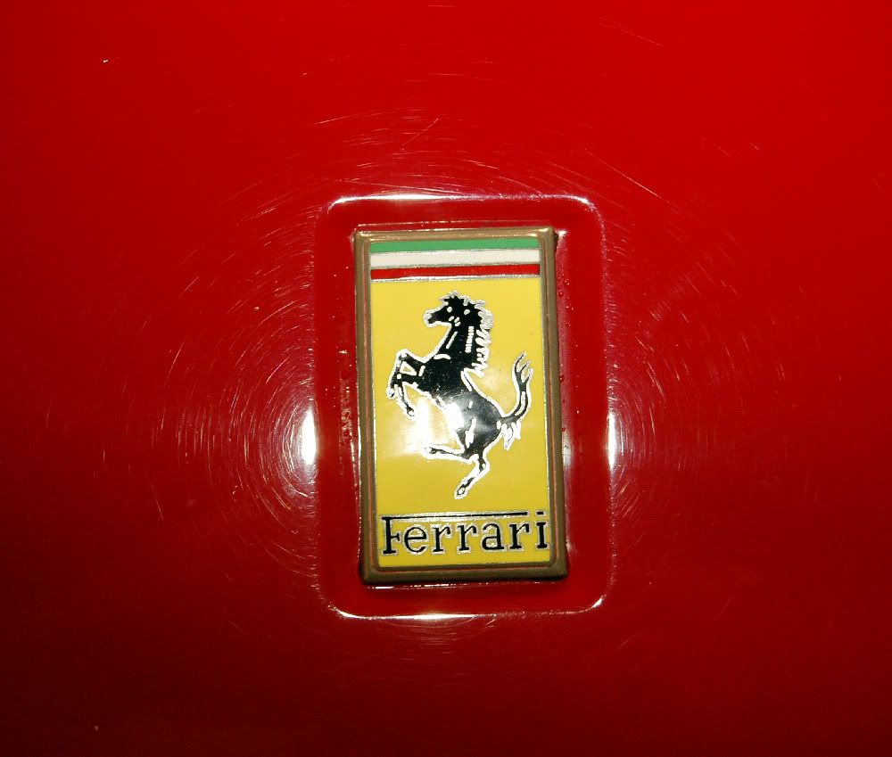

efore

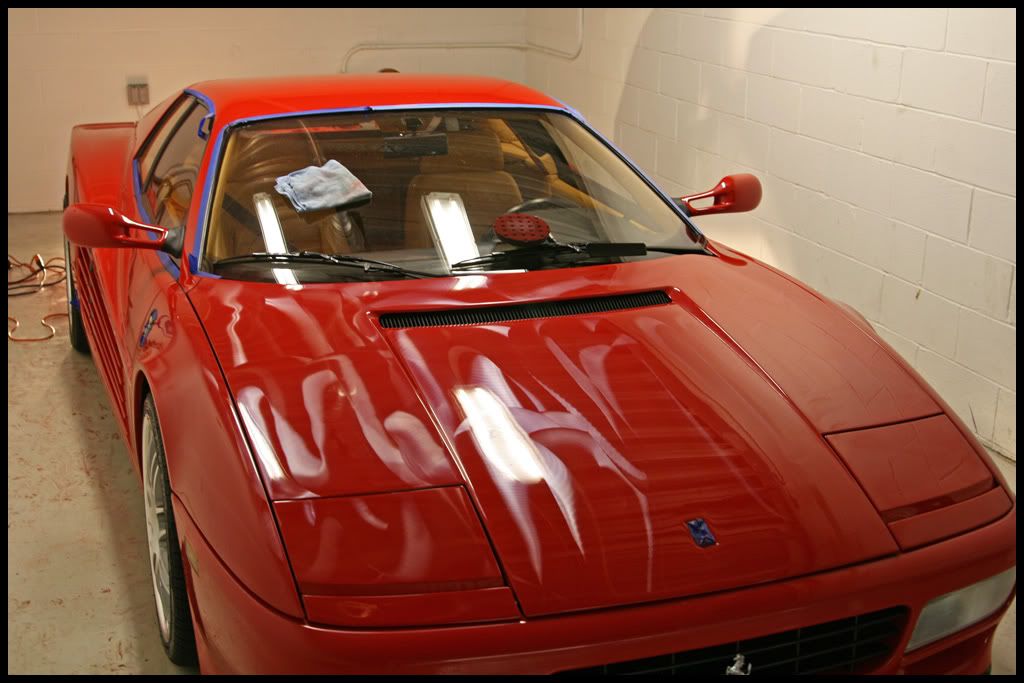

After

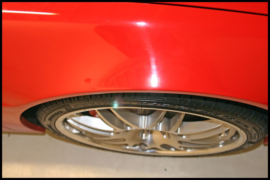

50/50

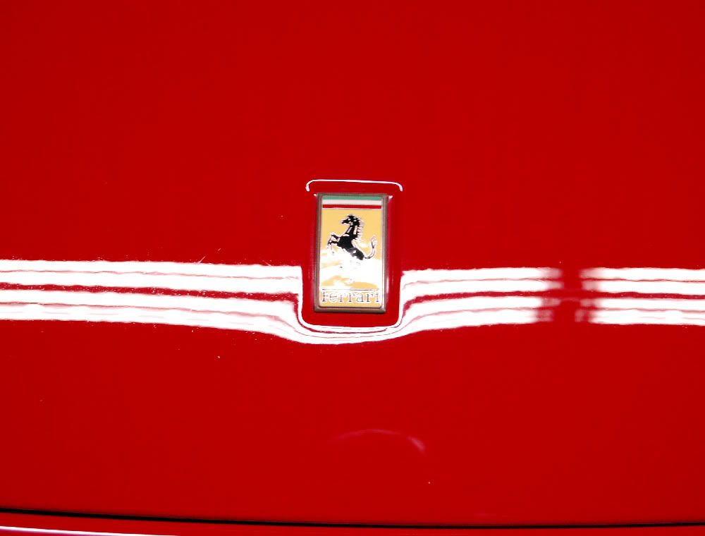

Polishing with PO85RD

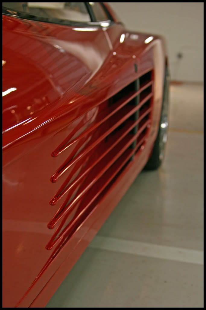

Couple of awesome ones...
why did you use different lighting for each pic? before looks to be with flash...after looks to be jsut an overhead light. cant really tell 100% the correction done without a consistent halogen lighting or camera flash!
it does look to be a huge difference tho....just saying you are taking away from it without 100% revealing the paint condition in the after pic!

We had only 6 hours, so just the exterior and engine could be done today. I'll pass by after work one night this week for the interior.
We hit it with Meguiars M105 (original diminishing formula) then Menzerna 85 via Makita rotary.
No clay was needed.
Washing was minimal.
Factory wheels are going back on tomorrow.

When I think of a Ferrari, this is the one that pops into mind... nice work, Justin! I've got a 348 coming one of these days with similar PITA side flares :doh Can't really do a whole lot with those though...
Thanks Jesse. Hand polishing only! This owner has a 355 also - 348 doors with no cheese graters..
