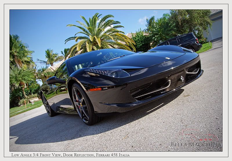

Here is an in progress shot taken of the 458 Italia prior to the end of day three. A lot of time was spent double and triple checking the progress and results. If there had been enough factory paint thickness to completely sand the body completely flat, this job would have been easier. As such the goal was to get as close to perfect as possible, which meant giving it a consistent and uniform finish everywhere. Over sanding and over flattening a small amount too much would have meant re-sanding the entire surface flatter as well to ensure total uniformity.
The remaining pictures are after shots, taken both in direct sunlight and in the shade close to the house. Thank you for reading.

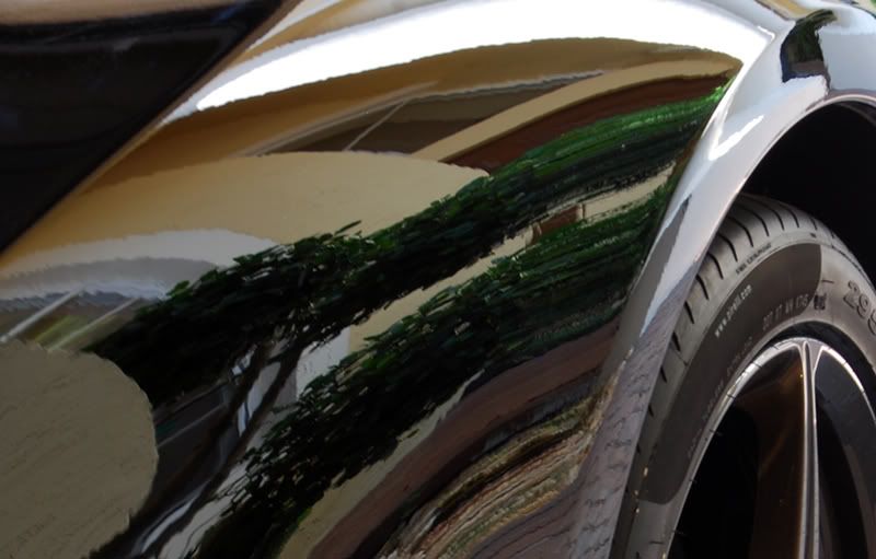

Do you have any close up, similarly high-rez after pictures of the top 2 fender shots in the last post?
Regarding the first picture on the top of page two, there is a good before and after of it (that is very easy to see in the full sized thread. Unfortunately it is hard to see on this version because of the pic size limit).
Here is the closest thing I have to an after pic of the second fender in high res. Again a lot of the detail in the pics is lost because of the size limit of this forum :(
