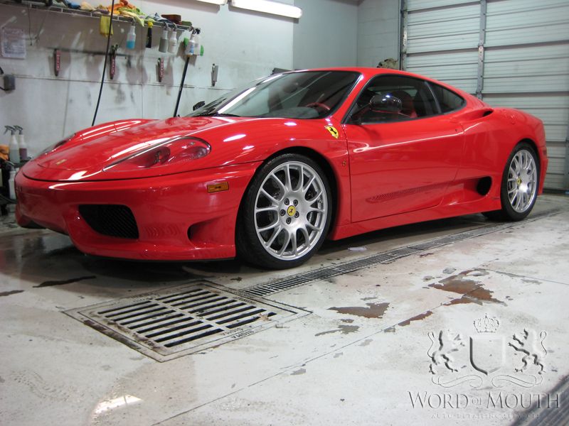

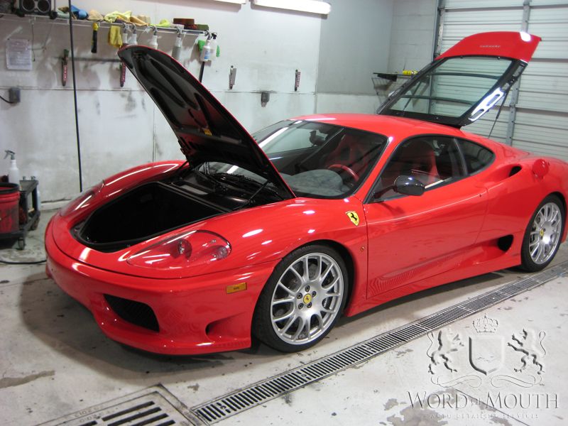

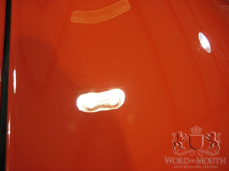

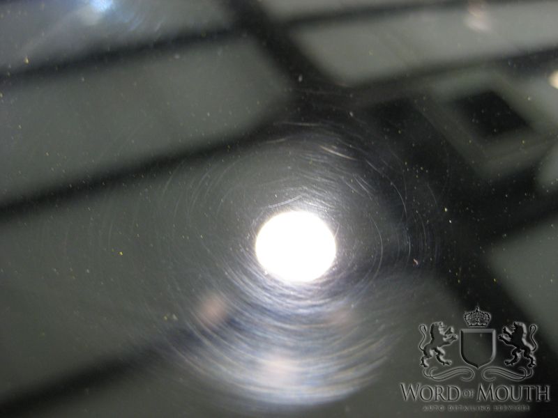

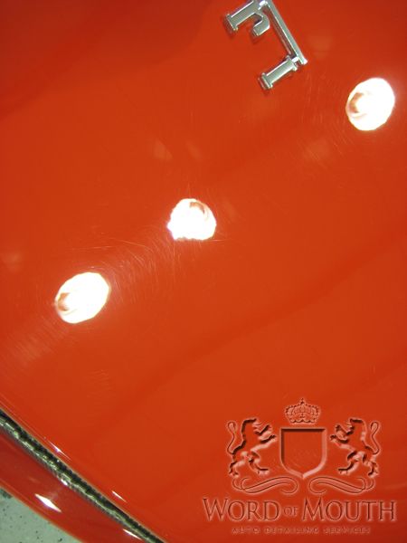

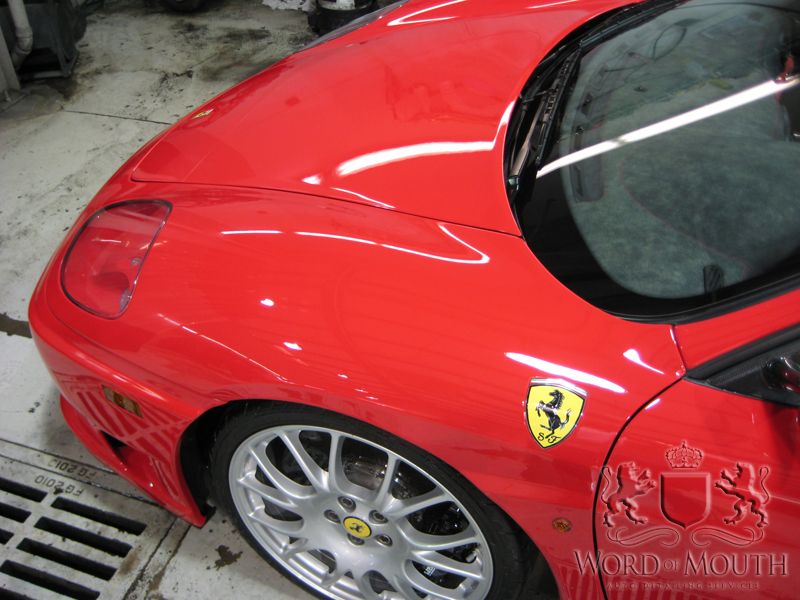

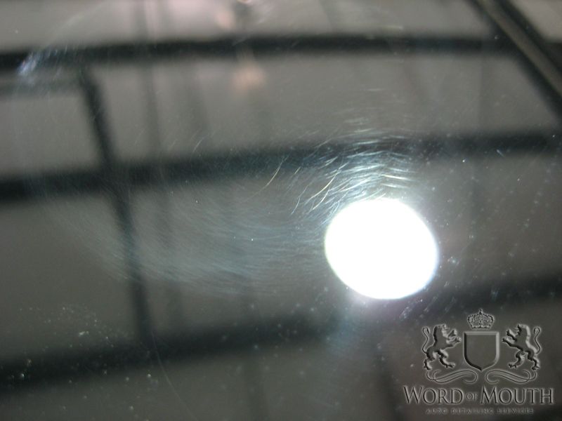

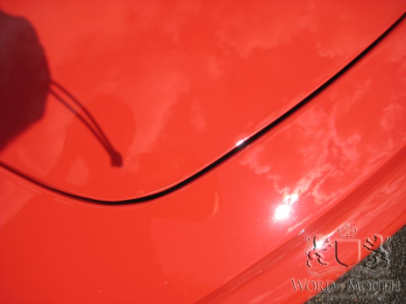

First up was this Ferrari 360—she needed pretty extensive correction. The main issue aside from normal marring was very deep RIDS. Of course the paint was soft and we made fairly quick work of the job…
Here she is in the wash bay…

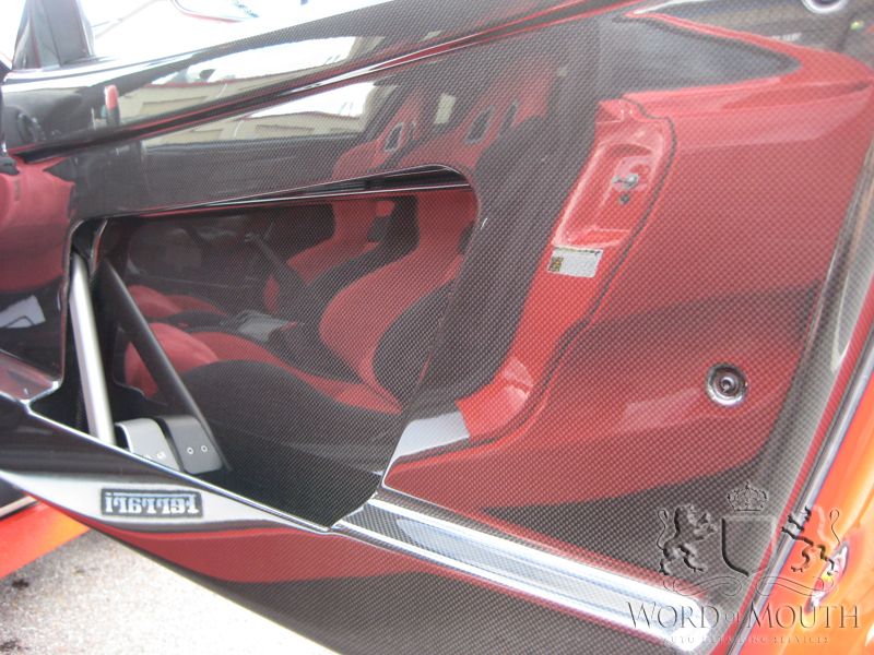

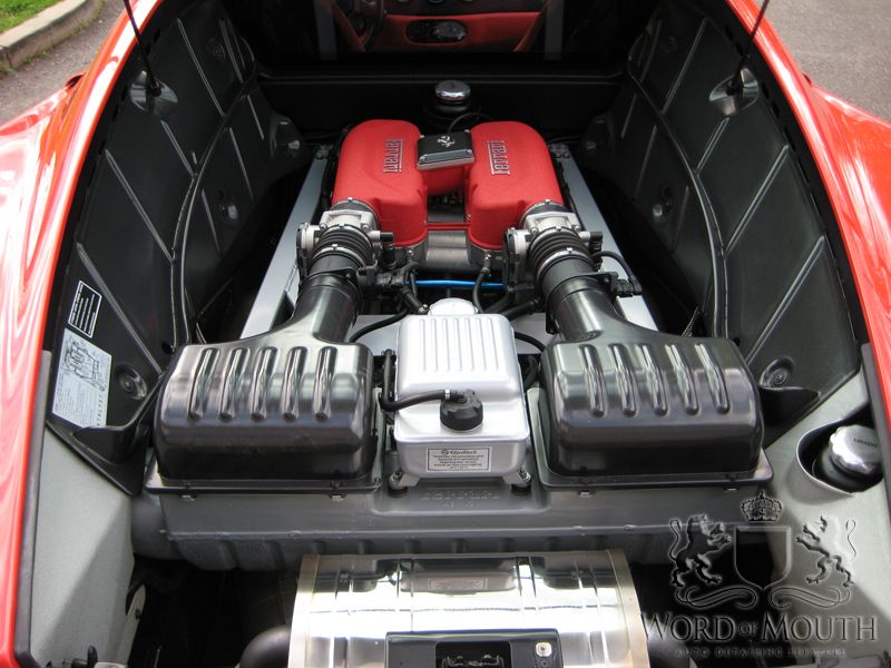

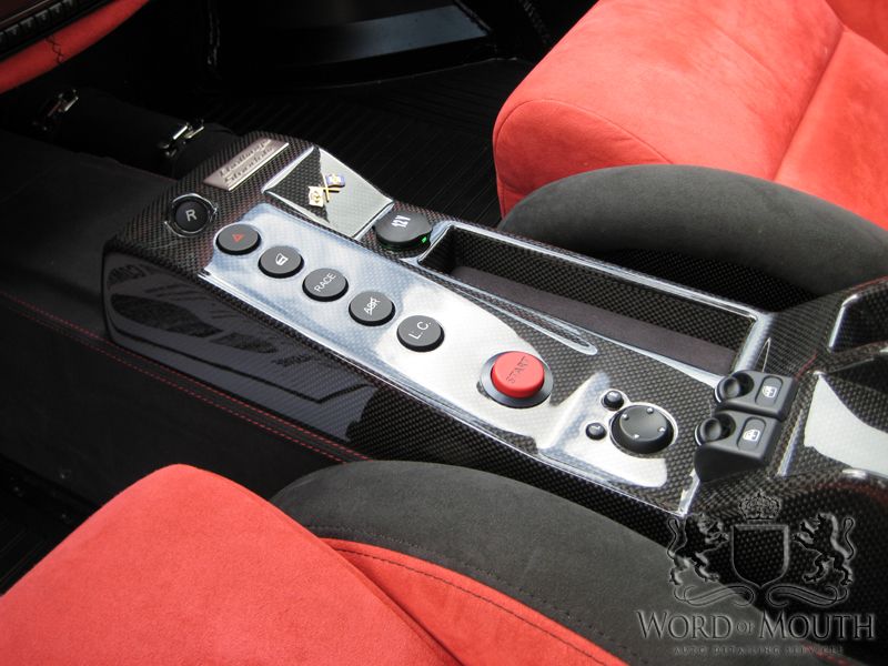

Carbon fiber will of course need to be polished..

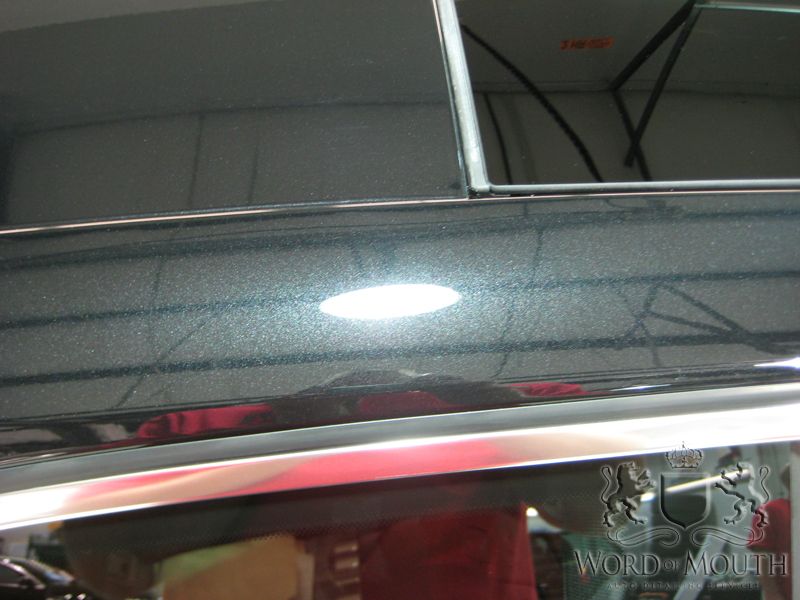

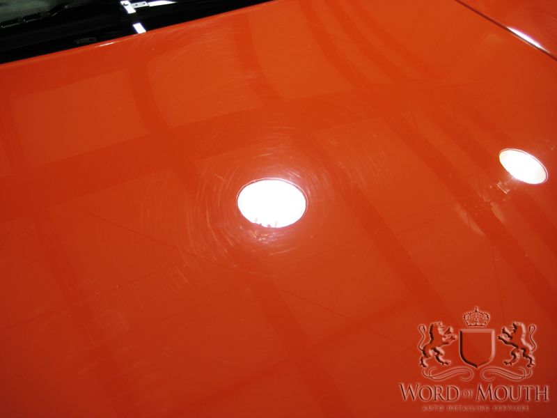

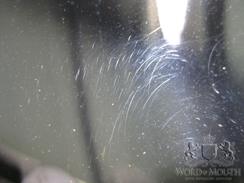

A few shots of the marring/RIDS

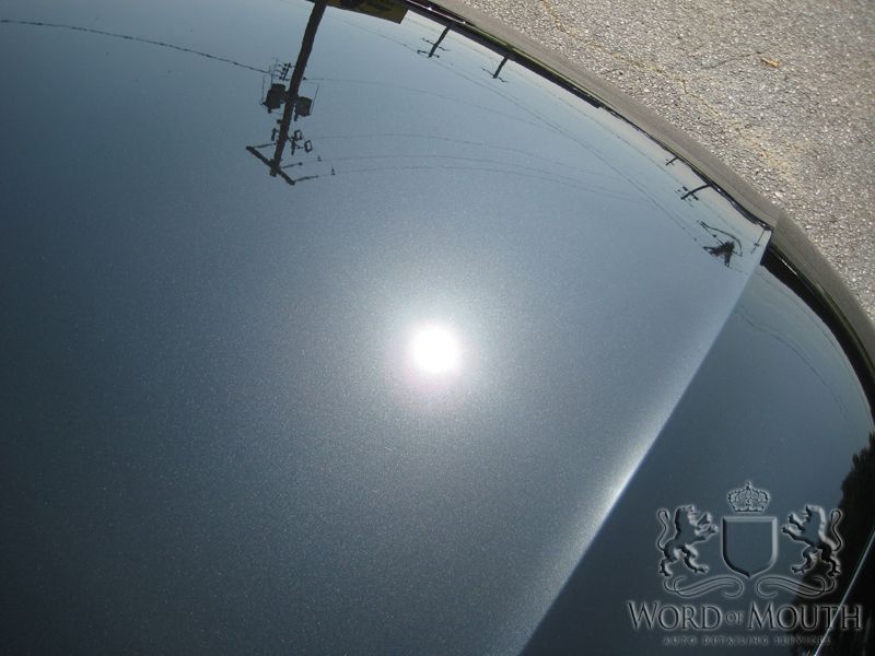

After a bit of polishing:
Almost ready for outside examination:

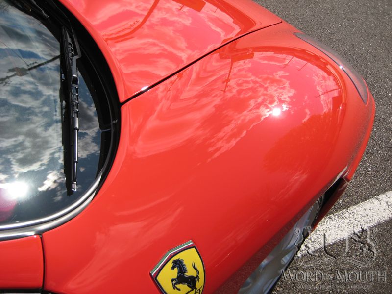

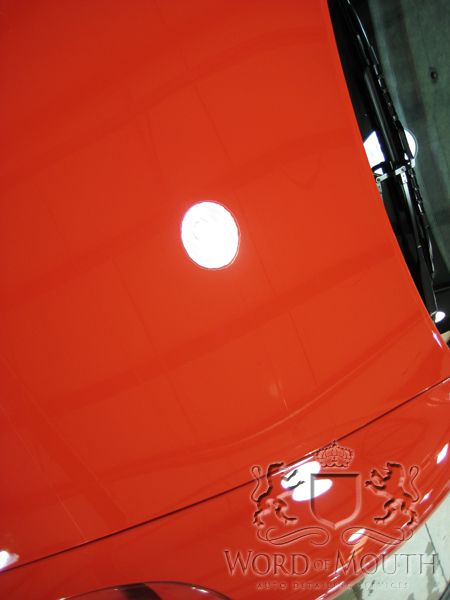

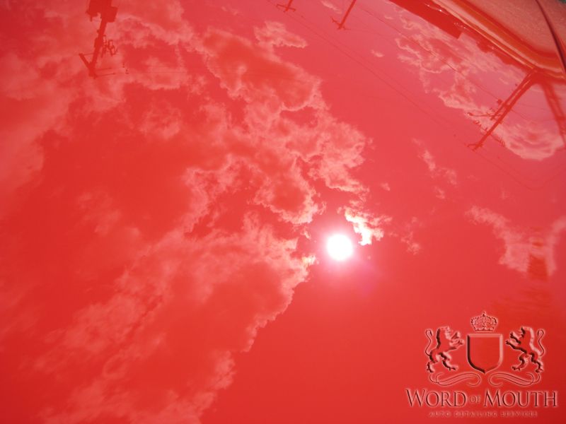

All polished—M205 via a spot pad on PC and then sealed with opti seal
After a bit of wool M105, M105 red pad, M205 white pad, UPP..
Again, almost ready for examination outside..
Ahh, much better!

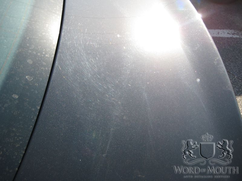

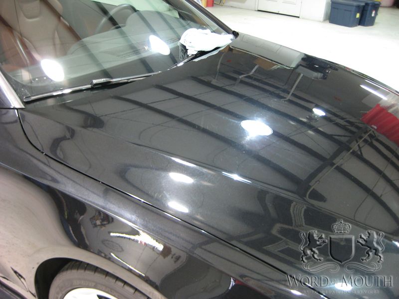

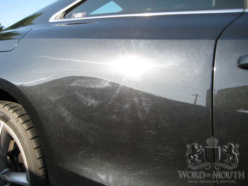

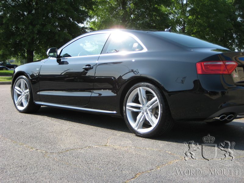

This one I don’t have proper before and afters, but it was a fun car to work on—some of you might enjoy.

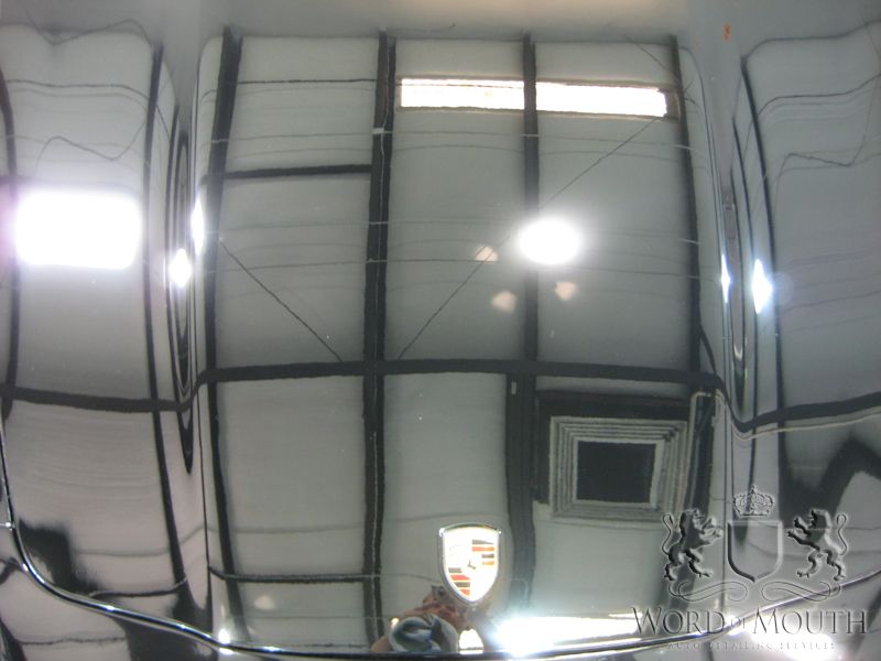

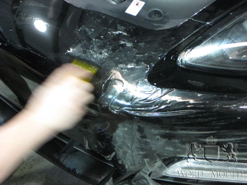

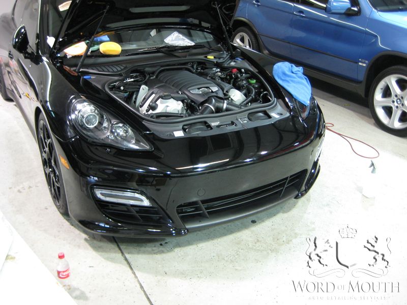

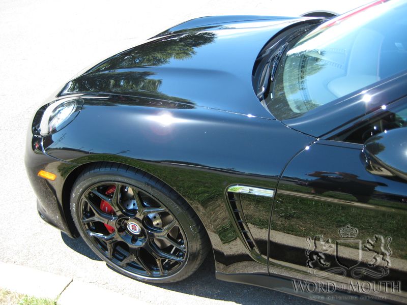

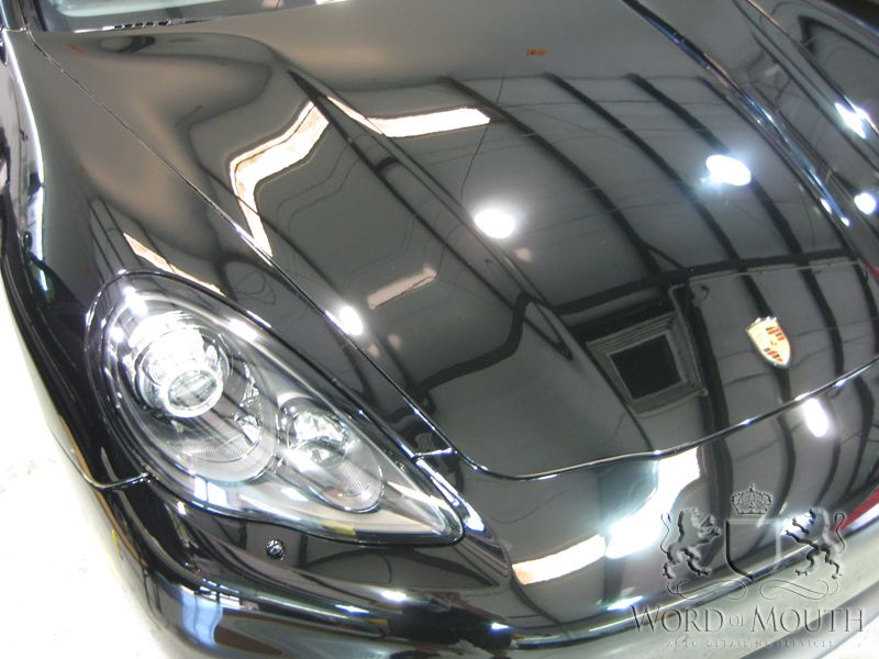

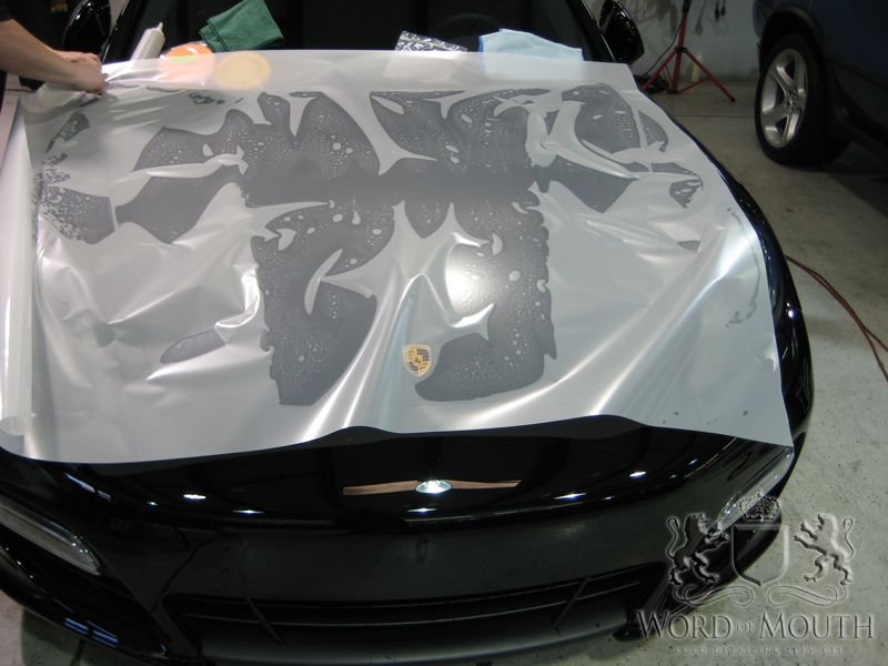

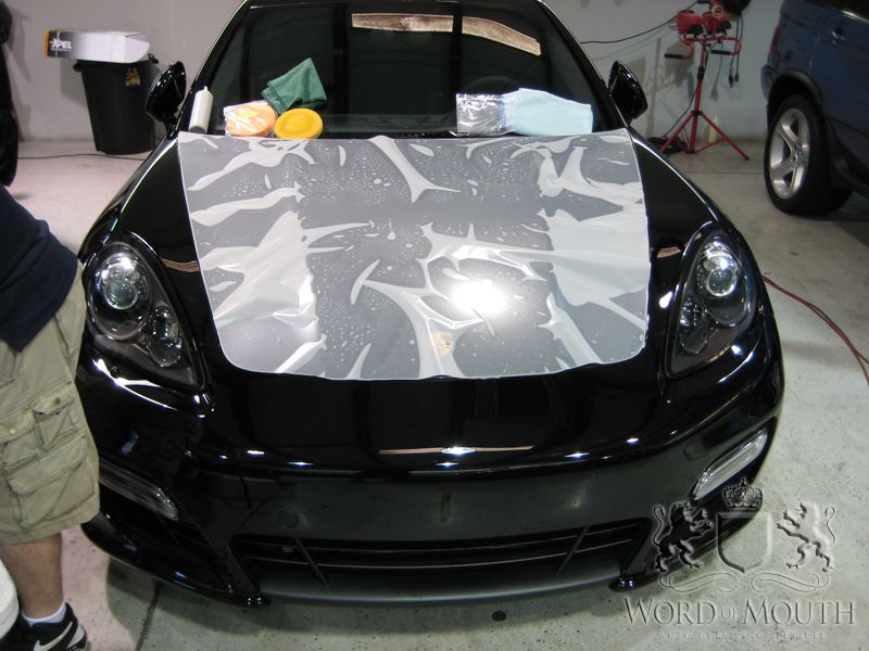

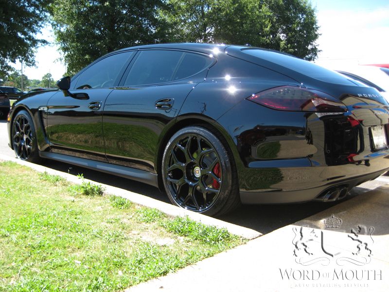

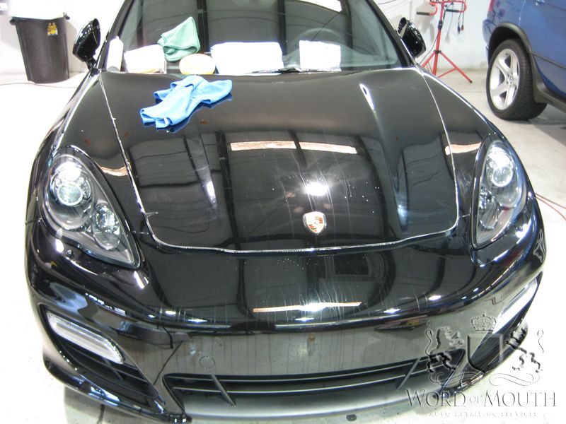

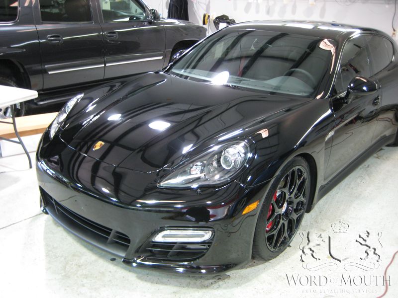

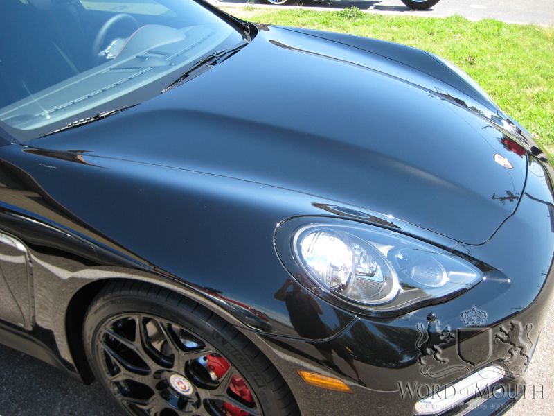

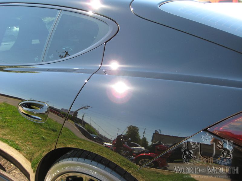

This is a Panamera GTS that has been mildly modified. We were contacted to correct the paint and install ppf to the entire front cap. We used the new Xpel film with the supernanoceramicnonceramicselfhealingbestthingeveruntilwedebutnewfilmatsema coating. :D We have been installing the film a little over a year now and really like it.

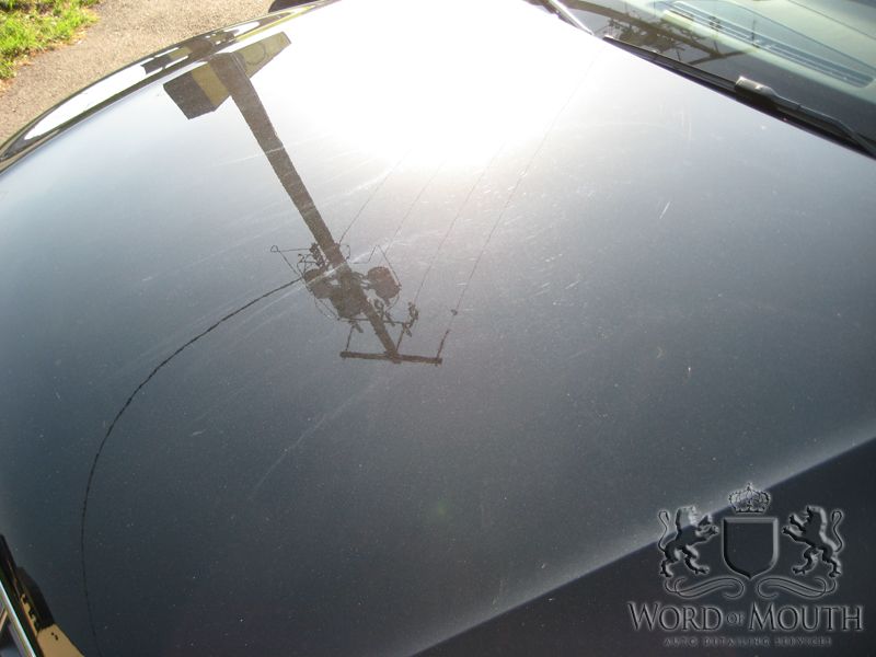

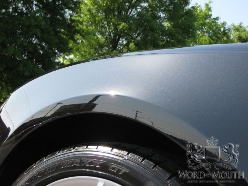

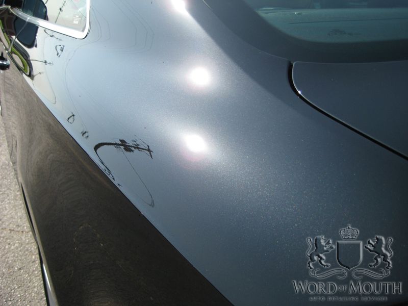

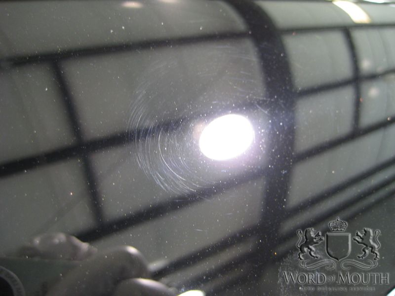

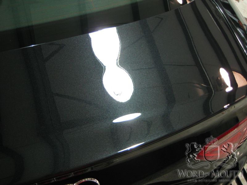

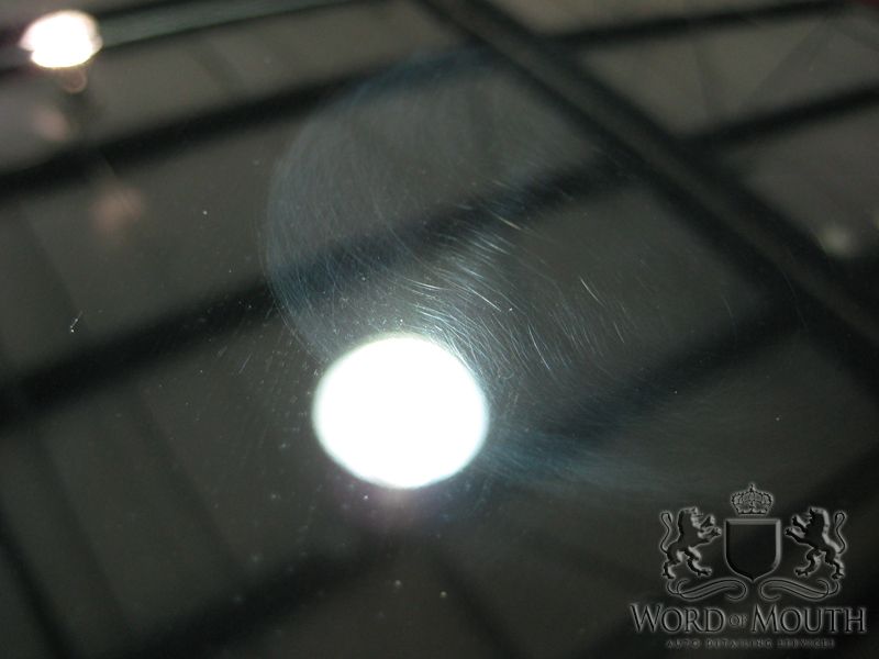

Random marring, leftover sanding marks, etc..

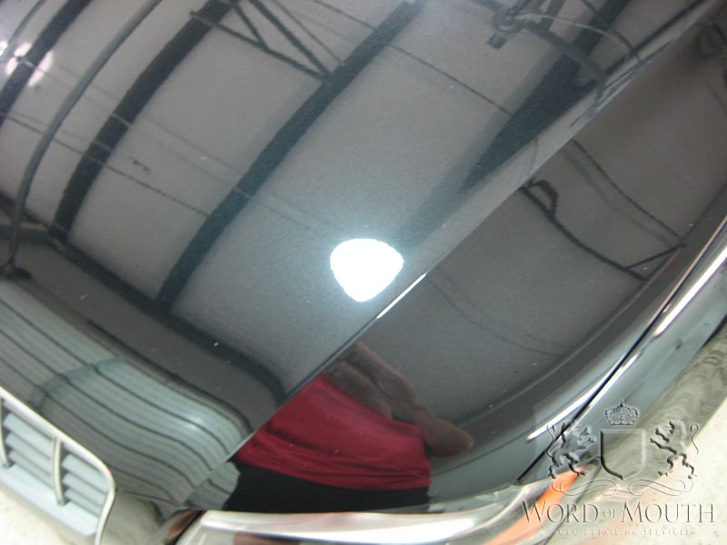

We use a little of everything--a lot of flex, but when you need a rotary, you need a rotary. Most of the time if we are using the rotary we are using twisted wool/M105. Most days we aren't full correction jobs, just "general public polishing" so the flex is the tool of choice for that.

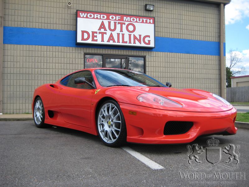

Great work, really enjoyed taking a look. That Audi looked really rough but glad to see you were able to do it justice. What year Ferrari?
On the PPF install on the Porsche why not take off the emblem on the hood instead of wrapping over it and cutting/trimming around it? I think it is just two 8mm nuts on the backside, very easy to access.
Looking forward to seeing more from you.
Are you sure you spelled that right? :D
