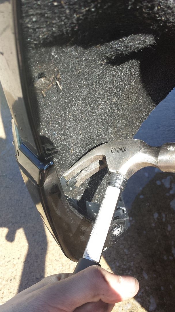

Carpet on the outside? Never seen that... Any pictures? I've tried Googleing it but only found pictures of carpet in the trunk above the fender wells.
Not my picture but here's what it is.
I have these on my car in the fenders as well as underneath the engine as a cover.
I really don't know if I could live with those...don't they wear badly over time? Between all the [stuff] that'll happen in normal use, and the apparently aggressive measures required to clean them, they look like "deterioration over time" waiting to happen.
