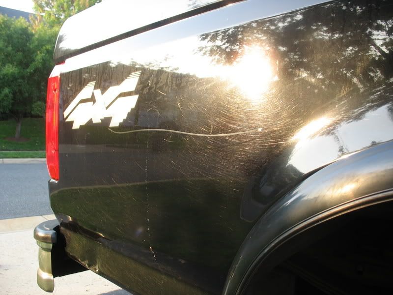

Working on a black Ford F150, 11 years old, has spent most of its life unwaxed and sitting under trees. It has leaf outlines etched into the paint along with very heavy pits from stuff just sitting on the paint for months at a time.
I was thinking Meguiars heavy cut cleaner with a wool pad, then fine cut cleaner with a wool pad (maybe #83 dual action cleaner polish instead), and then IP/FP or Z-PC Fusion. The owner doesn't need perfect, just black and fairly shiny. I will probably finish with #26 Tech wax so I can buff it on, I hear its good on black.
Anyone have any comments on this plan of attack?
I did a test with a yellow CCS foam pad and fine cut cleaner and it made the paint black but it wasn't strong enough for the etchings (nothing might be strong enough for that I'm afraid.)

Some of the pits (and leaf outlines) are deep enough that you can feel the edges with your fingernails. I imagine those leaves sat on the truck for a year or more, I know they will stain concrete and they sure did a number on this paint!

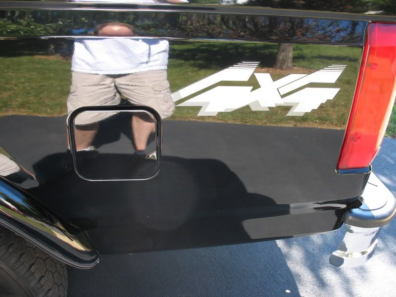

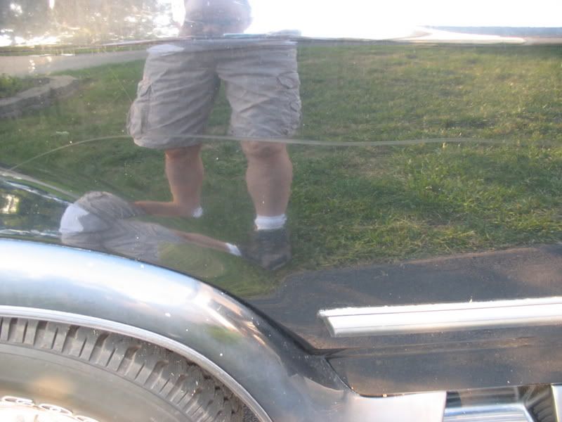

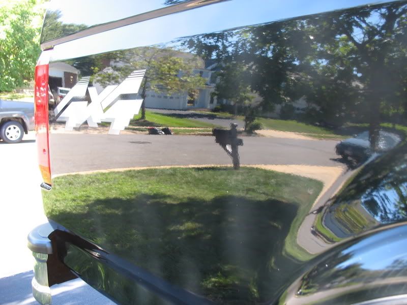

Well, the truck came out fantastic, the owner is thrilled! The hood and roof are still etched, although not nearly as bad, they are just too deep to fix, but at least the paint is black and the rest of the truck looks amazing.

Thanks, it was a lot of work but actually fairly enjoyable because of how far it came.
I used:
Clay
Heavy cut cleaner with wool pad
#83 with wool pad
IP with white pad
FP with gray pad (DA)
Z-PC with gray pad (DA)
Z-AIO with gray pad
Z-8
