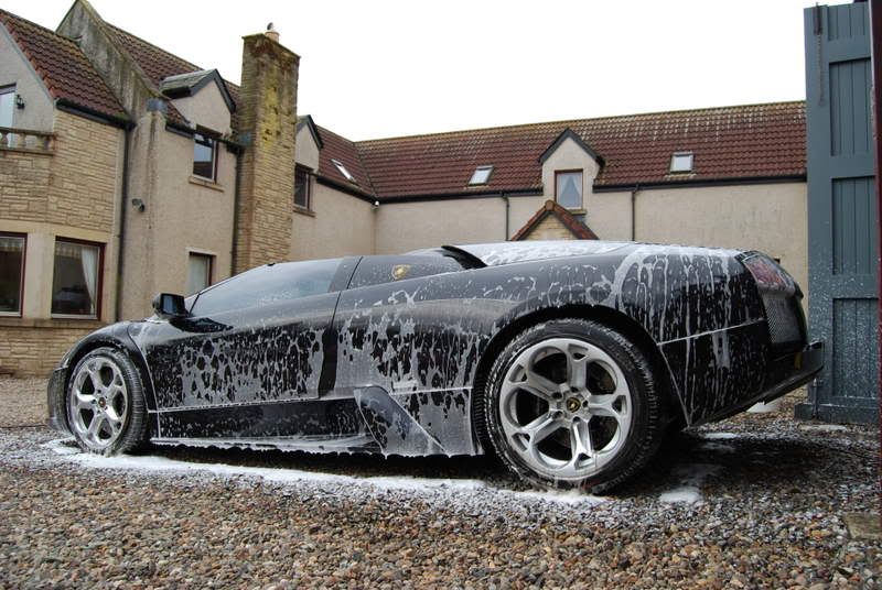

so first off was to pre soak with the AS citrus then my own foam and left for 5 mins
then clean the wheels using the EZ brush as i think this one would be the only one that can behind the calipers :thumb: and a meg`s microfibre wash mitt
these are so lush :lol:
so then off to rinse the citrus and foam off. once the raging bull was rinsed it was time to wash with 2 buckets and wash mitt, i find with using the citrus and foam before the 2 bucket`s give`s me a clean rinse bucket after washing the car :thumb:

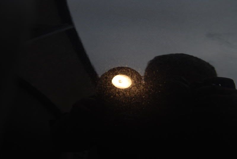

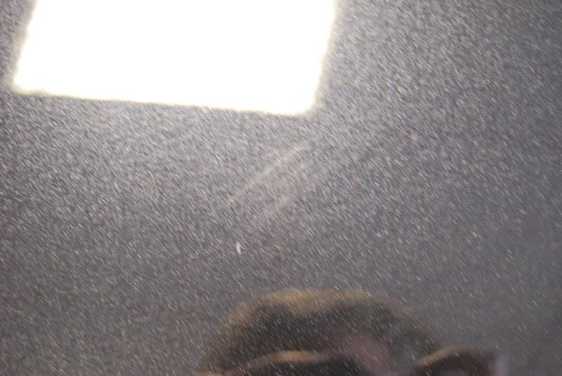

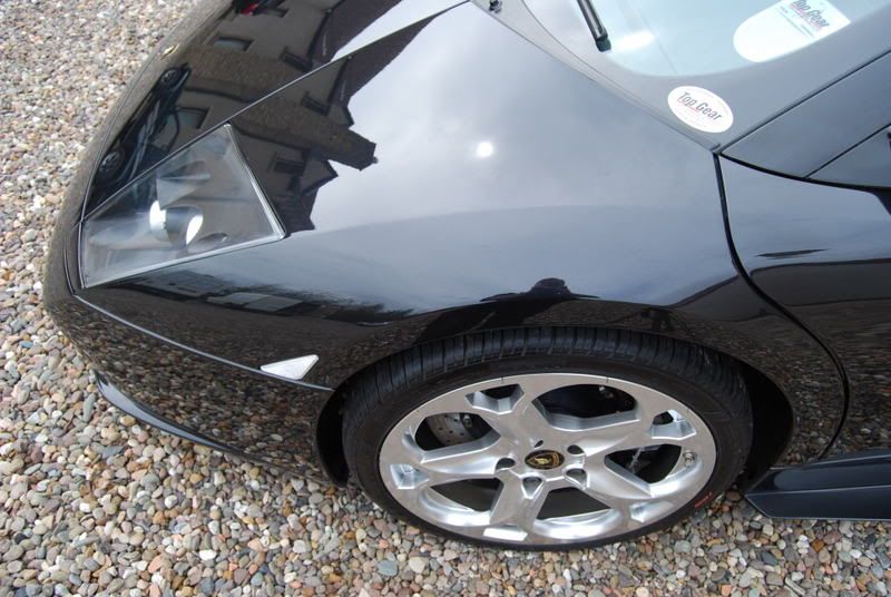

paint was not to bad just a few marks and some light swirls

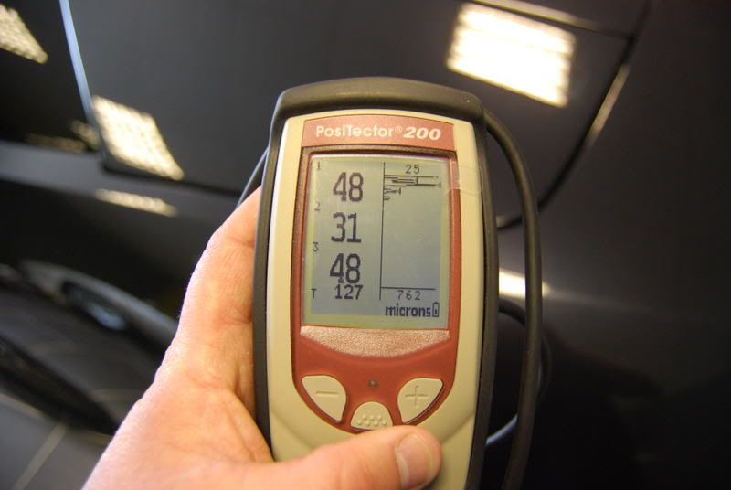

so before and corection work is started all pannels are checked for thickness in paint
also my gauge is tested before hand:thumb:

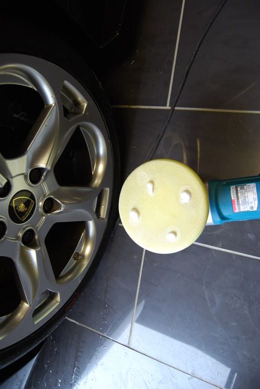

so out with the makita with the meg`s polishing pad and some menz IP
then a finishing pad with menz FF
