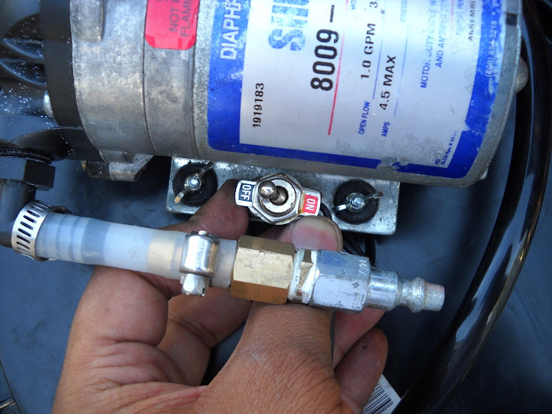

I started with this pump. SHURflo OnDemand Diaphragm Pump — 1 GPM, 60 PSI, 12 Volt | Sprayer Pumps | Northern Tool + Equipment It's on-demand so it won't burn up by constantly running, self-priming and dry startable. I then wired it to a 12v plug and added an On/OFF switch. I haven't mounted the switch yet, but you can see where it will go.

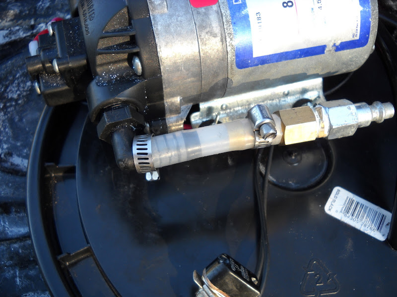

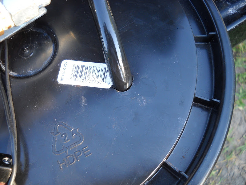

I mounted the pump directly to the lid of the 5 gallon solution bucket and drilled a hole to run the pickup tube through.
The pump comes with 3/8" hose barbs, but I wanted something easy to set up and break down. I used a very short length of hose to convert it to a standard air hose quick-connect.

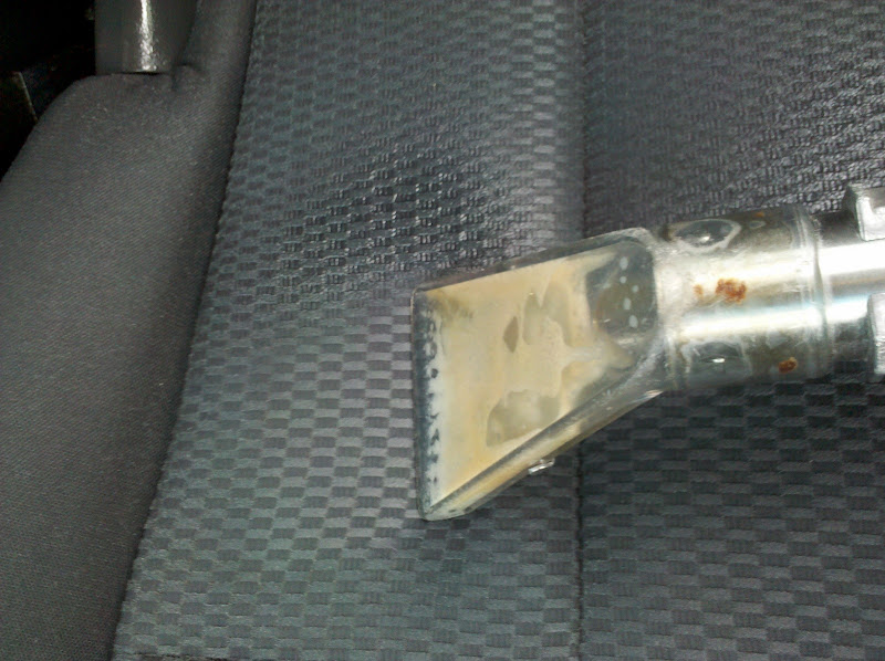

Then I used this standard extractor wand. Hand/Upholstery Tool Economy Detailer 3 1/2 Inch I cut off the standard quick-connect and replaced it with and air hose quick-connect. The tool fits into a standard 1.25" hose. I wrapped it with a bit of tape to make it more air-tight and less likely to slip out.

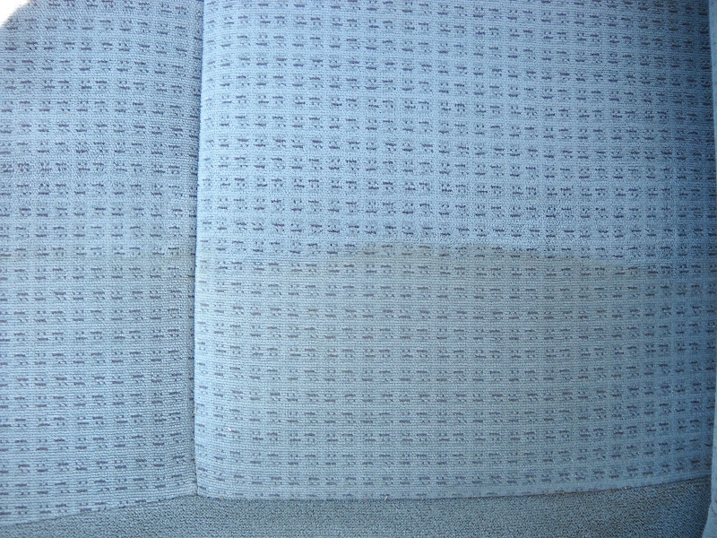

Here are some pics of it in action and results

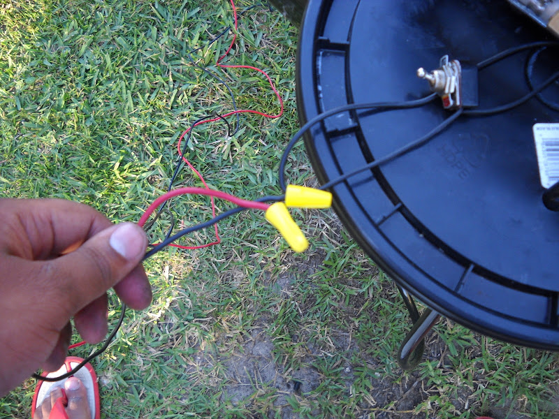

Just got the bucket heater. Works really well. I am figuring out the best way to mount and wire everything. Pictures coming soon. Still looking for a good thermometer. The one mentioned above maxes out at 158 degrees F. The heater is supposed to get the water a good bit hotter than that. Any ideas would be appreciated.
