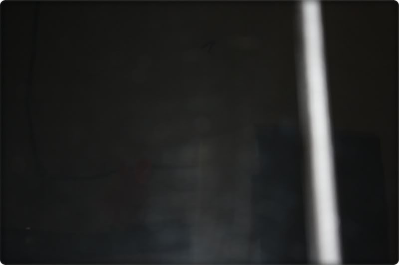

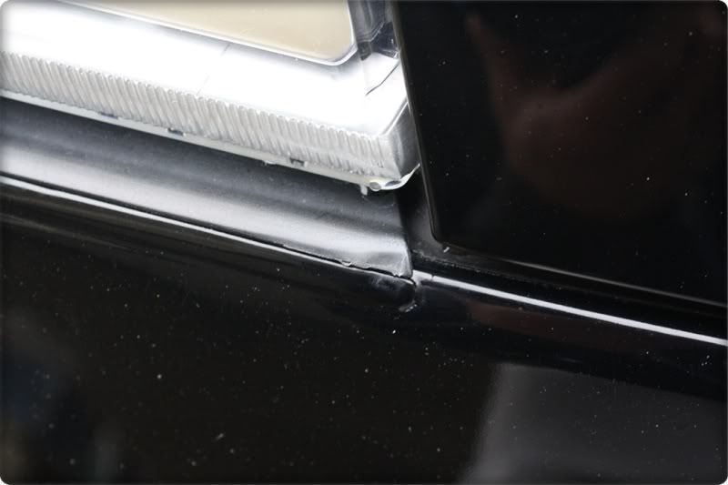

Upon arrival, a few things I noticed: hazy paint, TONS of swirl marks, a few paint blemishes that need repainting, burned trim, and holograms.

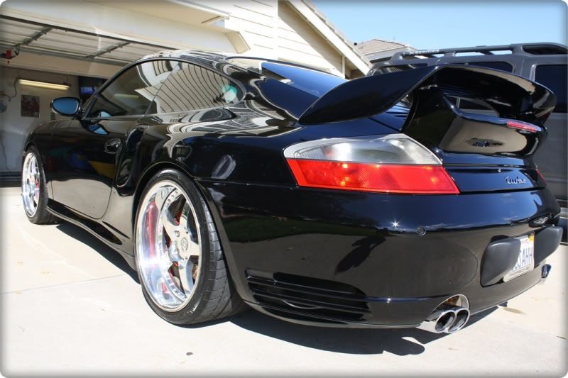

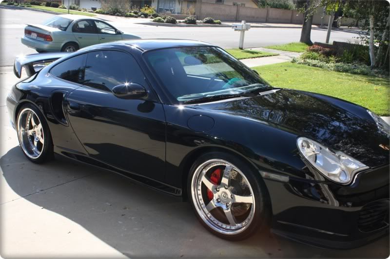

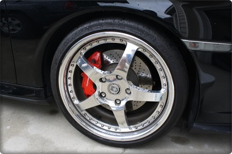

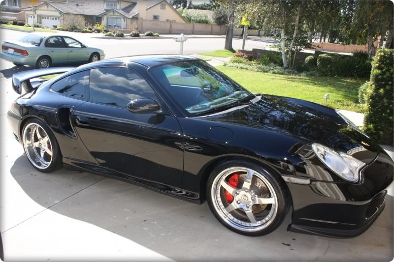

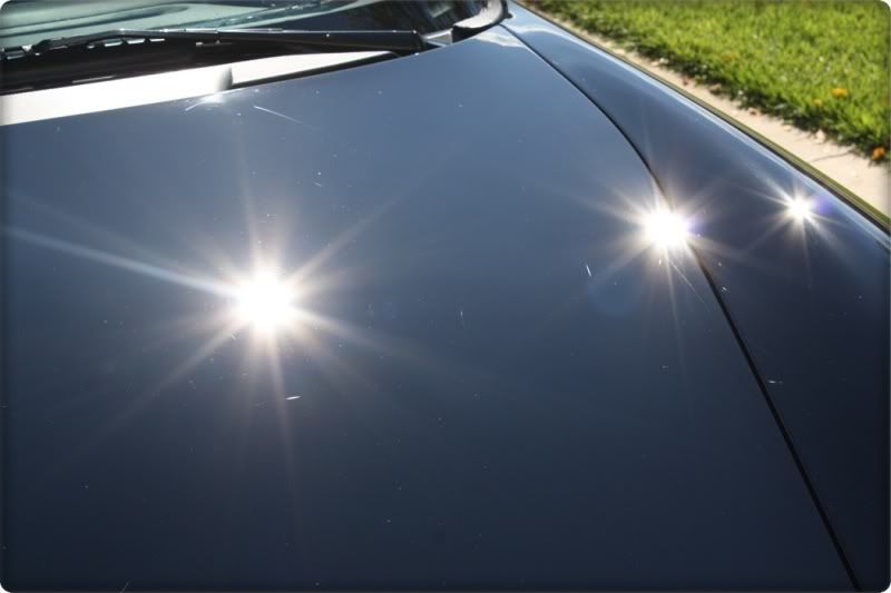

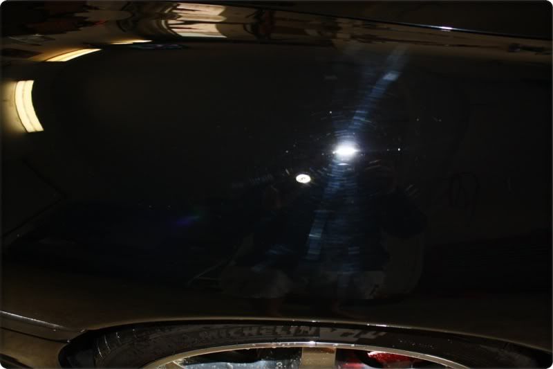

Befores:

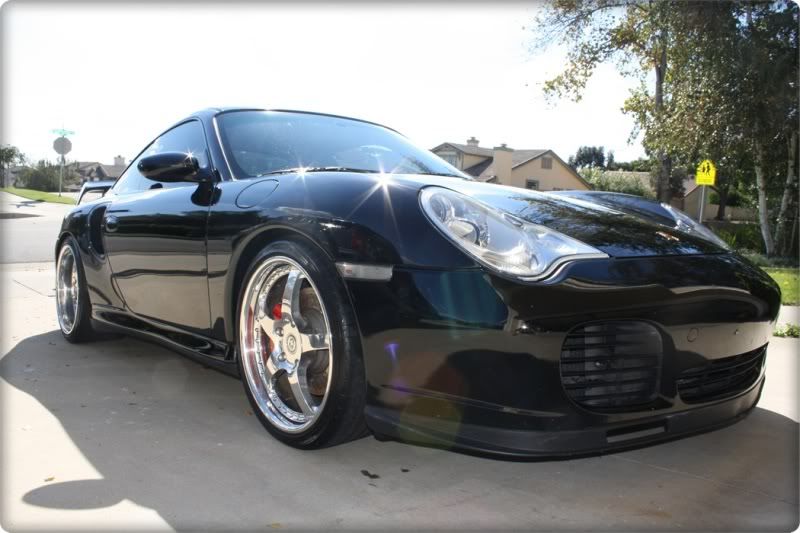

Afters:
Overall, a HUGE improvement and MUCH clearer paint! No more oxidation hiding the true color of this jet black paint! 5.5 hours was spent on this car/process
