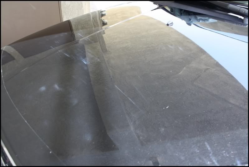

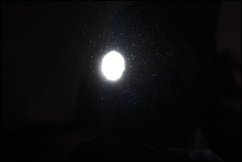

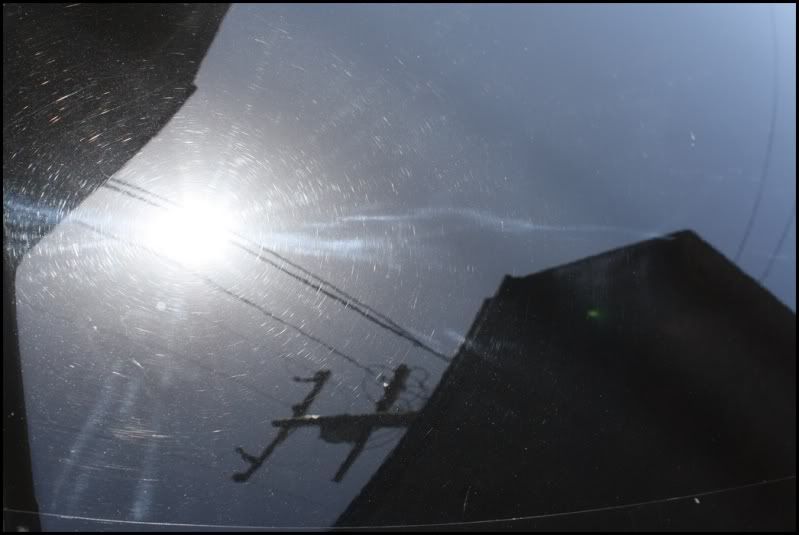

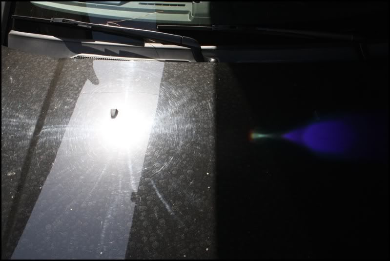

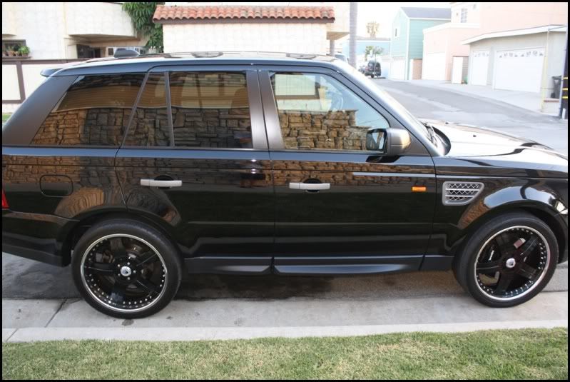

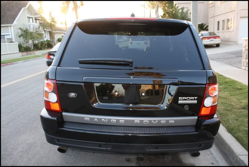

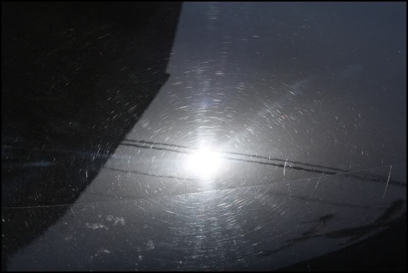

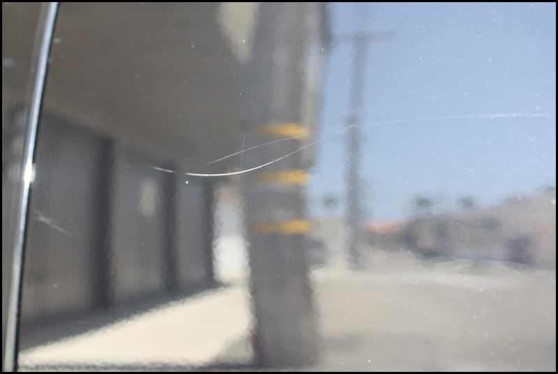

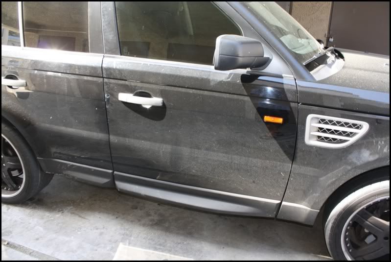

I get the call to come see if I can get some scratches out and if I can, then we would go over the whole car with a two step process! So, I cruise over an hour away to see whats up with the scratches and how deep, etc. I take some 105 on a 4" orange pad by hand and its about 75 % removed with 3 passes, so I knew it would be easily removed with a rotary and PFW/105.

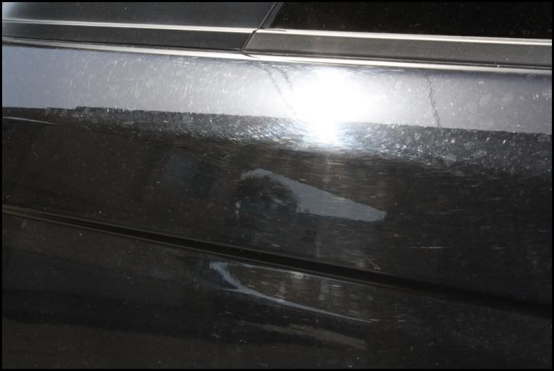

After I knocked out that scratch, I went around the rest of the car and tackled some other easily removed scratches I saw. There were just a couple where you could tell it was deep, so I just blended as much as possible.

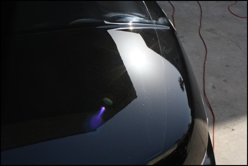

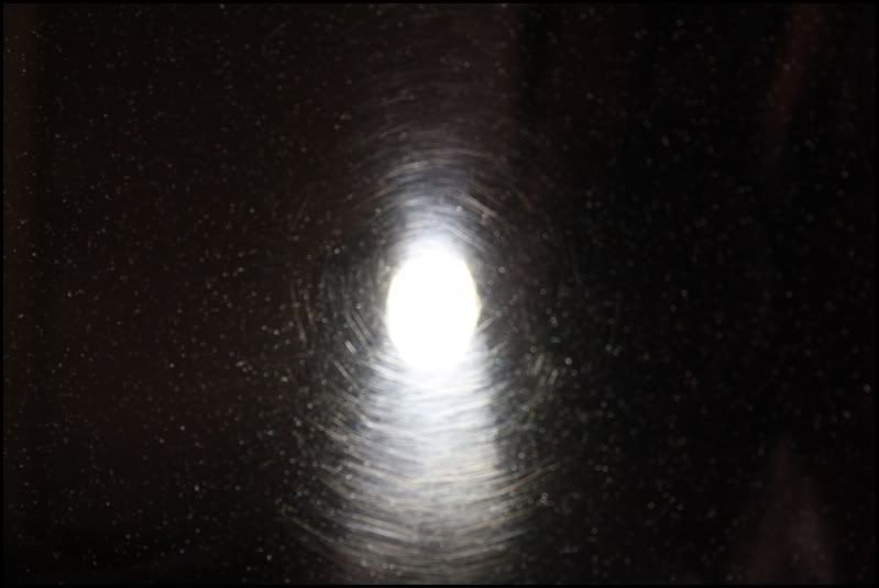

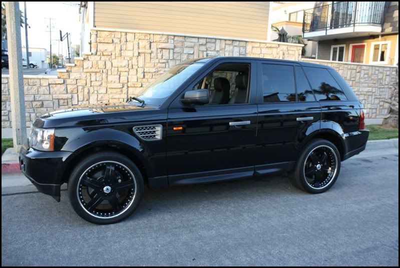

After that, I ended up with a PC/orange/105 around the whole car, then white pad and 85rd as 205 was leaving too much micromarring behind of its own on a megs yellow pad. The white pad removed the orange pad haze while the polish restored the gloss!

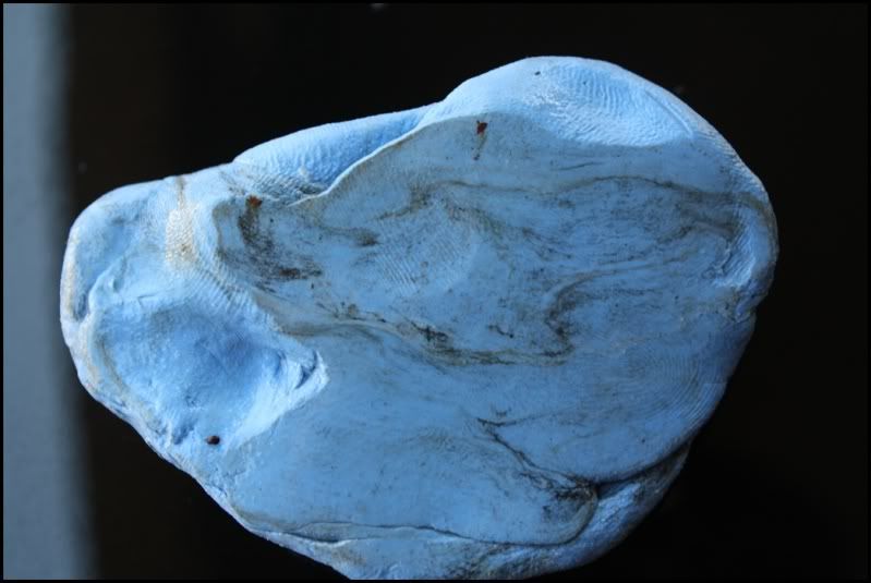

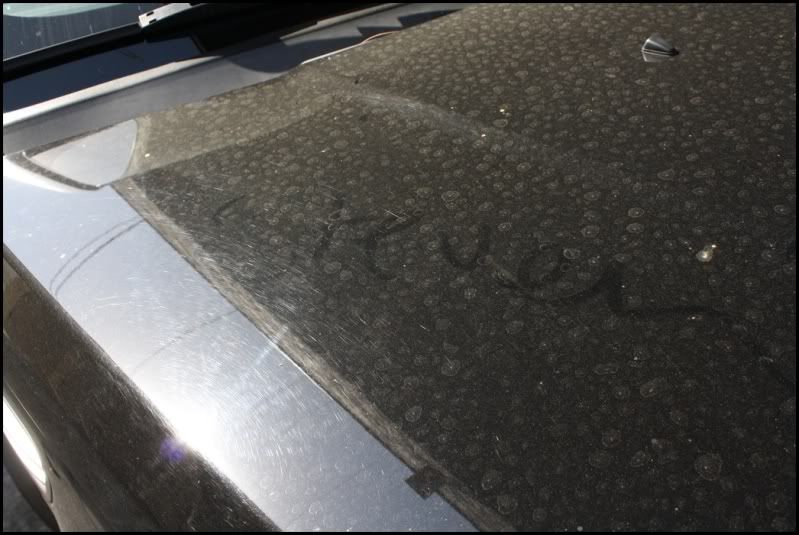

Before I removed the BFWD, I applied megs hyper dressing to the tires and all the trim. this really set off the car! I then applied chemical guys bare bones to the wheel wells and proceeded to wipe off the BFWD from the paint!

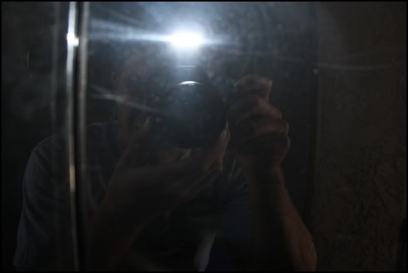

Befores:
During:

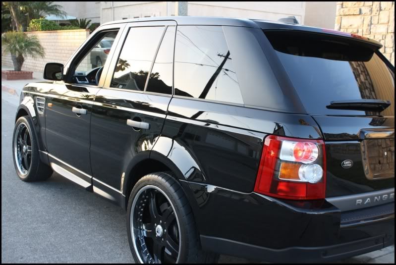

Afters: (about 730 in the evening...tried to find some sun, no luck)

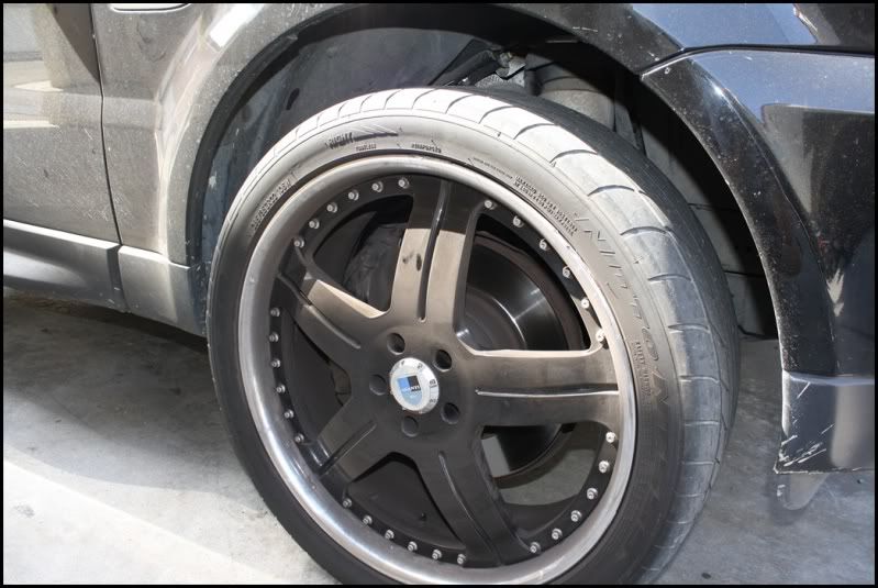

I simply can't believe that someone would seriously have rims that are valued at over $1,000 ea. and allow them to look that way along with their $75,000 SUV.
Nice work Eric.
1000 each, damn, you would be surprised if I took a pic of the condition of them! they need a complete restore, not just a polishing!
Nice job, I'm surprised to hear you getting micro marring with 205 and a white pad with the PC.
At least you got that paint back up to speed, it looks great.

Man, you always do such F'd up cars! I hope you get lucky once in a while with some easy ones? This one came out great! I take it the paint was soft if M205/White was marring? Nothing like 85rd for final finishing.
yup good old trusty 85rd. Eric, yeah man Asanti rims are by no means cheap! They usually run a lot more then that. Closer to like $6,000-$10,000 a set.
Bad *** rims though if you ball'n because you can get them with a 8" Lip, custom colors all kinds of stuff man.
and yes those are diamonds . . . . . The Million Dollar Rims
