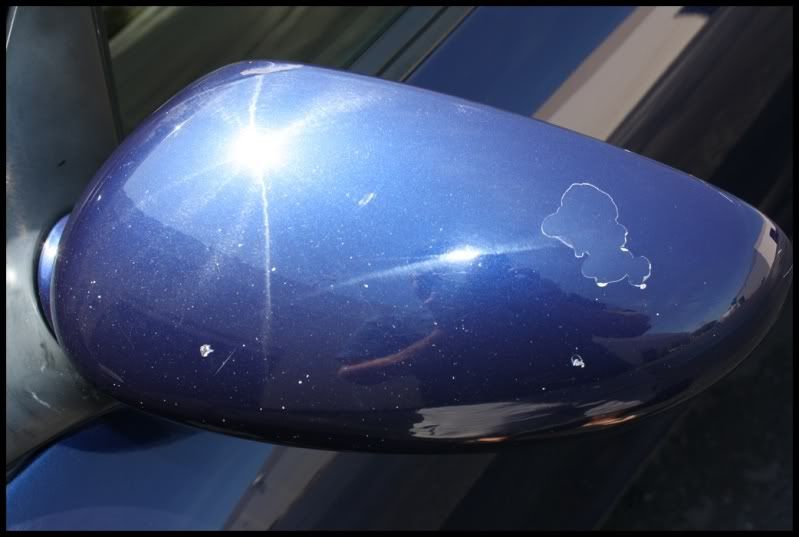

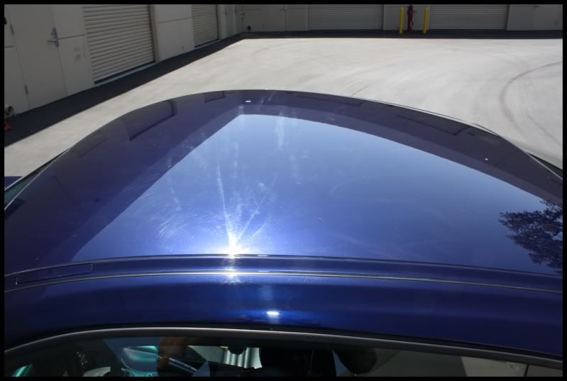

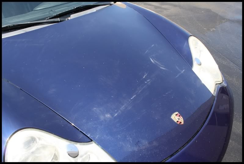

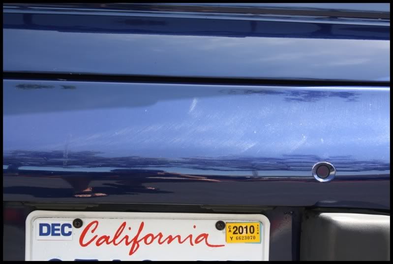

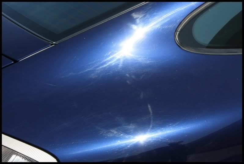

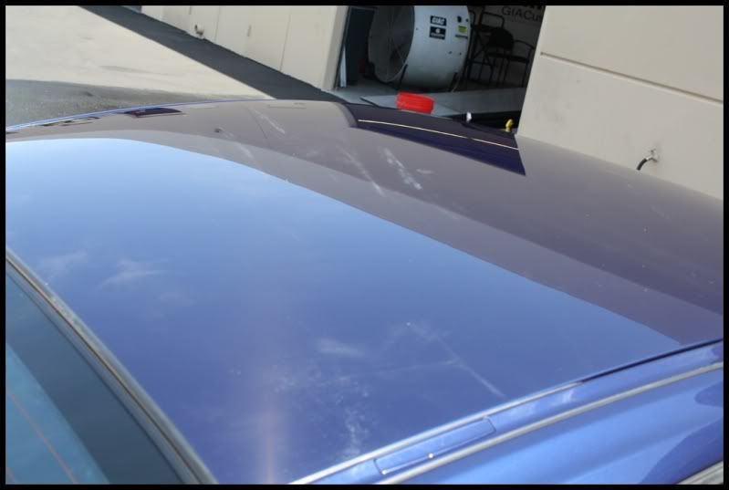

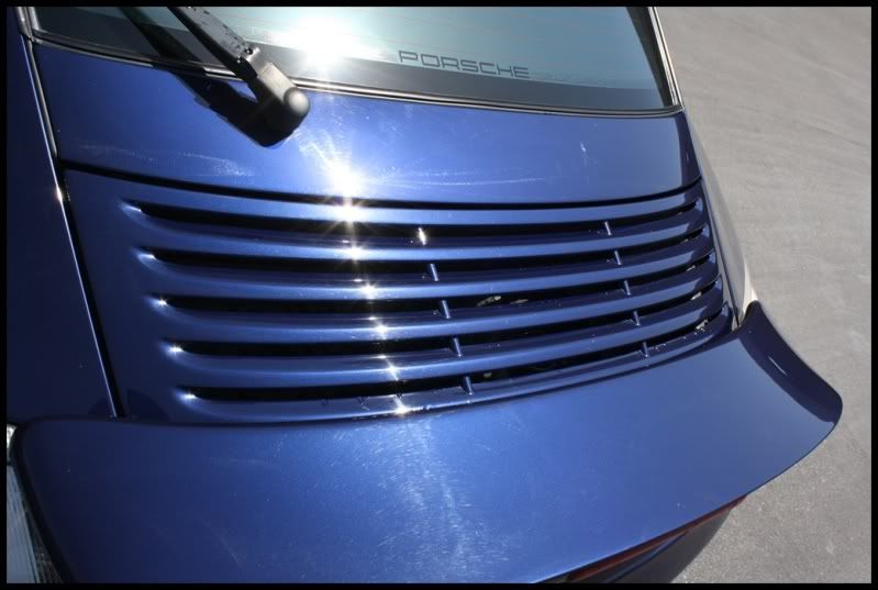

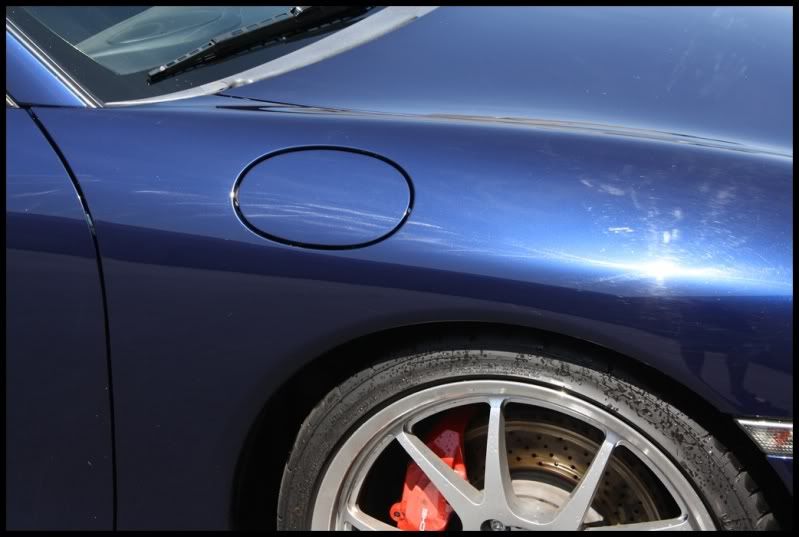

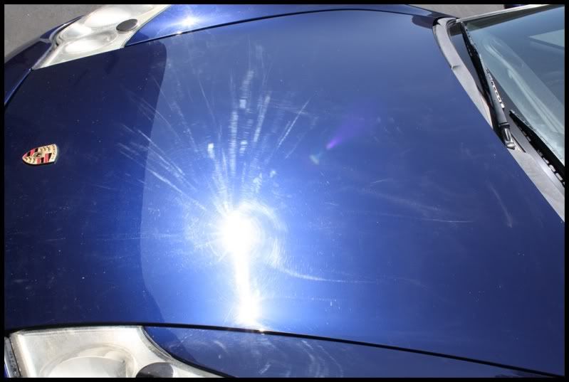

Upon arrival (first time seeing it in full sun) YIKES
My point in posting all those holograms...EVERY PANEL HAD SEVERE HOLOGRAMS ALL OVER IT

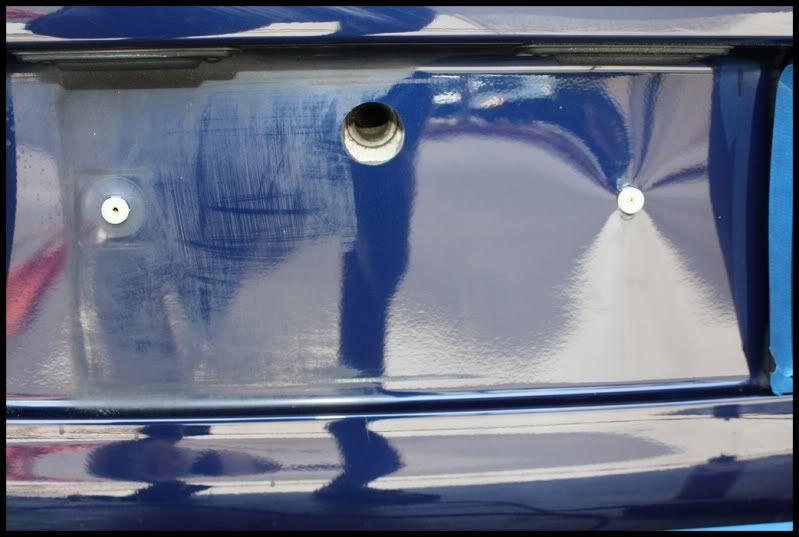

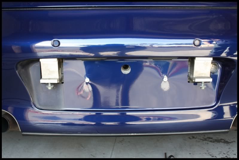

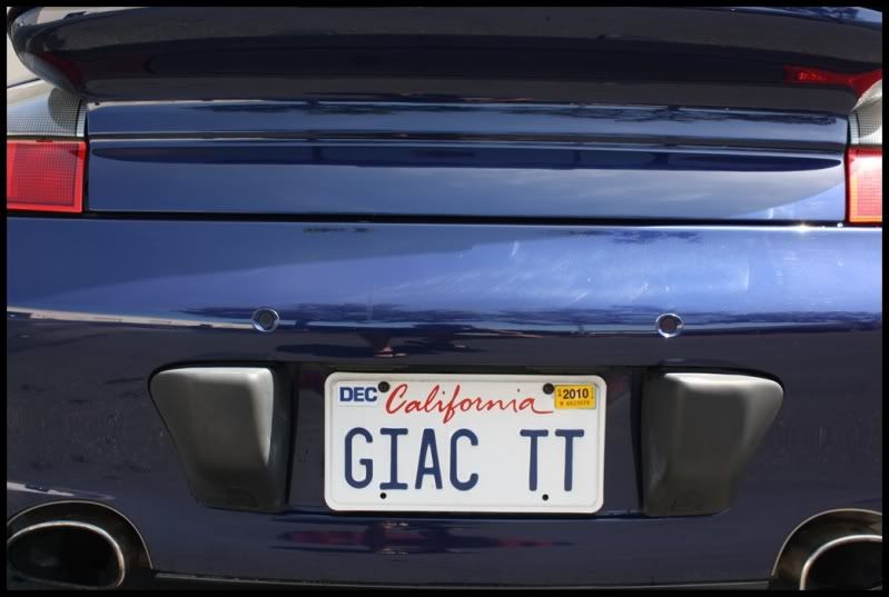

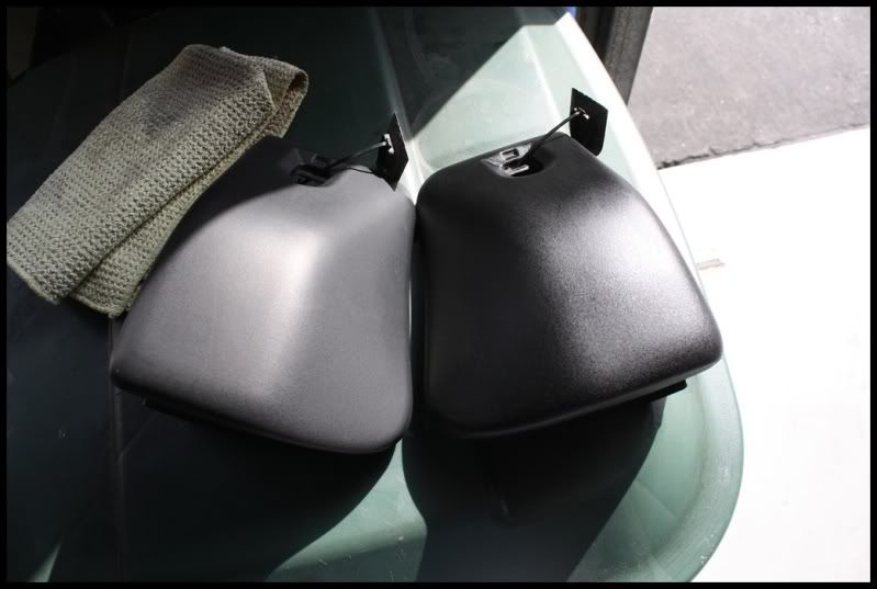

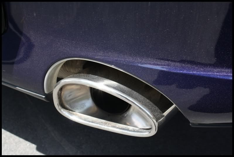

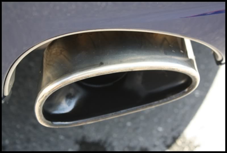

Moving onto some 5050 shots, here are the bumper accents, dressed and not dressed, exhaust tip before and after, and after removal of license plate polishing 5050 - have to give credit where credit is due: Austin (company rep and detailer on the side) gave me a helping hand on some areas while I polished the car. The main focus was the paint for the car show the next day. But because he hit the little stuff like washing the car prior to my arrival, cleaning and dressing the bumper accents, and other odds and ends, it allowed me more time with the paint! Thanks AUSTIN!!!!
