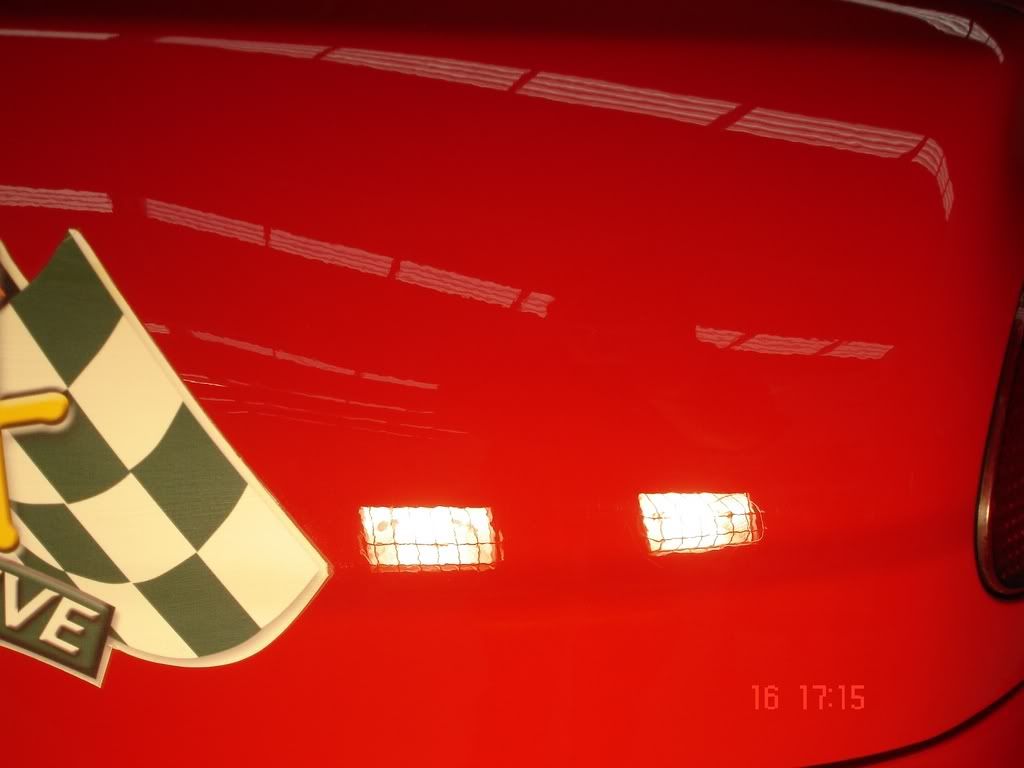

This is a quick couple pics after aussie gold clear cut & SG
Not very good really but I was tired and hungry.

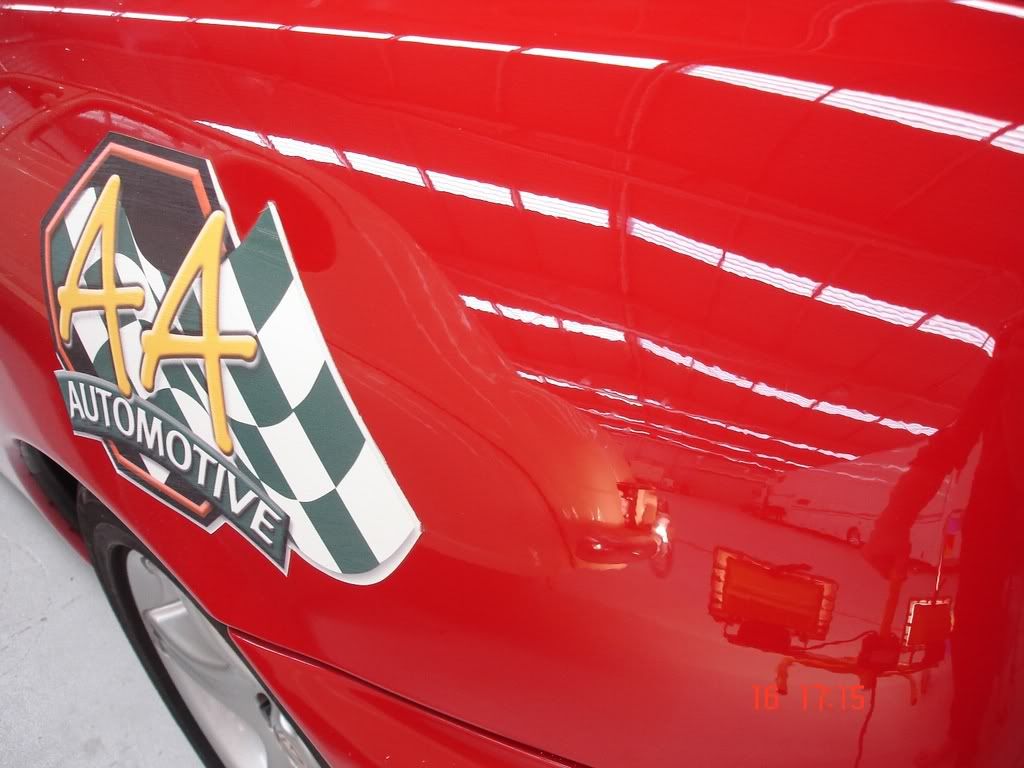

Dad's MG F racecar rear quarter after menzerna and glare pro polish
