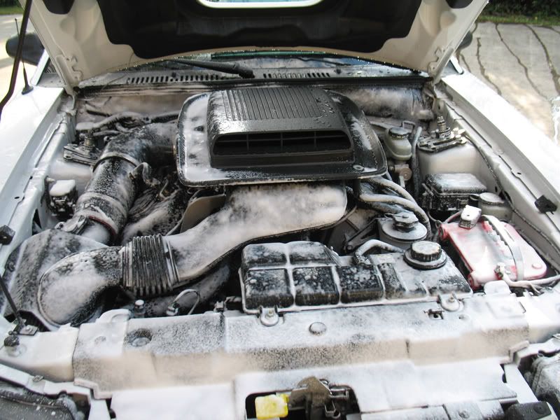

During Foam stage :chuckle:

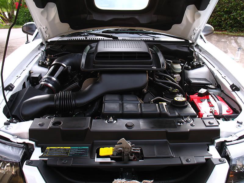

After:
You can see here where I hadn't wiped the hoses down, thats why when the foam has dried, I soak a mitt with some of the tire foam that I'm using and gently wipe everything down that I can touch

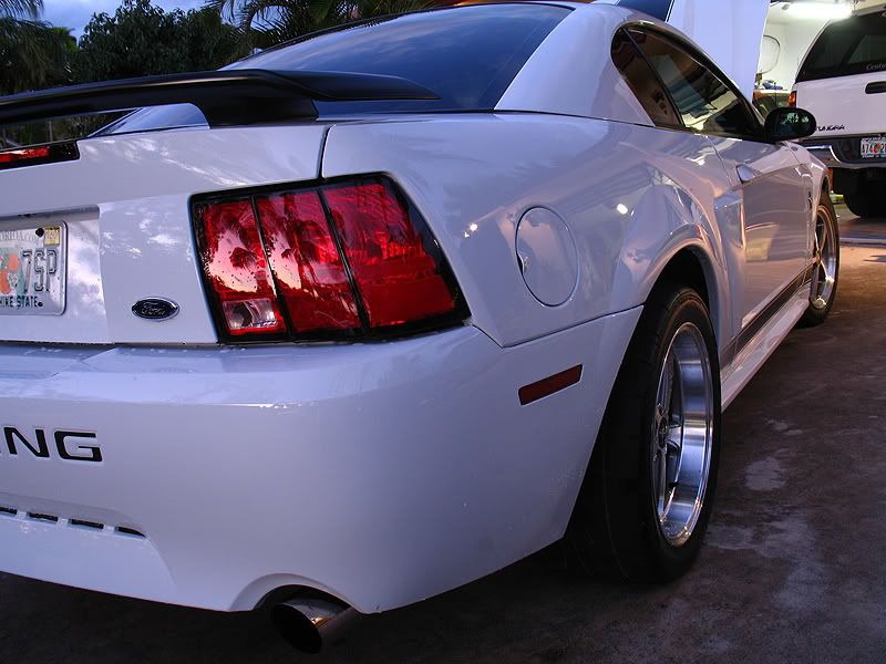

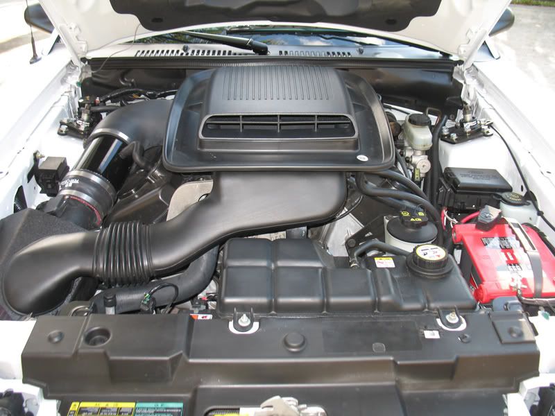

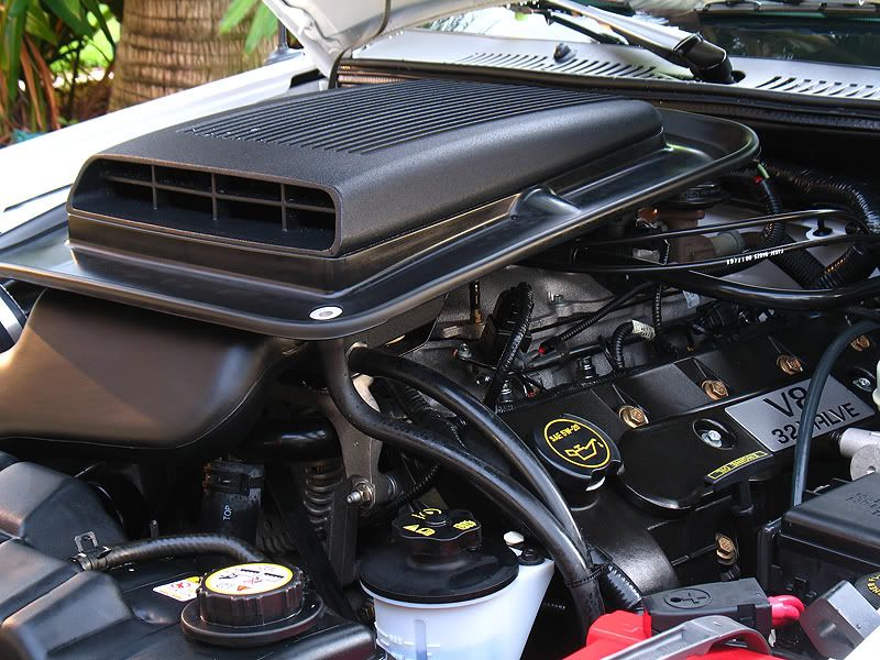

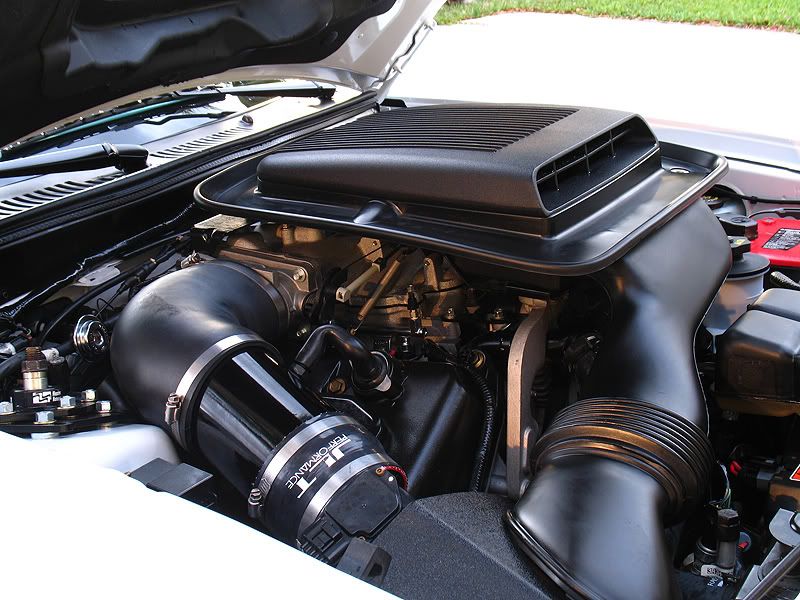

So there you have it! Here are two pics that I took that I thought were cool, they just looked too pretty not to post!
