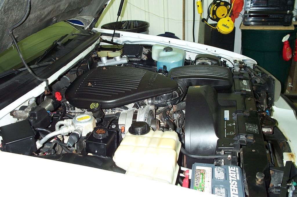

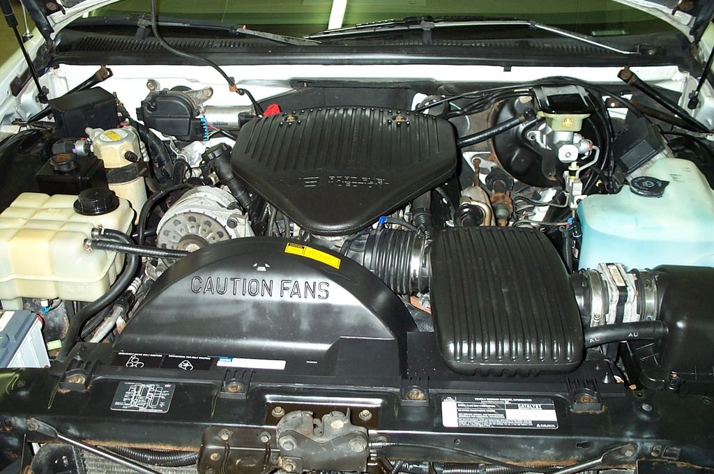

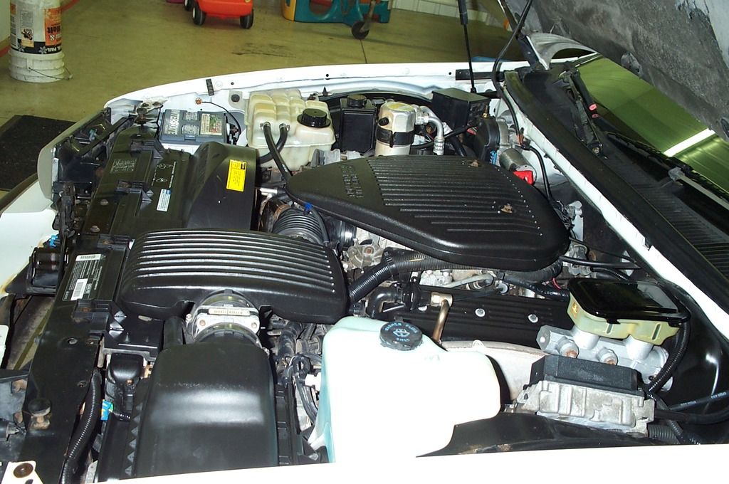

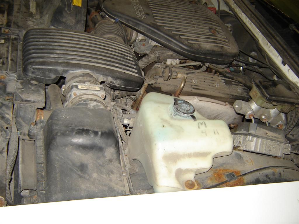

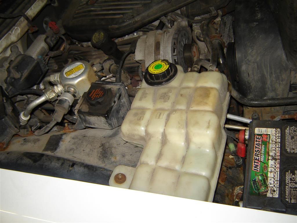

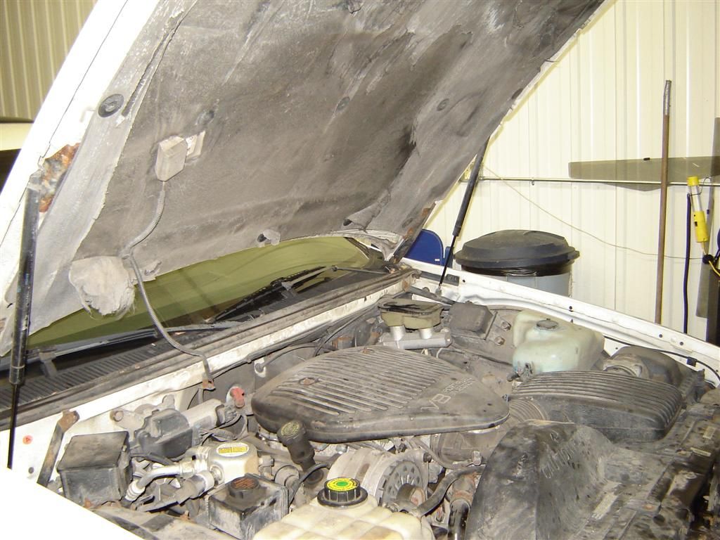

Here is my old LT1 Roadmaster wagon that I used for a winter beater a few years ago. It has 203k miles on it when I bought it.
The day I brought it home. :vomit:
After a little pressure washer action, some APC, brushes, crappy towels, and elbow grease. Dressed with whatever cheap stuff I had at the time. :lol:
Not perfect, but it was just my beater and I wanted it to look "better" and couldn't stand the filth.
Randy
