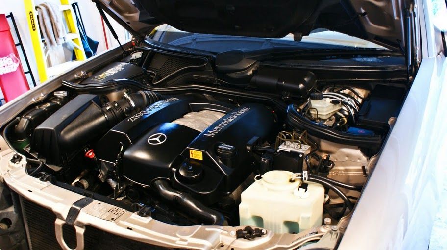

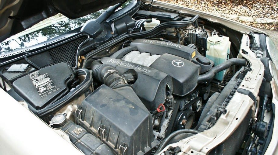

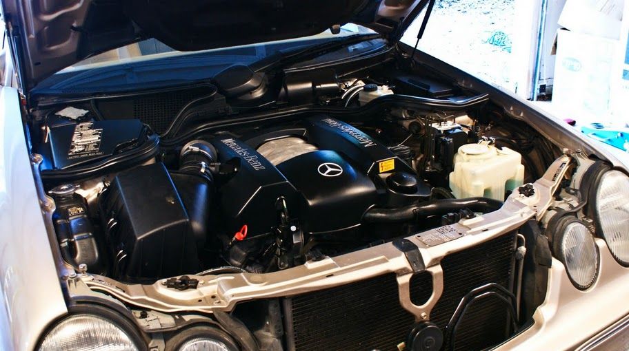

An old pic, but one of the dirtier engines that I remember:
BEFORE:
AFTER:
Very nice Shade! The only engine bay work I get requests for are like ranch trucks that get really dusty. I nice engine like that ^ would be worth working on.
If I remember correctly that MB was more than 10 years old with over 150k miles on the odometer. Now a days it seems more companies are opting for the cleaner look of black engine covers and not much else. Makes our job that much easier! ;)
