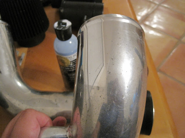

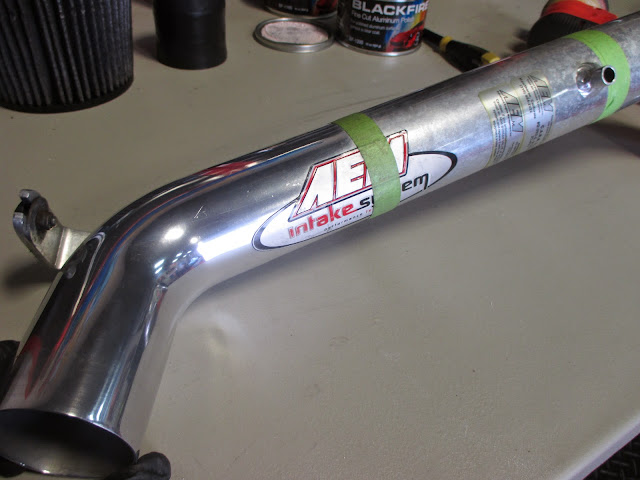

Engine bay chrome- Need some ideas

If it`s polished aluminum, use Mother`s Billet Polish. Expensive, but far better than OTC Mother`s Mag and Aluminum Wheel polish. Second choice would be White Diamond Metal Polish.
One thing about chrome is that it can be scratched with the wrong polish and cloth use, especially on chromed plastic. Chromed metal, if it`s done correctly, is extremely hard, BUT, care must still be taken. I use chamois-like microfiber for metal polish removal. Yes, they will get black and quite dirty-looking. One thing I would not use is cotton terry-cloth or old bath towels. Yes, they are cheap and disposable, but it`s not worth the risk of scratching chrome.
