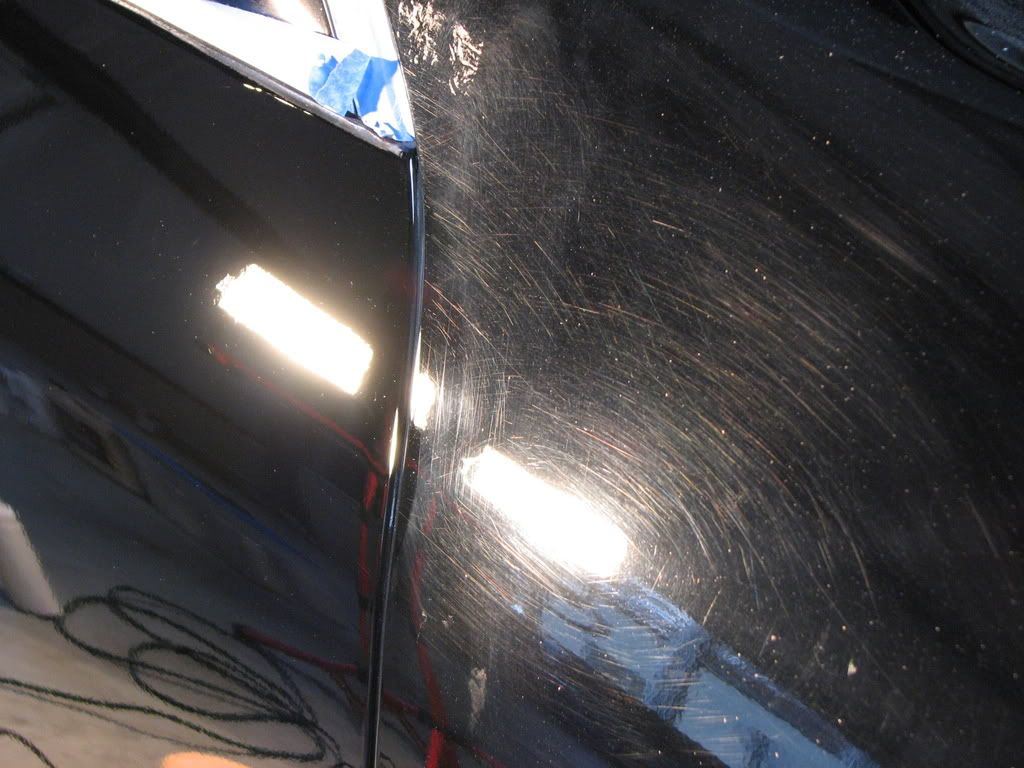

This detail (Infinity M) took me and Howareb 37 man hours to accomplish. The rotary would simply not correct this perticular paint for us.
I will post a picture what the paint looked like with just the flex after alcohol wipe. This was after all steps.
Now, can you cut out a step? On lighter colors you most definately can, because the wool finishes down so nice without holograms. Of course it will depend on the compound one is using. SSR3? Not sure. 105 (will dust like hell sadly) is another story. So is HD UNO which is perfect and no dust.
