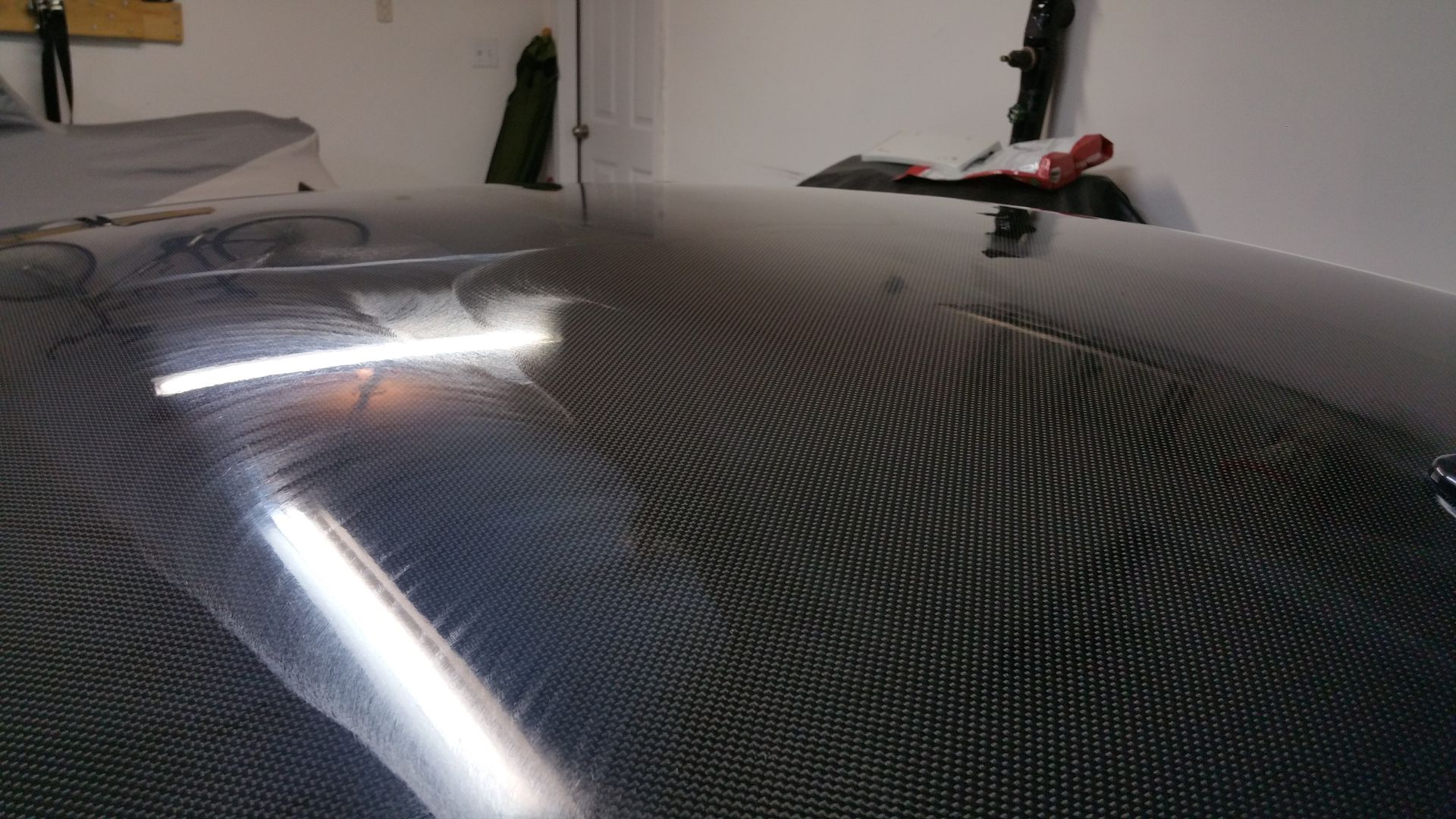

Got to work on the carbon fiber roof. It looked good in the sun, but was riddled with lots of wash marks. Much like the rest of the paint.
Before
