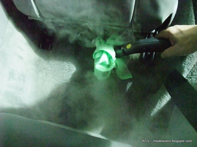

a further detailing * its an additional for you to consider
deeper cleaning with steamer
on carpet area
on leathers - loosing the dirt accumulated in leathers pores
