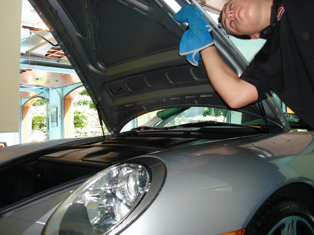

While the engine was still a little wet from the wash I cleaned it up with APC 10:1 on a damp MF, later everything was dressed with P & S express interior cleaner which left a simple matte look on the plastic and trim pieces. All door jambs were cleaned with the APC as well.

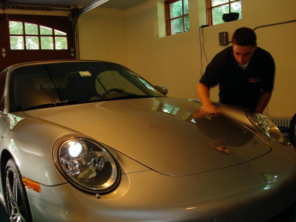

Tips polished with Noxon using #0000 steel wool on the chrome and #00 steel wool on the inside, then polishing again with just an MF

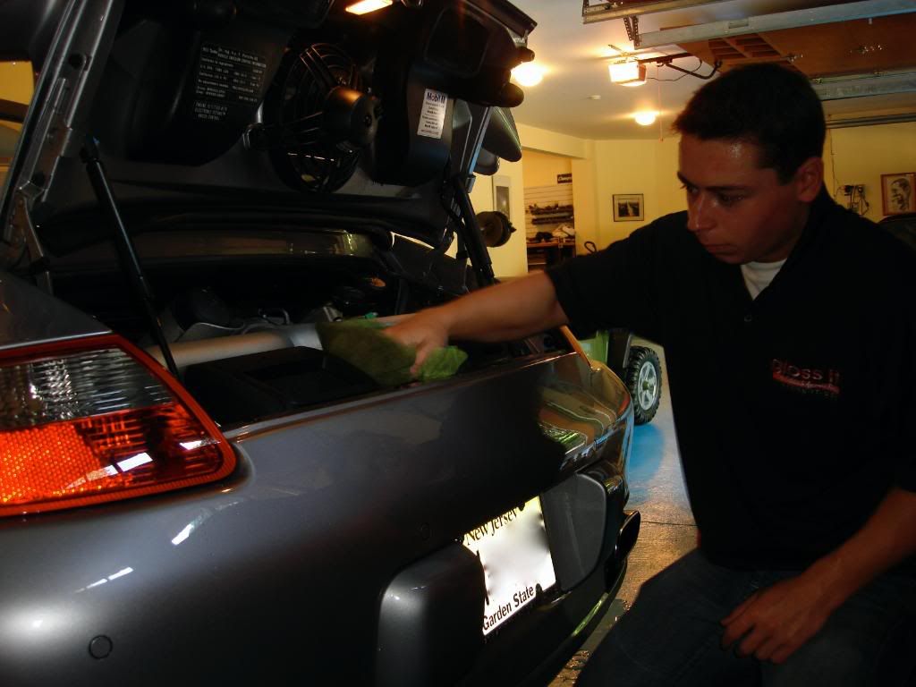

Raised up the rear wing again after the wash to polish out the poles
Correction was nothing major at all, only a few stops needed several stages of polishing or wetsanding . The car is still fairly new so a 1 step correction was agreed on with the owner for most of the car, except the few problem areas
