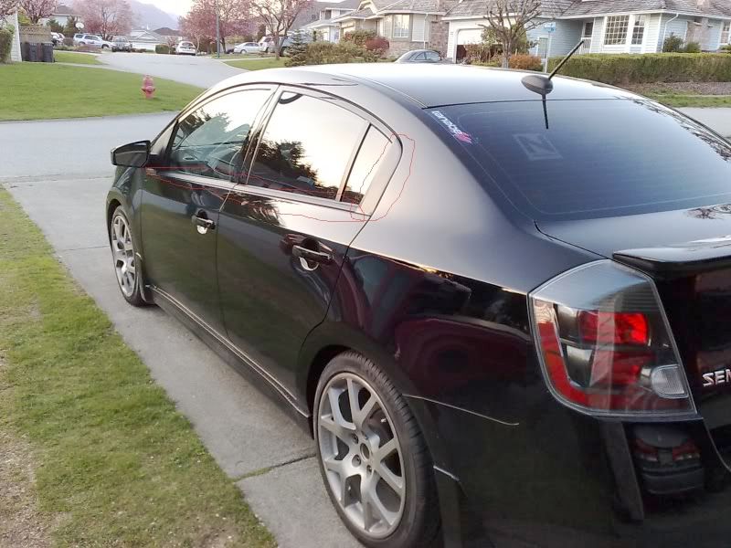

Ok so I'm FINALLY going to be detailing my car tomorrow, I have everything I need except for one thing: Knowing exactly where to tape off. I did some snooping today at work and came across some threads.
I went outside and took pictures of everything I think should be taped off, I just need autopians to confirm that I'm right, or if there's anything I've missed

Plastic Trim on rear door

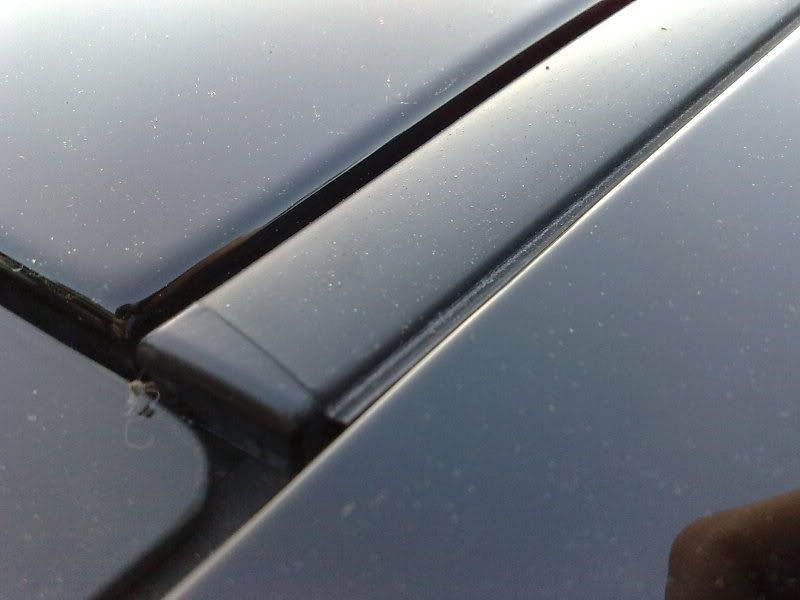

Some sort of plastic running along the roof on both sides

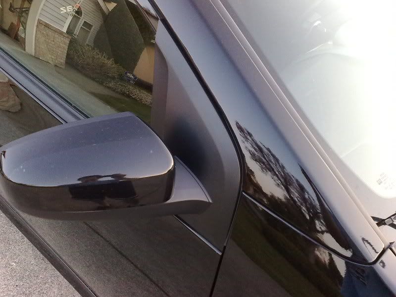

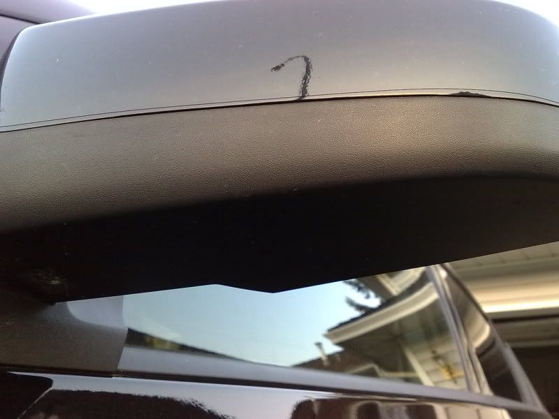

Plastic trim piece connecting mirror (also runs along bottom of mirror

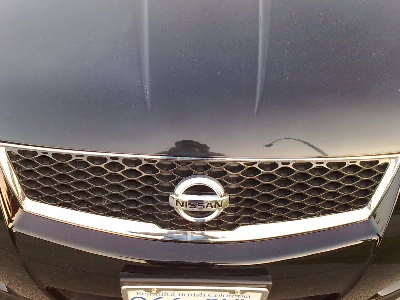

Chrome trim on front
Moulding on top of front window

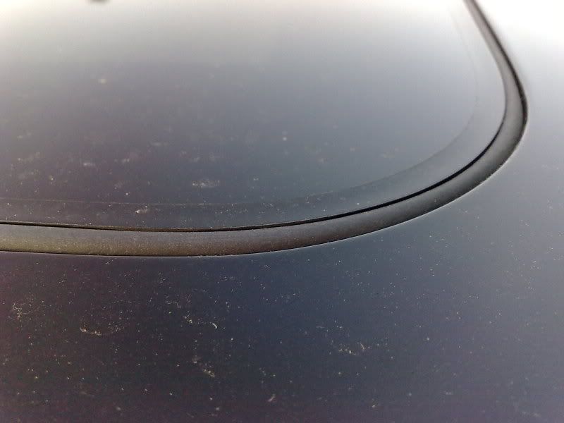

Moulding around sunroof
Plastic under side mirrors (not sure if this needs to be done or not)
I circled some rubber/plastic pieces at the base of the windows here

I'm using 6" pads, if I tape off the emblems can I just feather over them?
IMO, there is a difference between the textured plastic and rubber trim, and the chrome. The textured plastic and rubber may become stained from your polish, while the chrome (such as the emblem) won't be damaged (in most cases) by polishing, it just may be a PITA to get the residue out of.

What kind of polisher? If you're using a PC or a flex and fairly mild polishes, as in nothing more aggressive than a white CCS pad and SIP, then you don't need to tape off those emblems. Be careful around emblems and any change in elevation, or any seams. The flex is very unforgiving, more than most people give it credit for.
One thing that hasn't been addressed by other users is your mirrors. Tape off the lower mirror trim! You'll definitely stain that, or at the very least you'll make the shine noticeably uneven.

While I've run my polishers over plenty of emblems with zero problems, the emblems on my Jag have the chrome worn off their edges from years (decades) of polishing even though I've always used mild approaches on that car. You can get away with it right up until you can't ;)
