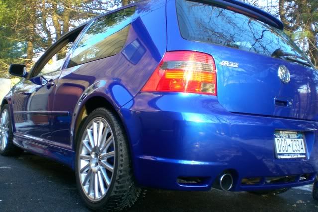

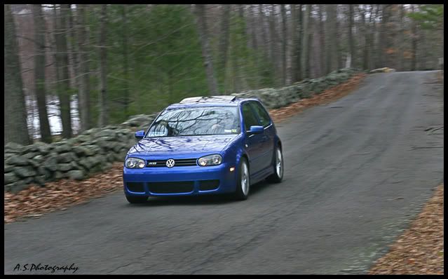

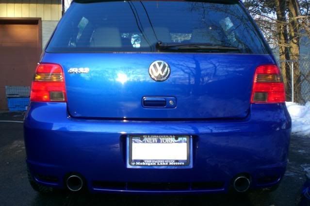

(Pics for clicks - my baby)
LOVE the car, I used to own one of those!
everything looks good, i do believe you have to wait 12-24 hours before topping SG though.
I REALLY like that color!

Car looks aweseome, I've almost traded in my Jetta multiple times for an R but as a fellow VW lover they are just too hard to part with.
