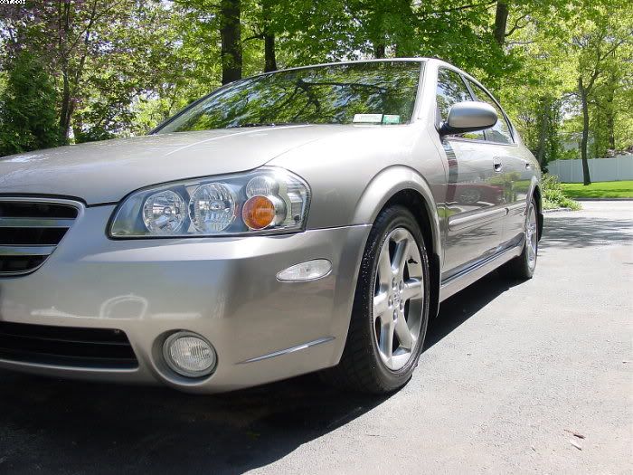

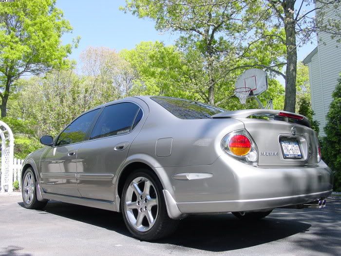

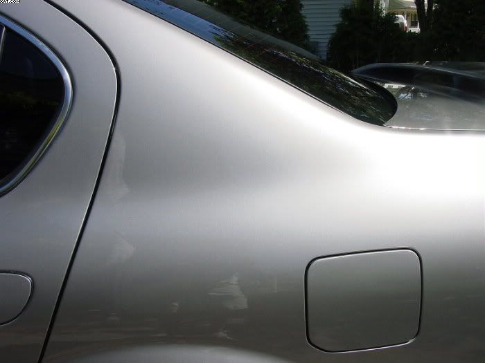

Raveendra came from over 90 mins away to have his car done and likewise didn't have someone to follow him to my place to pick him up. He waited all 6 hours while I completed it. This job took me a bit longer because I had a problem with the paint. The pad kept skipping no matter how much I primed it and cleaned it. I've never had this problem before and I tried everything (diff pads, polishes, shade/sun, etc). Anyways, the car was relatively clean with light to moderate swirls and lots of bonded contaminants being the main problem.

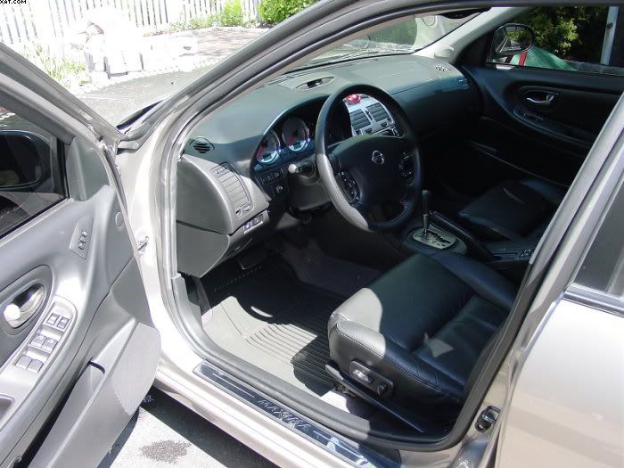

The interior was pretty simple and consisted of:
-Vacuum
-303 Spot Treater followed by Simple Green cut 10:1 to remove remaining stains
-Simple Green mixture used with an MF to degrease the door jams
-APC 10:1 to clean leather, vinyl, rubber, plastic
-Optimum Protectant on vinyl, rubber, plastic
-4* Leather Conditioner on seating
-NXT Glass cleaner on glass and clear plastic
-Mats cleaned with Simple Green and dressed with Meguiar's Hyper Dressing cut 2.5:1
-Door jams sealed with OCW

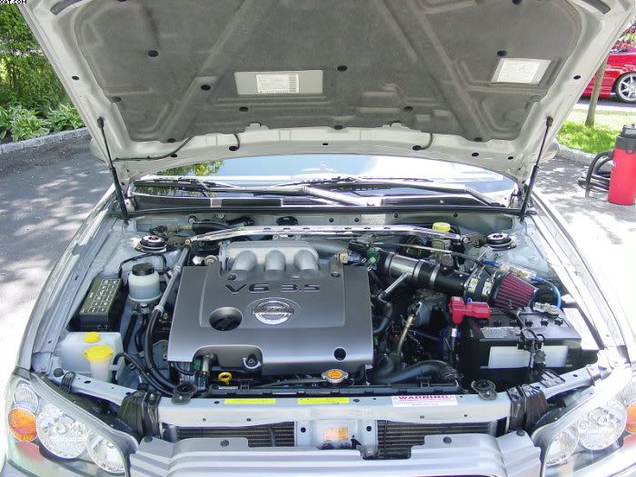

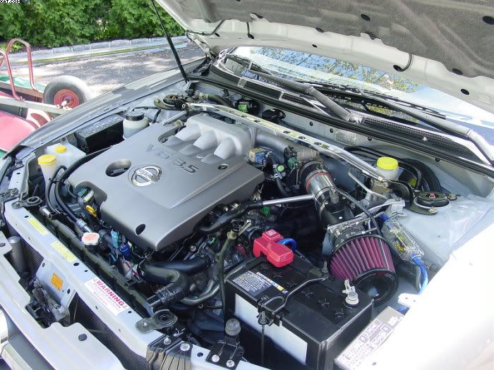

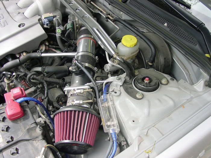

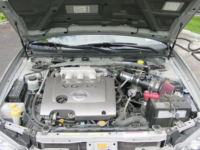

Next was the engine. It hadn't been cleaned since new and certainly needed it. When all was said and done, I was happy with the results. Final processes:
-Rinse warm engine
-Soak with Simple Green full strength for 3-5 mins
-With Meguiar's wheel brushes and a NXT car wash dilution, I scrubbed everything
-Rinse, idle for 5 mins, and let dry
-Soak with Meguiar's Hyper Dressing cut 2.5:1
-Wipe down excess after 2 hrs (exterior)
-Polish all painted/polished surfaces with Klasse AIO
