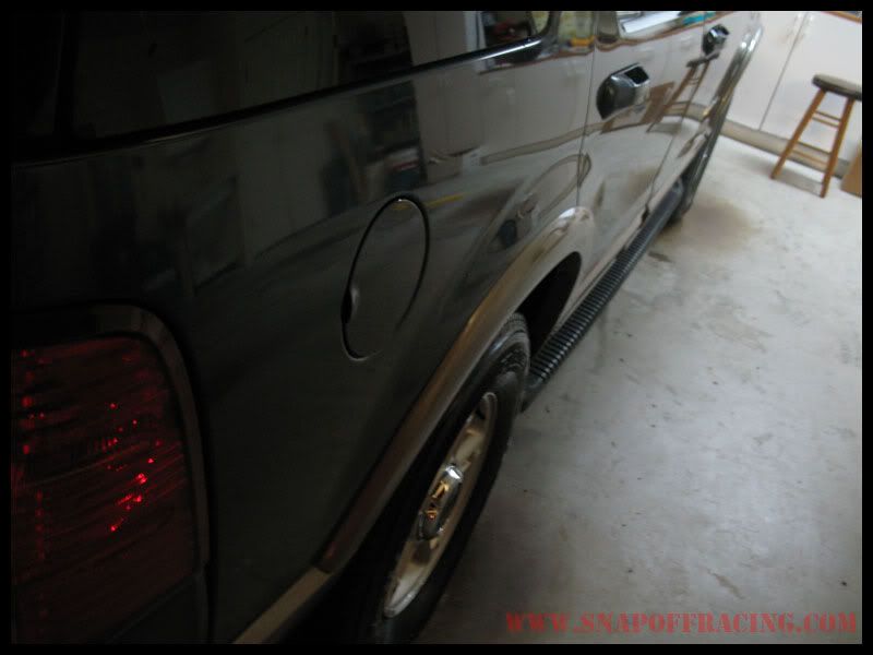

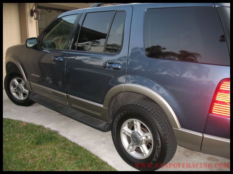

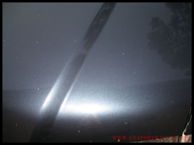

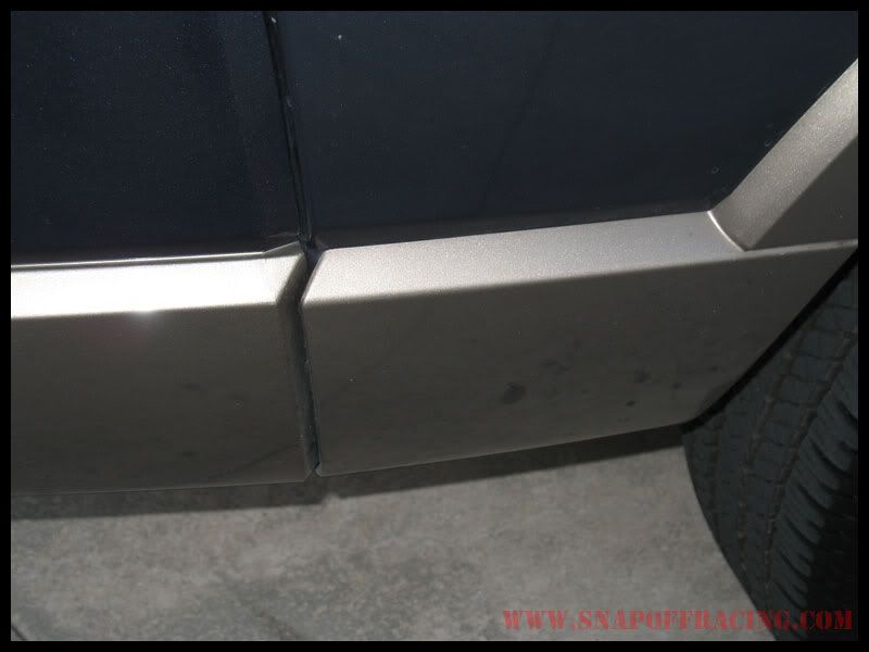

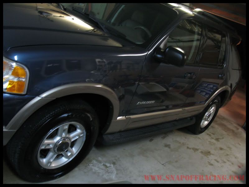

Truck was already washed a few days before, but I washed it again using the following:
* Megs wash+wax w/ foam gun sprayer
* Pinnacle Wheel Gel on wheels/tires/wheel wells with brushing
Entire truck was clay barred using megs quick detailer and a Zaino clay bar.
Afterwords, I went over the paint with Pinnacle XMT #3 swirl/scratch remover on a yellow l/c pad, followed by pinnacle soveran wax on a white l/c pad.
Trim was all wiped down with Black Again
Door Jams were all hit with Pinnacle Wheel gel and thoroughly wiped down.
Wheels were hit with Wheel Wax after cleaning
Vacuumed interior thoroughly with Metro Vac N' Blow
Interior wiped down with 303 Protectant
Leather seats wiped down with Pinnacle Leather Cleaner/Conditioner
BEFORE:
AFTER:

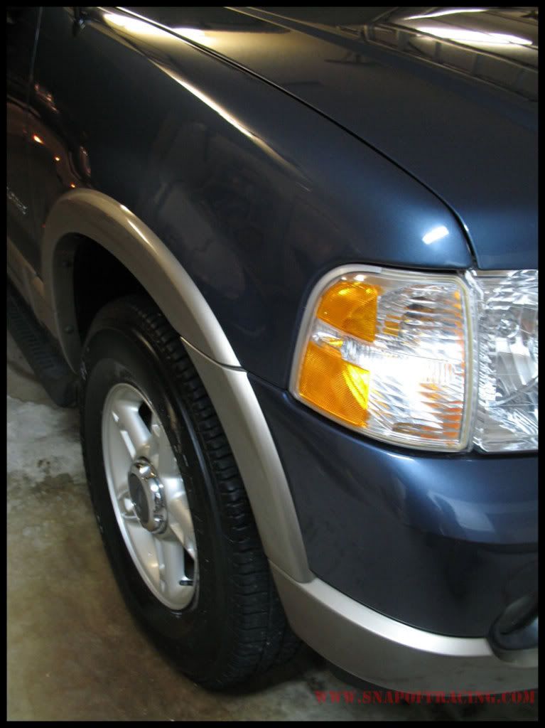

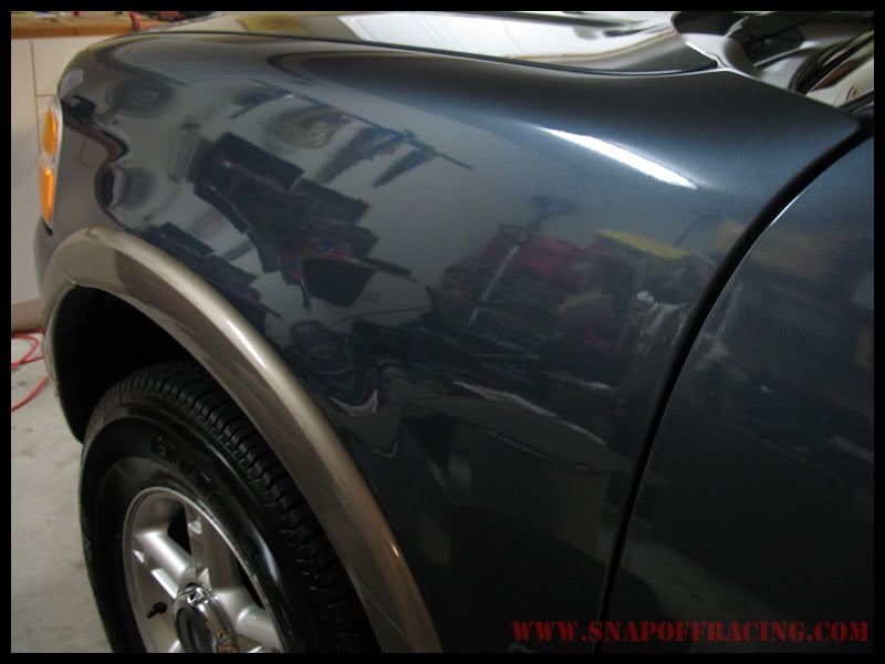

BEFORE:
AFTER:
