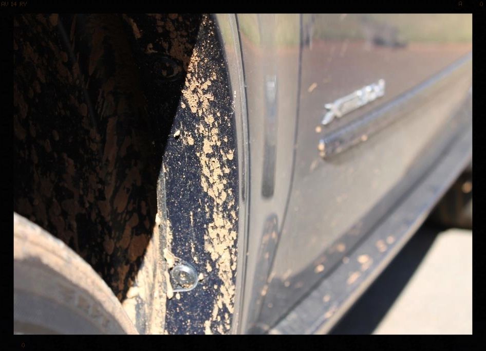

Arches : HP rinse / APC / Mothers Fenderwell Brush / HP Rinse / Glossworx Extreme Tire Dressing
Tire cleaning : HP Rinse / Meguiars All Wheel and Tire Cleaner / Mothers Tire Brush / HP Rinse /
Tire protection : Gyeon Tire Coat

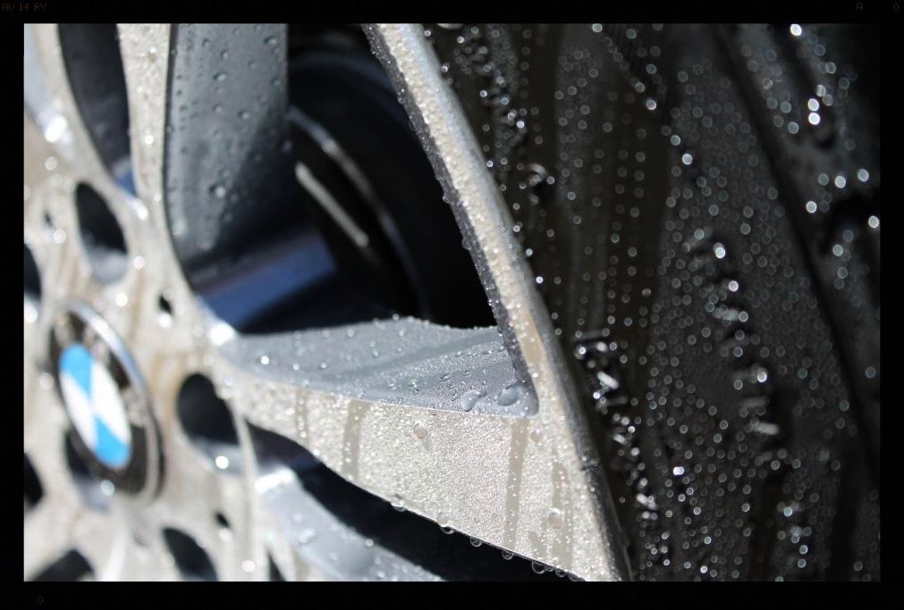

Wheel cleaning: HP Rinse / Valet Pro Billberry @ 1:3 / Daytona Jnr / Valet Pro Brushes /HP Rinse
Wheel tar removal : Valet Pro Citrus Tar Remover / HP Rinse
Wheel iron removal : Valet Pro Dragon's Breath / Daytona Jnr / Valet Pro Brushes /HP Rinse
Wheel protection : Gyeon Wet Coat
Before
After

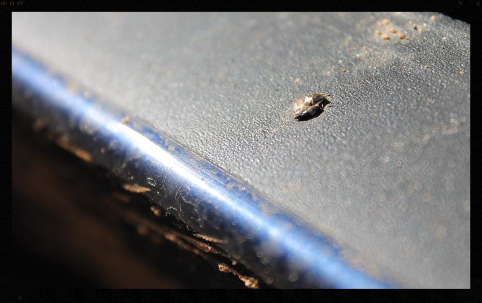

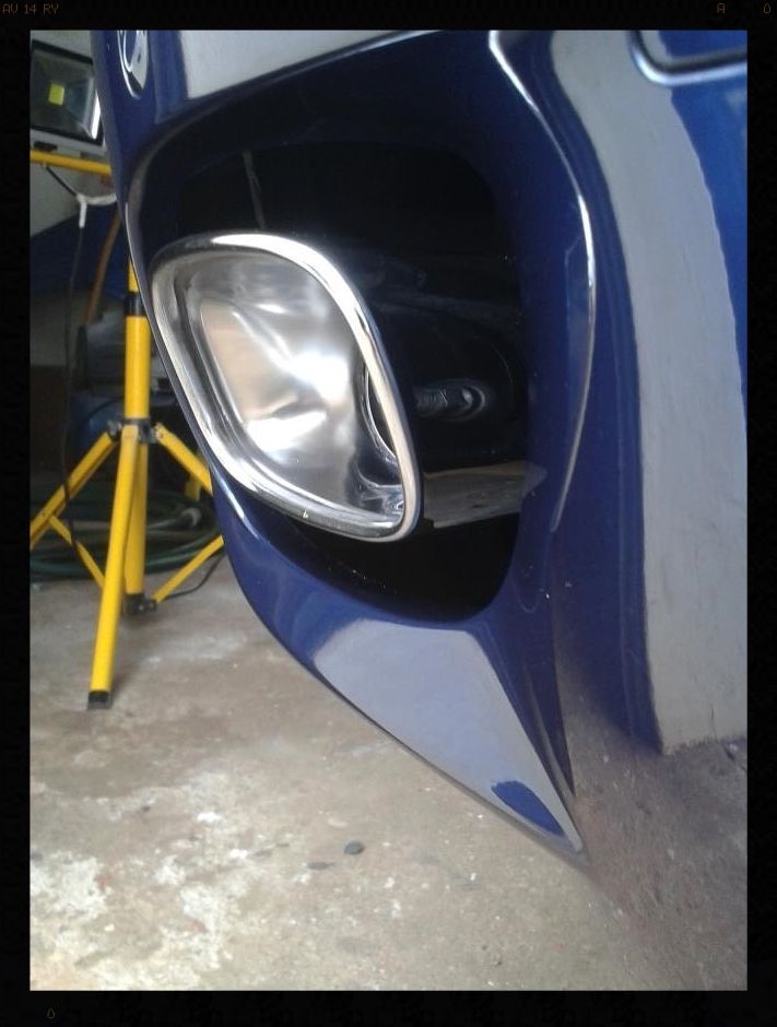

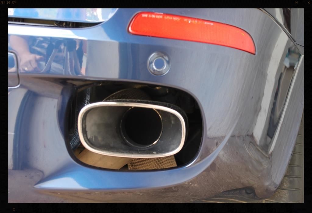

Exhaust tips : APC / Steel wool / Meguiars NXT All Metal Polish / MF Towels
Before
After

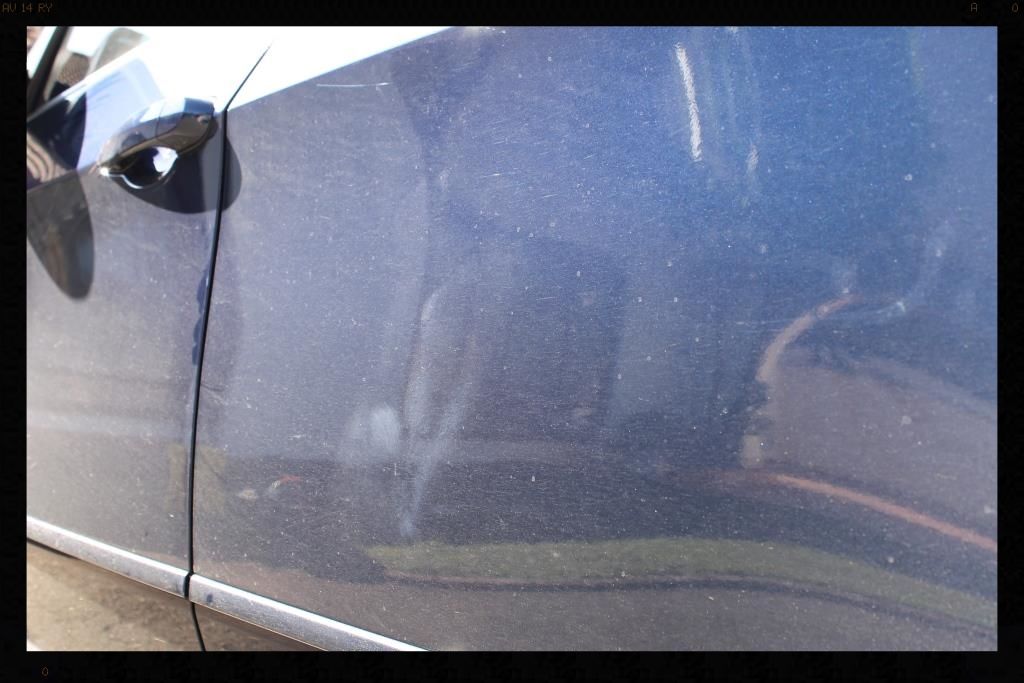

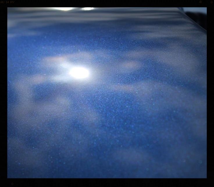

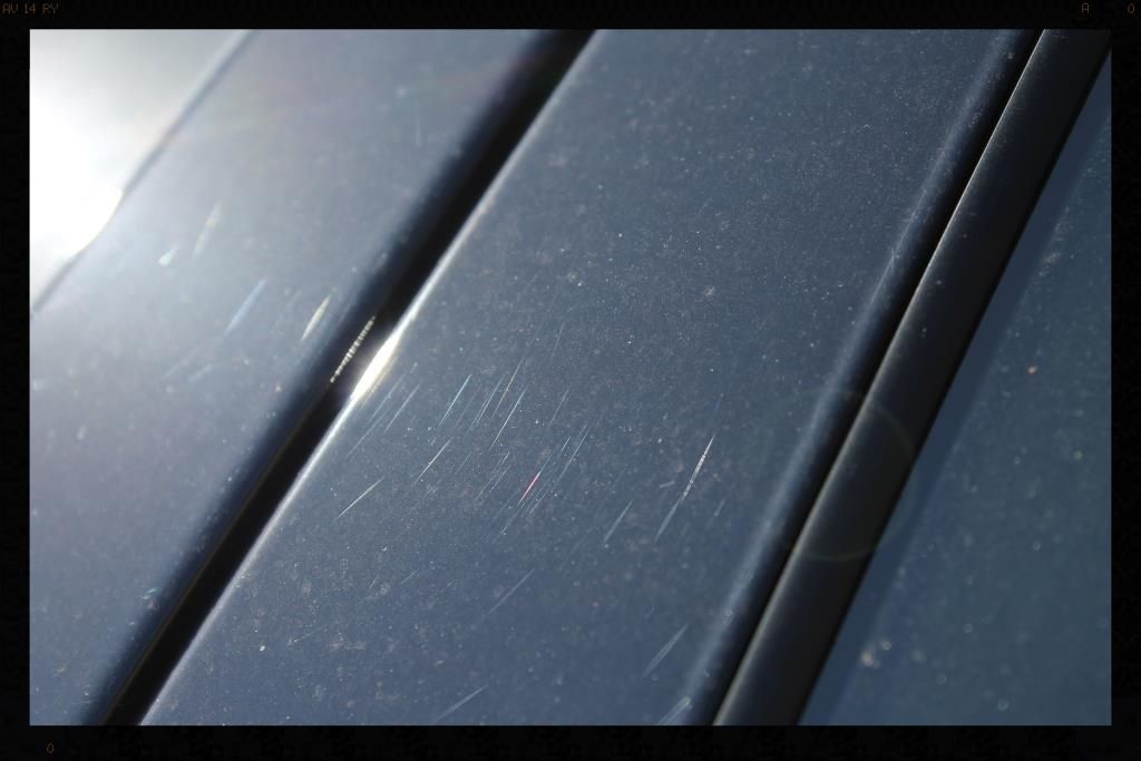

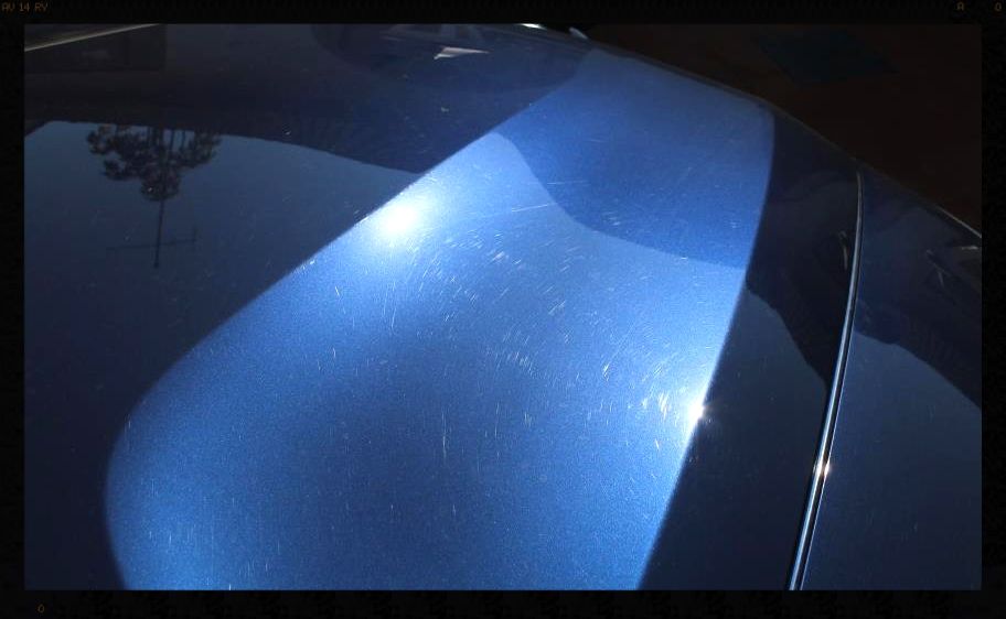

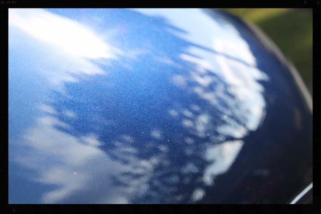

Paint thickness readings were then take ranging from 98µ to 123µ but averaging 105µ.

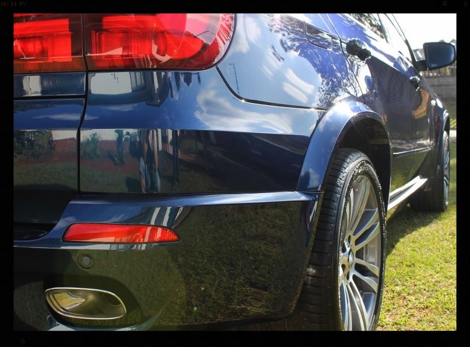

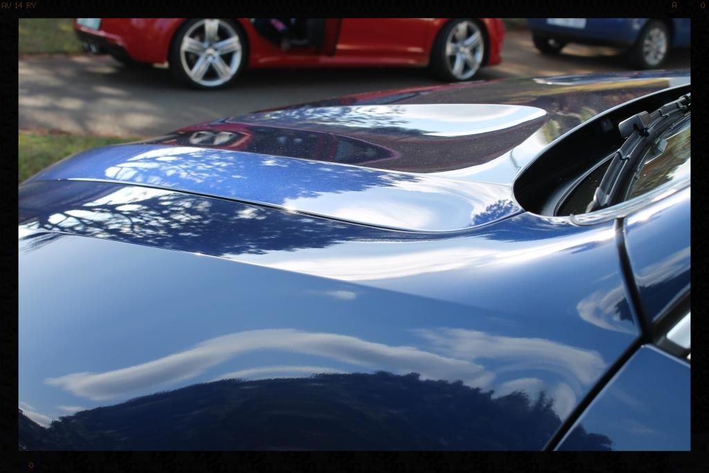

Correction : Flex 3401 / Shield DA / Menzerna PF2500 / Lake Country 5.5" Tangerine Hydrotech / Lake Country 4.5" White CCS
Protection : Chemical Guys Pete's 53

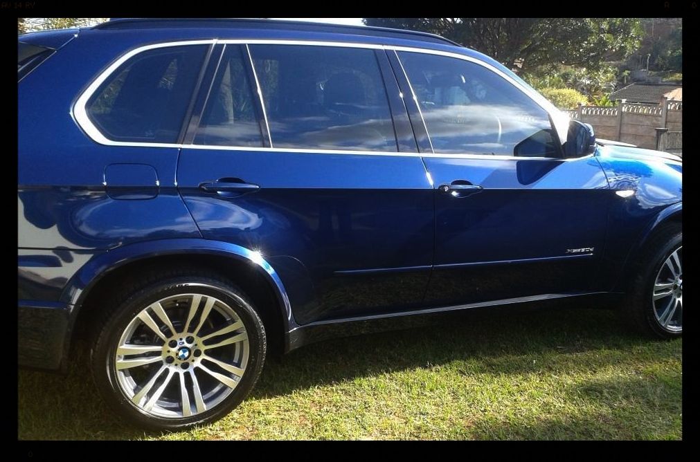

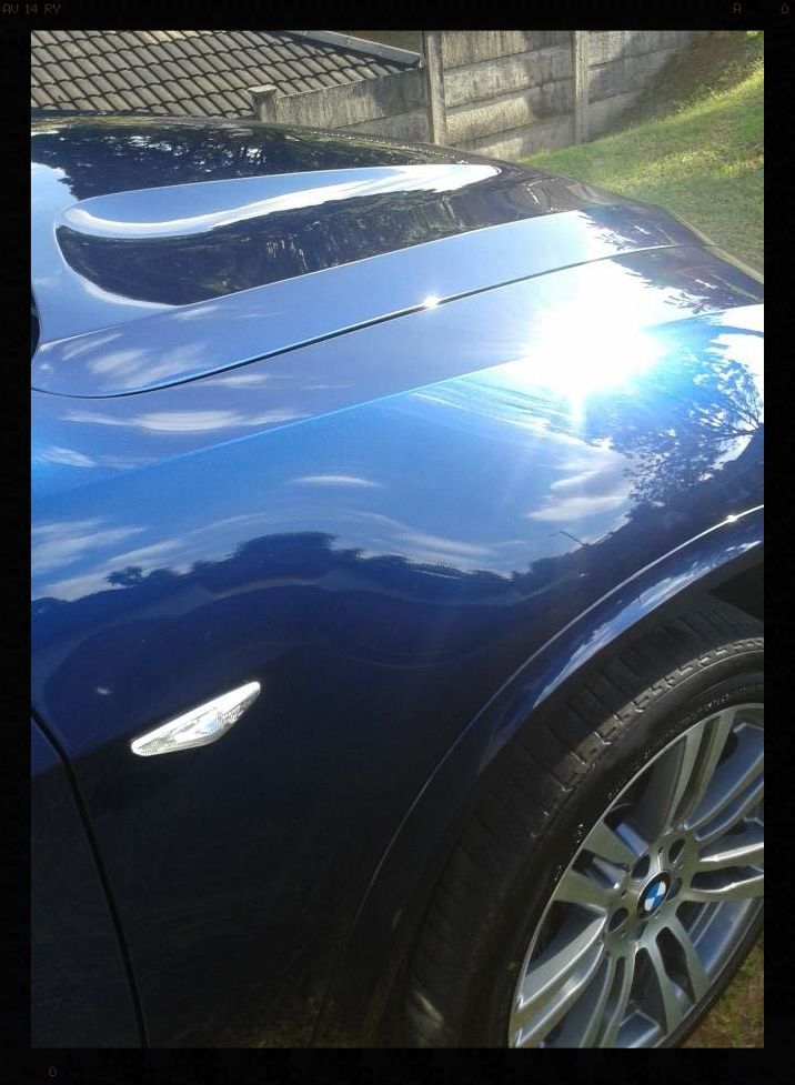

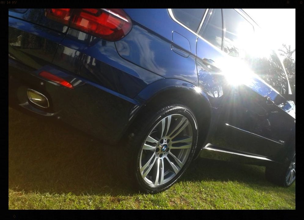

I was busy pulling the car out the garage for some after shots when the owner arrived, so I only managed a quick few.
Here you can see the Tornado Red Golf R I detailed for him in May (http://www.autopia.org/forum/topic/133291-tornado-red-golf-r-detailed-by-lawrence/) in the background
[/URL]

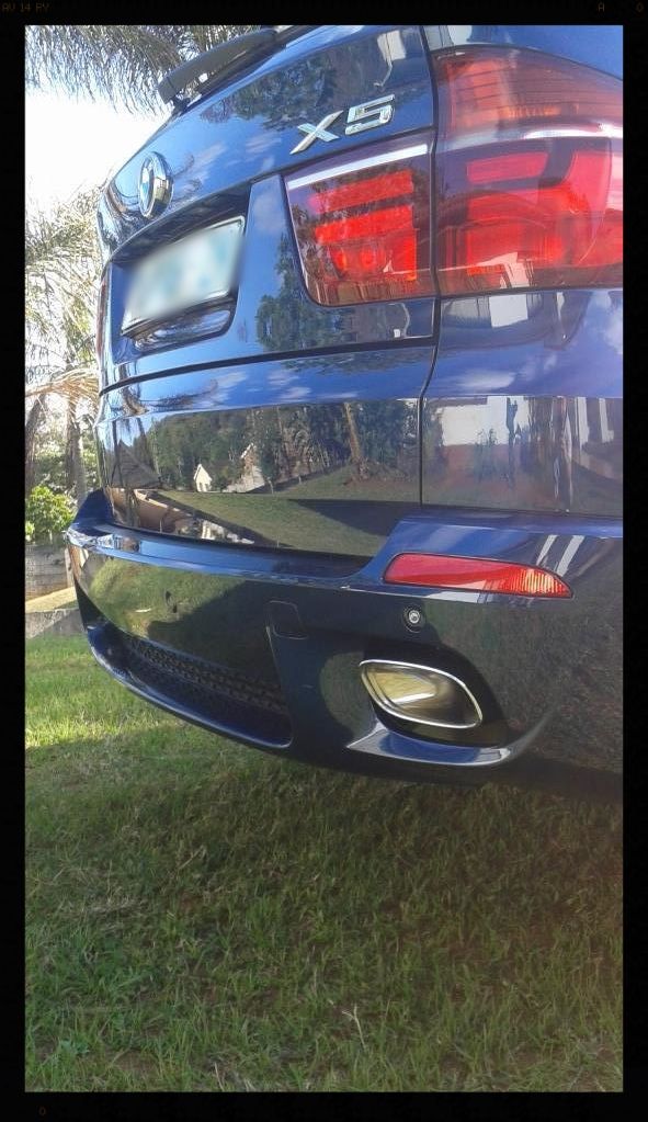

And my favorite pic
Total time spent = 28 hours
Thanks for looking and as always any questions or comments are welcome.
