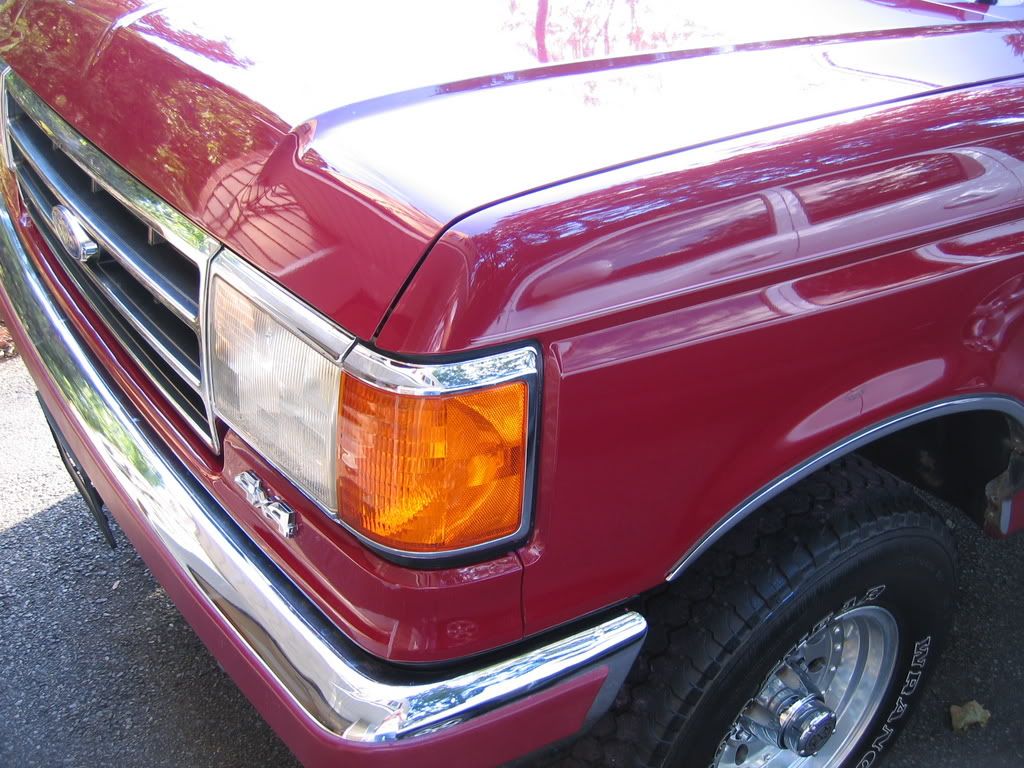

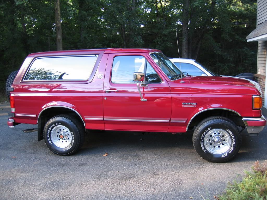

Decided to wet sand the whole truck. (1991 Bronco)
David703
Sorry not really any good before shots..
15yr old Ford paint.. (not great) Hood needs to be repainted due to acid rain and only 2.5 mils of total paint and primer on hood!!!
Wet sanded with 2000 grit. Rotory with Power Gloss. PC with IP. I wanted to leave some orange peal for that factory look since its original paint.
Wow, nice job. Your rear quarter panels look new (most Broncos seem to rust there due to poor design). Have they been redone or is that all original? Great job, the truck looks band new!
The paint looks really good! Those old Broncos can be a pain to buff out, pretty much every one I ever did was horribly oxidized.
How much time did you put into it?
The whole truck took probably about 5 hours. Up close there is still some pitting in the paint, but overall a much needed improvement.
