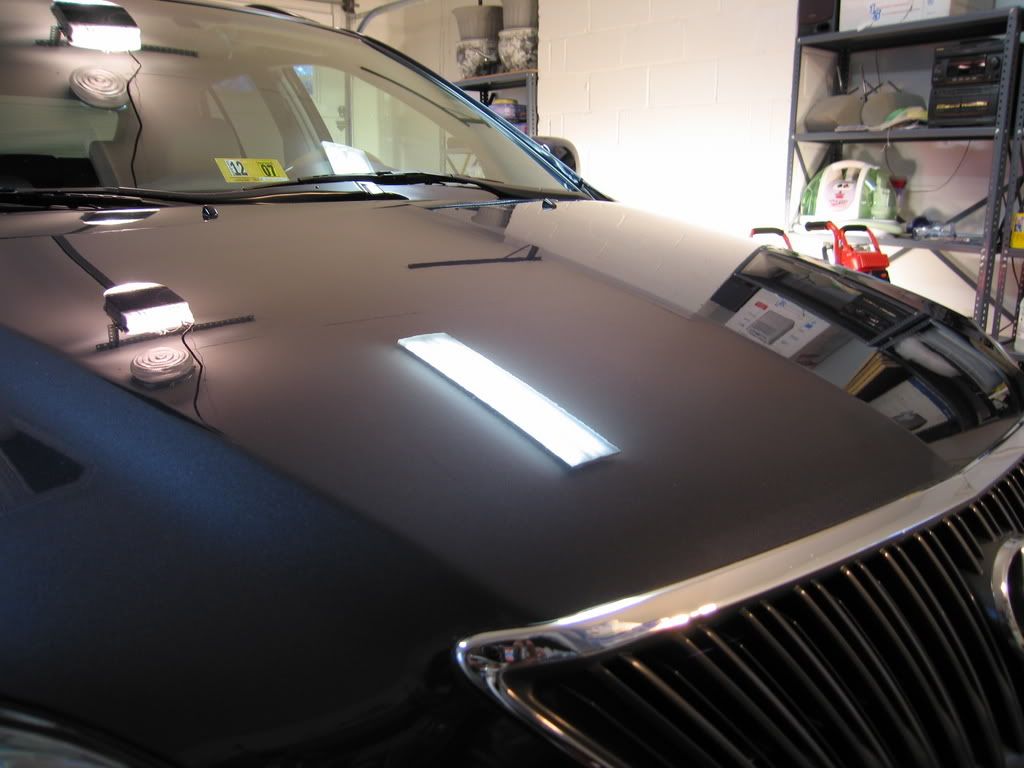

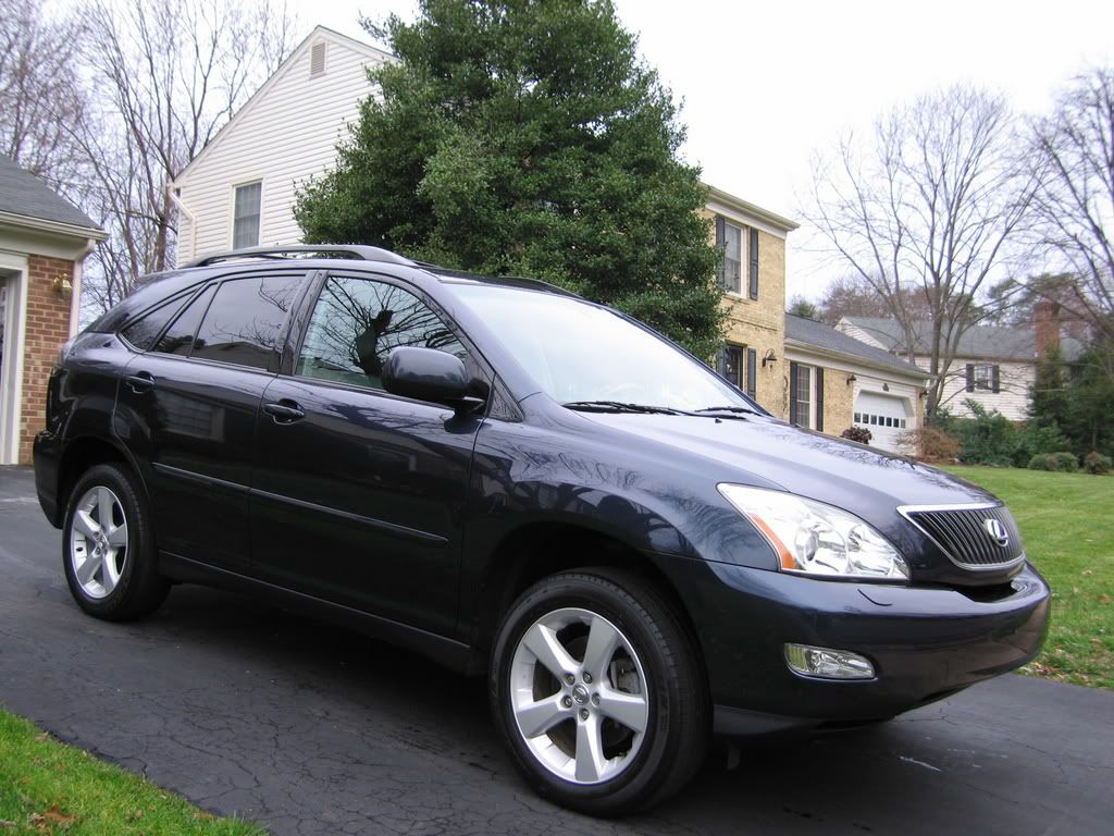

I detailed this guy's 944 last summer and recently he picked up this beautiful Lexus. Of course the dealer buffed it out with a wool pad which he didn't see until next day. Picked the car up at night. Holograms buffer swirls were everywhere. Took me 5 hours.
wash
clay
EC/rotary/yellow ccs pad 1700rpm where needed
OHC/pc/6/orange 7.5 lc pad - entire car
106ff white lc pad pc speed 6 except roof
CG's Extreme Top Coat green finishing pad pc 3
fk1 3108 on tires/trim

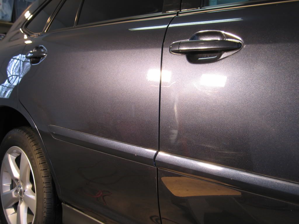

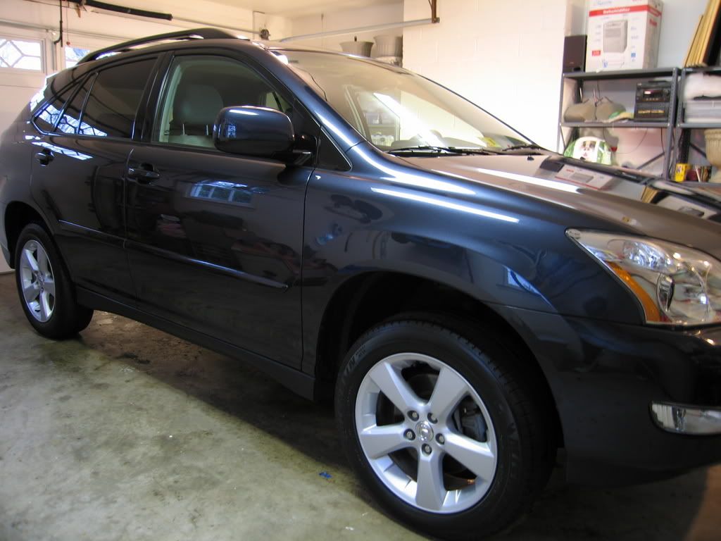

After washing it it doesn't look too bad does it?

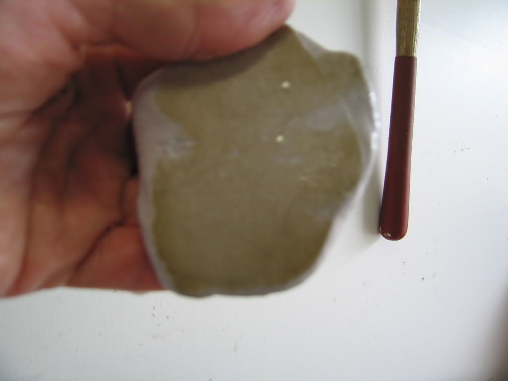

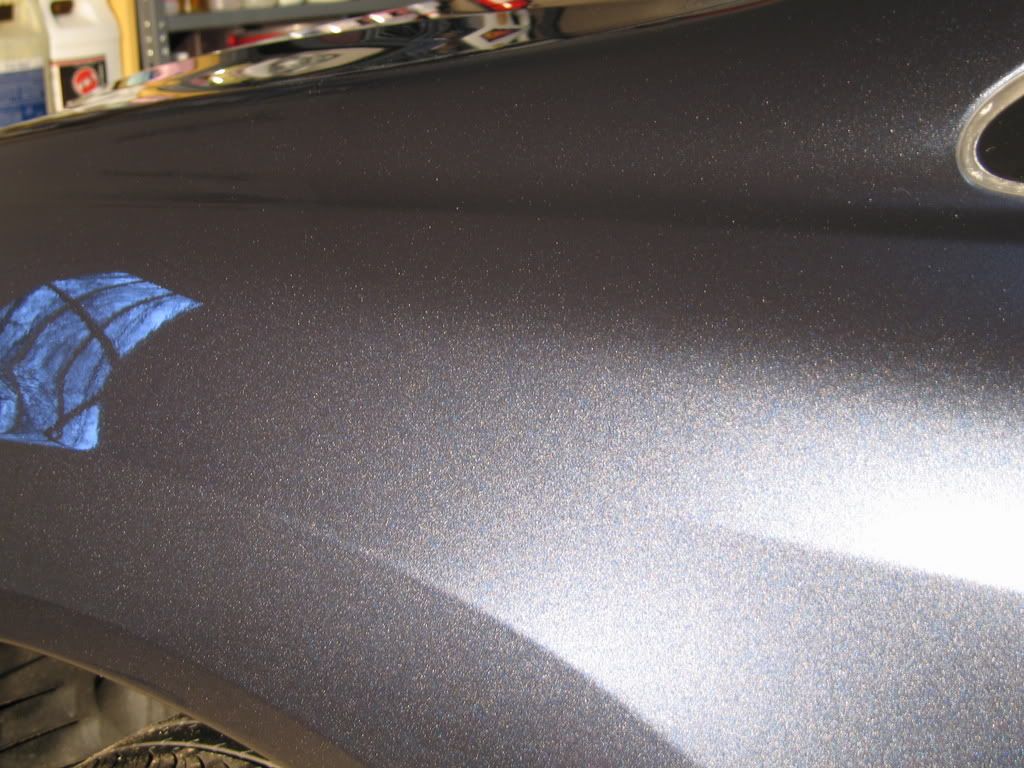

Claying the hood
This should show newcomers why claying is so important. Even a wool pad couldn't remove the contemination

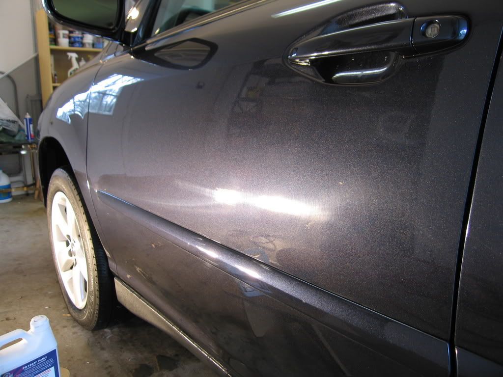

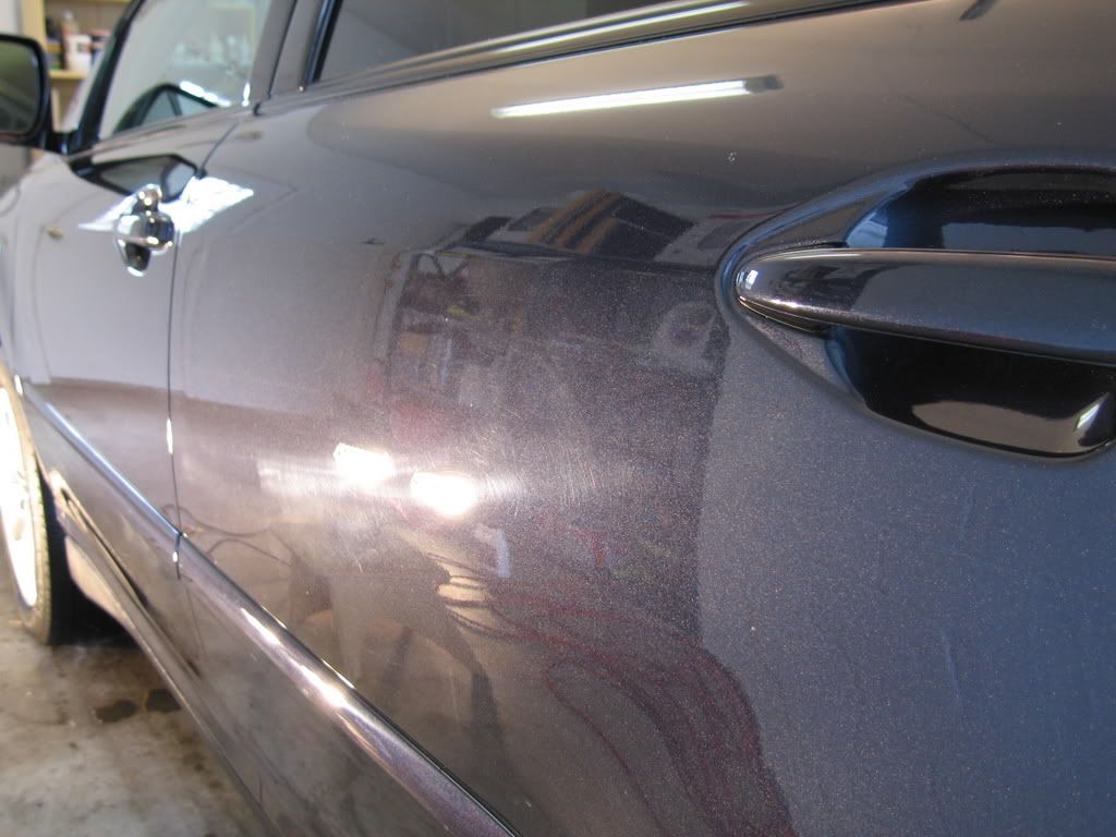

Now this is how the paint REALLY looked.

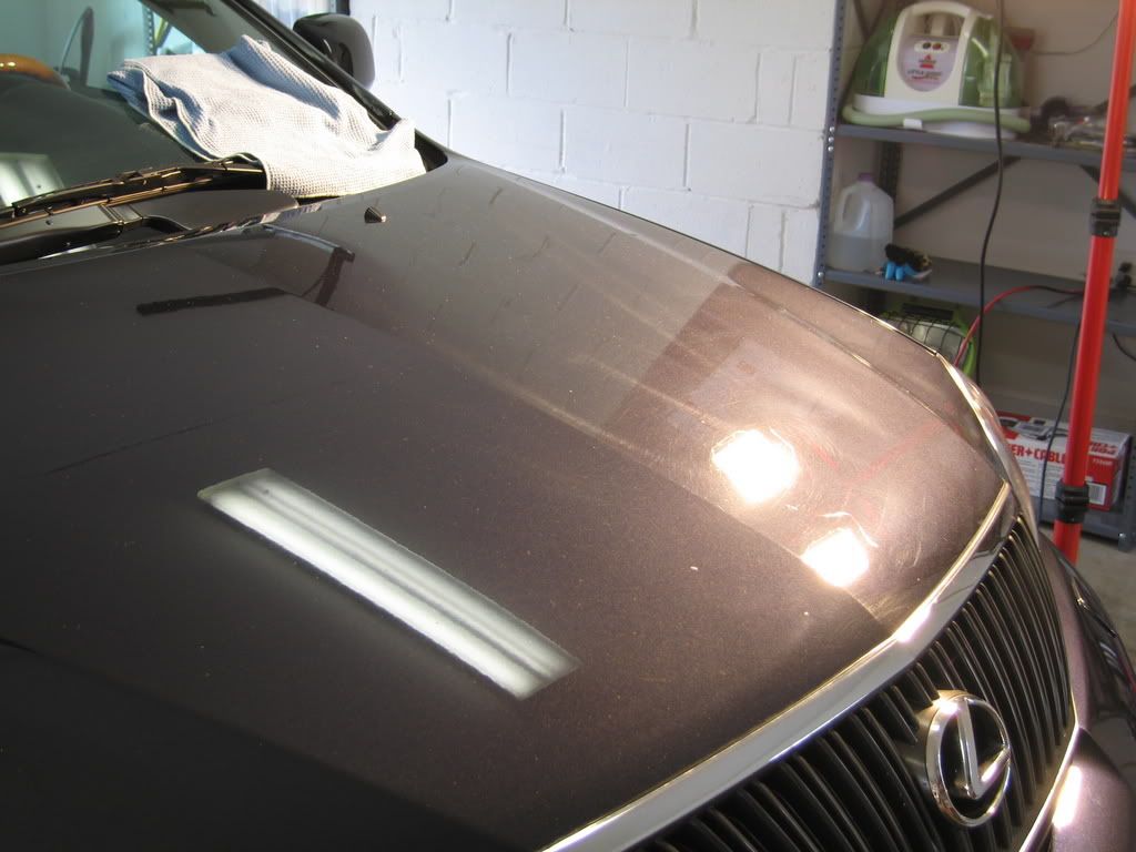

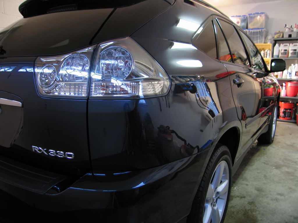

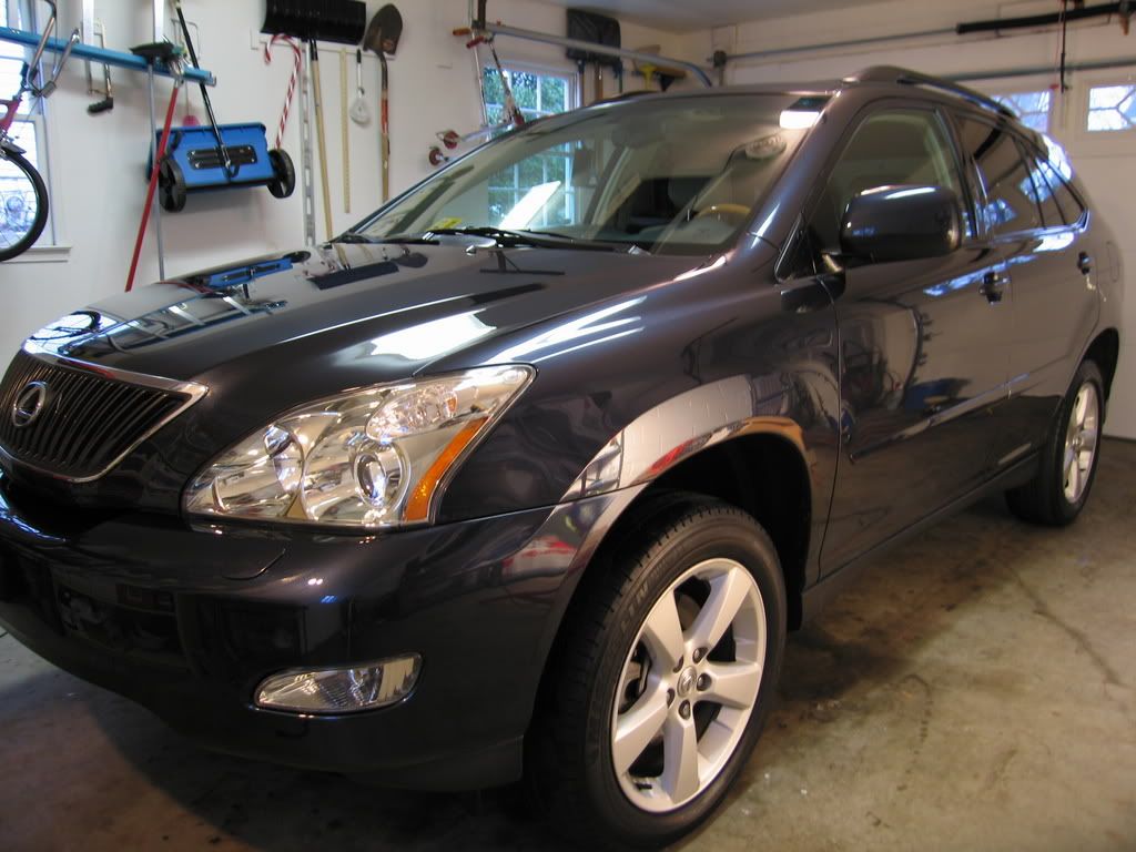

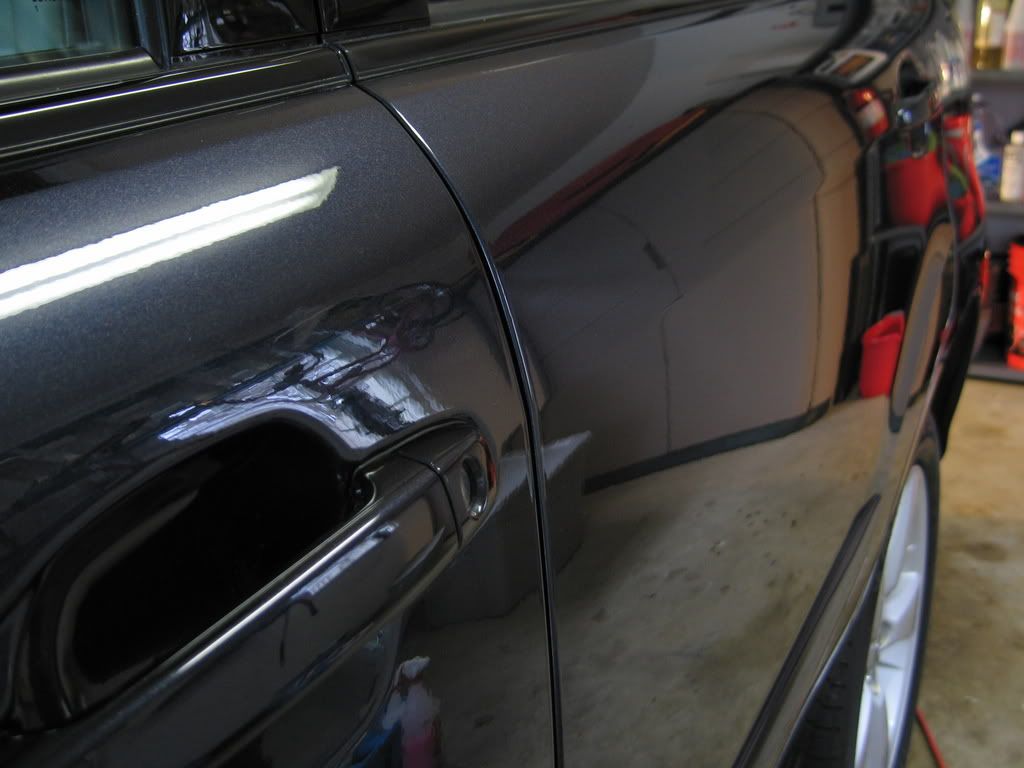

Here is a half & half after compounding
