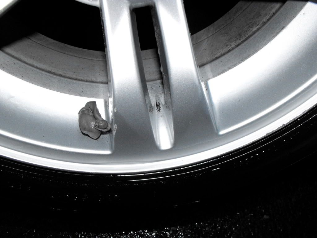

Well i am doing this detail for a family friend of mine who has a porsche 911 and boxster along with this BMW. I donated this detail to the porsche club so he bought it and saved quite a few bucks. Anyways, there is a LOT of contaminants on the wheels. I have already clayed all the places that i can get to. What do i do about this little peice where i cant get it? Anyone ever had my experience? And recommendations?
Yeah, acid is pretty much the only way to fix that. Maybe a dremel buff and some AIO would work, but why go to 3x the trouble for 1/2 the results. BMW wheels are cc'ed for a reason, I think.
Wheel brighteners are usually acid based. Plus, there's also some high alkaline cleaners that work great too. Their benefit would be that they don't require neutralizing like an acid.
Try some WD-40 to loosen it up, spray let dwell and go in using Q-tips , follow with some 3M adhesive remover if possible with a cotton rag and scrub like hell because it disolves very quickly. Ive found that even Megs agressive red clay doesnt do much on tough brake dust, especially BMW brake dust. Wheel Brightener is a good product also, I always said I would never use an acid based product but sometimes its what you need to get the job done. If the wheels arent scratched a strong mix of 4:1 should help, rinse very well after.
