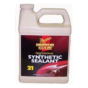

Let me digress a little: I use D151 for my cheaper packages, I either do 151 on its own with a orange LC pad for my cheapest, or do 151 on an orange LC and follow up with #21 sealant on a black for my middle of the road package.
Back to the topic at hand: is there any reason I shouldn't ditch my 205 or similar polish and use D151 between my 105 and LSP? D151 has more cut than 205, but finishes LSP ready, it's way cheaper, smells nice, and using D151 + your LSP will give you two layers of protection over just one. I've never heard of anyone having problems topping 151 with #21 sealant.
