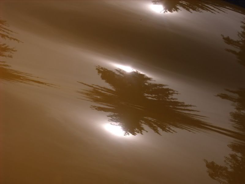

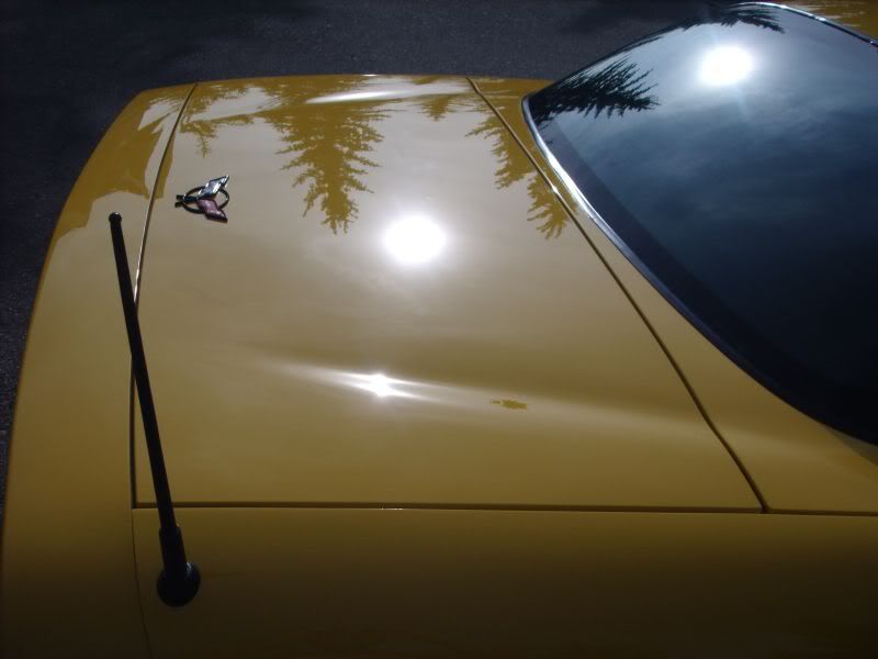

I was itching to use my gloss-it products on my z06 - previously, it really laughed at my attempts at correction. I mean, the results were good (like 85% autopean standards), but always left me frustrated that I'd spent 7hrs on it and it wouldn't be perfect.
But wow, the gloss-it products really do seem to work well with the cyclo.

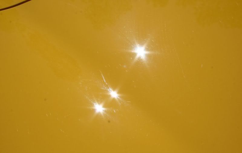

It had the standard RIDs and a few scratches here and there. Biggest problem were the RIDs, since my old method (orange/SIP, green/106) didn't do that much for them without needing several passes.

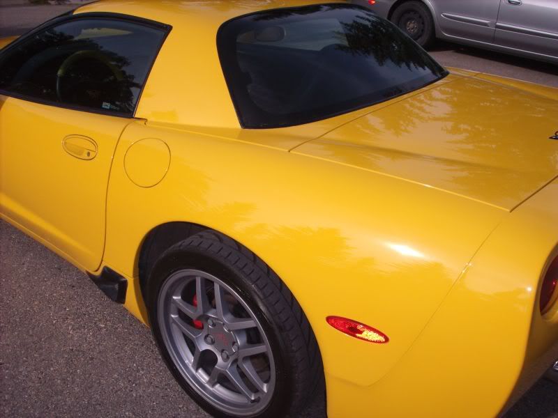

The after it is with just 1 pass orange/extreme cut, and 1 pass green/evolution polish (then sealed with optimum poliseal and wax with pinnacle soverign)
Conclusion - (and i hate always writing this because I sound like such a shill, lol), but gloss-it, imho, is the best product line i've ever used on the cyclo. Much better than Meguiar's, 1z, optimum, and Menzerna, on the cyclo.
