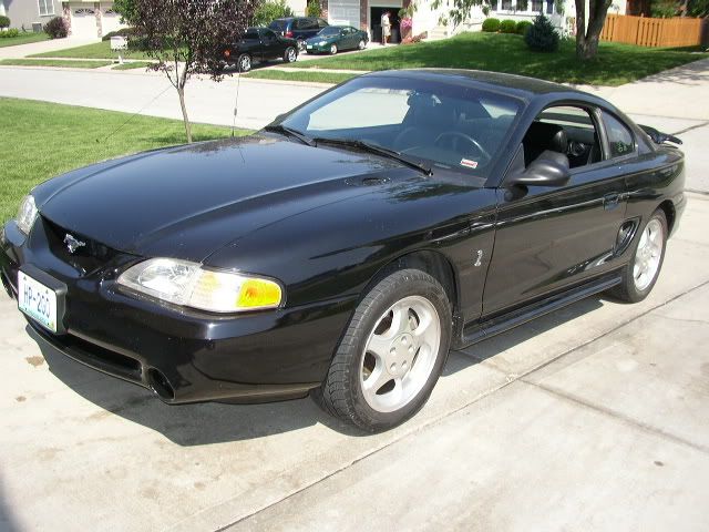

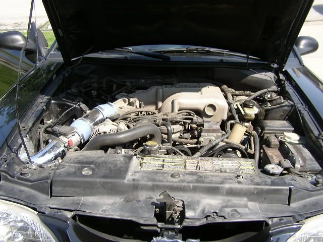

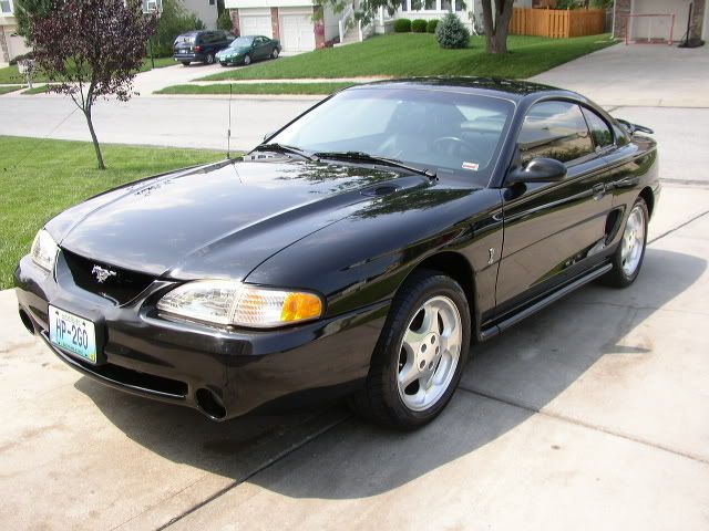

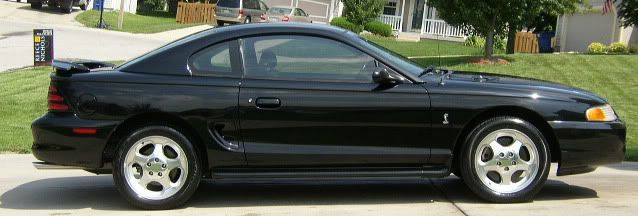

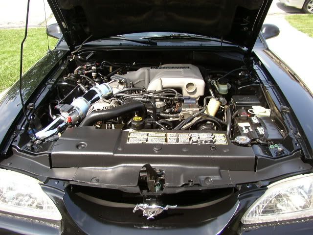

Lady called me last week. Said her husband had a Roush and she has a Cobra. She decided to have the '95 Cobra done.
Here are some before and after pics...
Procedure....
1. Complete interior wipedown with Simple Green/water/Microfiber towel
2. Treated all vinyl surfaces with 3M "Refresh"...
3. Treated all Leather with "Zaino Leather in a Bottle"
4. Vacuumed carpet & treated rubber with Mothers Back to Black
5. Cleaned interior glass - 20/20 Glass Cleaner
6. Cleaned engine with Simple Green/Water/Tire Foam
7. Cleaned trunk / treated rubber Mothers Back to Black
8. Exterior wash with QEW
9. Washed wheels/tires/wheel wells with Eagle One A2Z & water
10. Clay barred - Meg's detail clay
11. Applied 3M Swirl Mark Remover
12. Applied Zaino Z2/Zfx (times 2)
13. Finished up with Z6 (times 2)
14. Dressed tires with Meg's Endurance
5 hours
