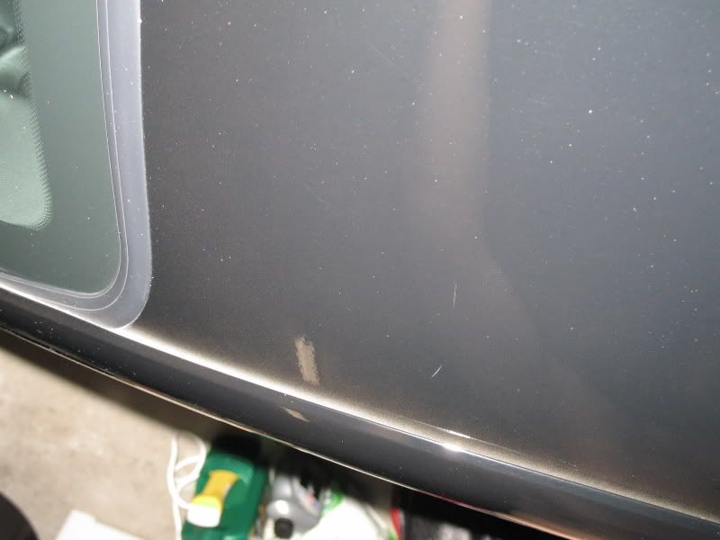

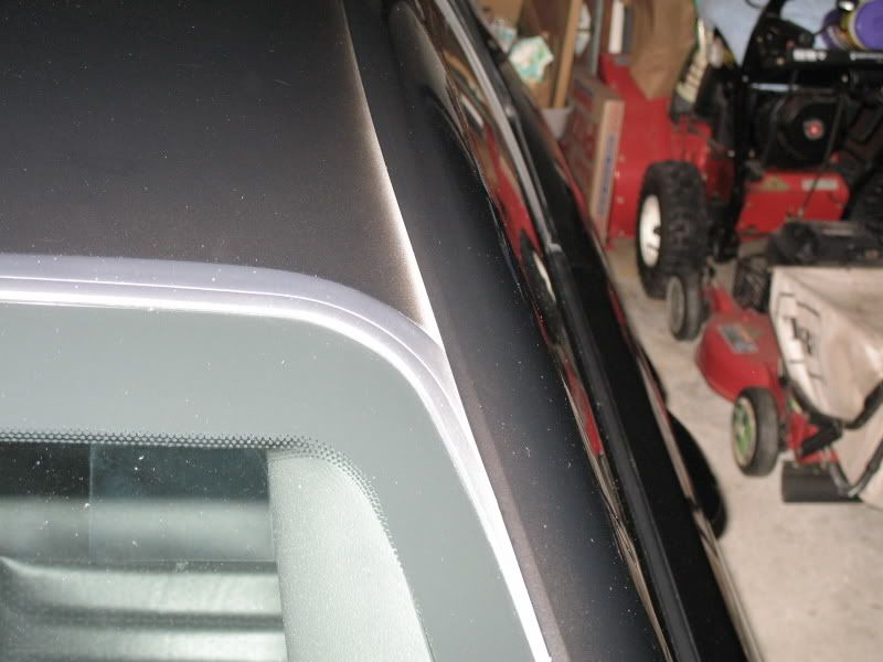

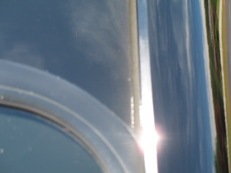

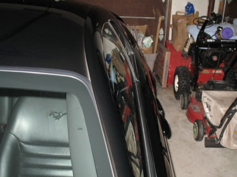

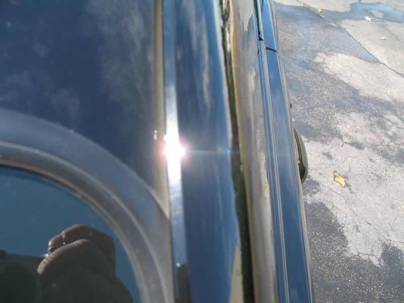

Ive been noticing it for a while but it seems to be getting progressively worse. I KNOW this car has been repainted before and they didn't even tell me before I bought it BRAND NEW off the lot with 40 miles on it. It really urks me that the roof clearcoat/side pillar clearcoat is already starting to fail.
Now I know that various body panels of this car have been repainted because under the sun some panels look black with a hint of brown to them.
Anyways you can see the clearcoat here failing, it looks brownish

And can you please take some more pictures(maybe from a longer distance) because all I can really see is brown/brown trim/waterspot looking things, and the more pictures the better other members can comment as well.

I noticed its been repainted about a year ago. I was taking pictures and the lighting from my camera is good at showing different colors. The whole car is black yea, but under the light it has a brown hue to it. Even other people just standing around it can tell its been repainted. Should I go to the dealer? If so who should I ask for?

I think Mustang roof drip moldings are painted by suppliers, not on the paint assembly line at Ford. They get delivered to the assembly plant (Ford Rough Plant) and get snapped on after the body gets painted. It's pretty cheap to have these moldings repainted.
What makes you think your car has been re-painted? If it's because the moldings don't match the body, that's normal. None of the trim on cars do.

I can't exactly understand what is going on there, but if it is an issue at the edges of the roof...many Mustangs (I have an '03 Cobra) have very light paint in that area. It looks like it was sprayed too dry.
If I am looking at these pictures correctly, the paint looks lighter at the edge of the roof where the pillars meet the roof. This is exactly what my friend's did, and Ford paid for the roof repaint.

After you clarified this, I went over the pictures again and made a mistake on the location of the problem. Sorry. I thought it was on the trim next to the roof. Here's what I've experienced on 1 of my Mustang's in that location. By the way, that trim piece is painted basecoat/clear.
What strikes me as odd is that it's gotten worse over time. The brown really looks like the primer that wasn't covered with enough base. That shouldn't bleed through more as time goes on? I've seen alot of cars with similar condition. The only way to fix it correctly on this vehicle is to remove both the front windshield & the back glass and also both trim pieces on each side so that there won't be any shabby tape lines. That sucks.
