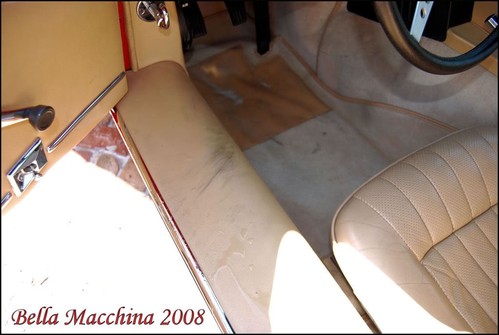

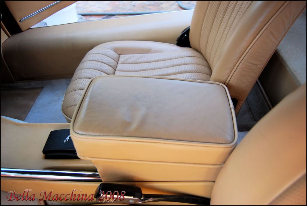

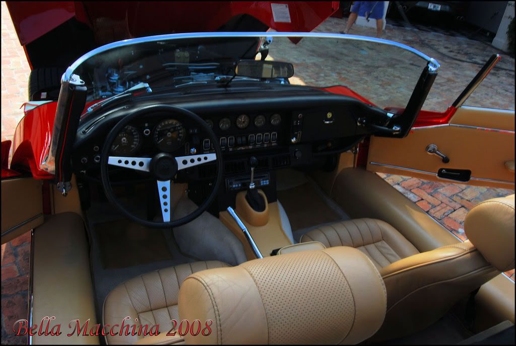

Some before pictures of the interior. The original carpets had 34 years worth of stains and grime and the leather was in need of cleaning.

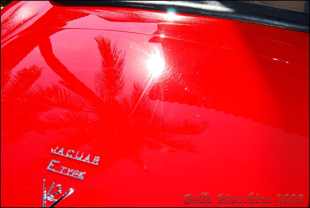

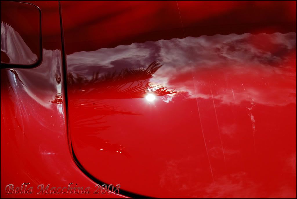

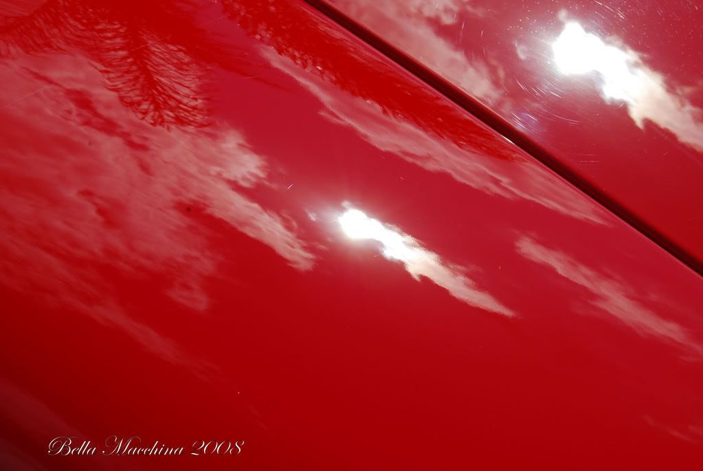

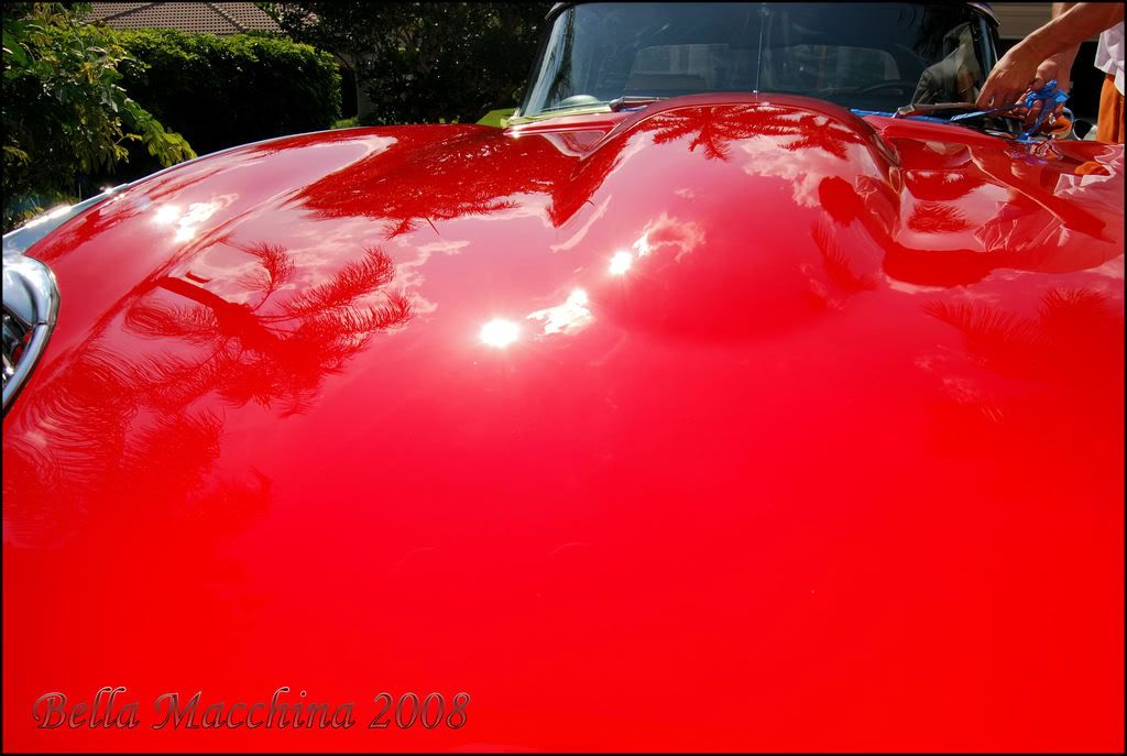

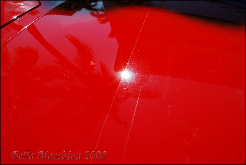

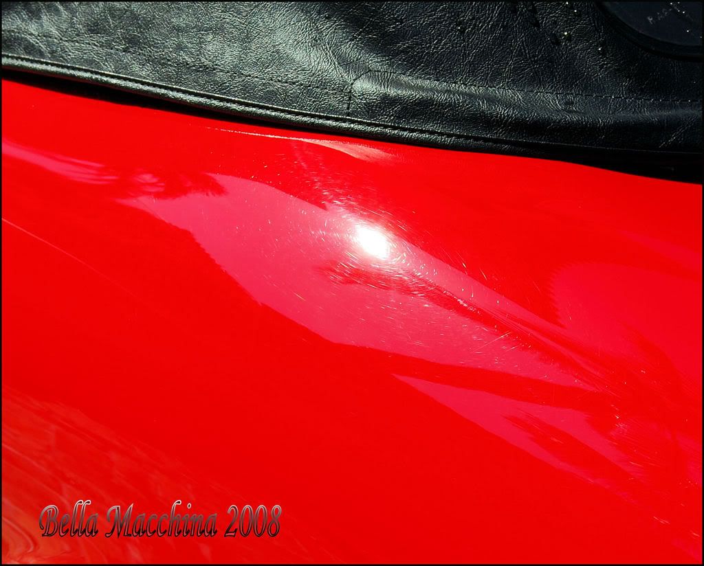

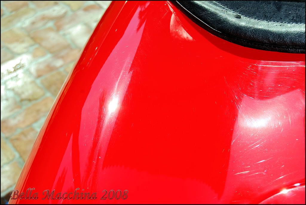

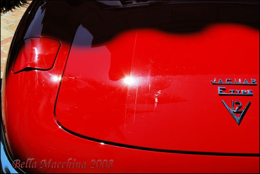

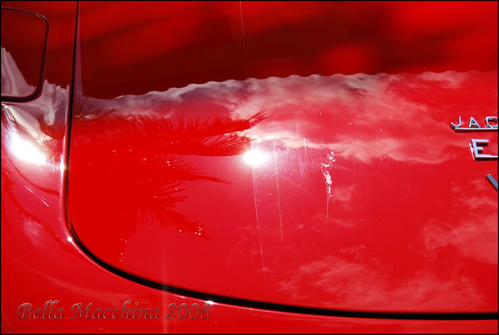

Initial inspection of the paint revealed significant marring.

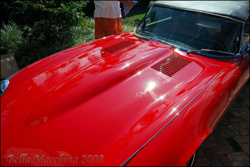

50/50's working toward perfection. Given the initial gloss and color of the paint I was pleasantly surprised to see how much improvement could be made.

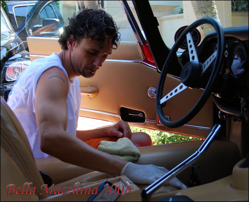

I had Brian apply Leatherique to the interior leather surfaces and massaging a liberal amount of Rejuvinator Oil into the hides by hand.

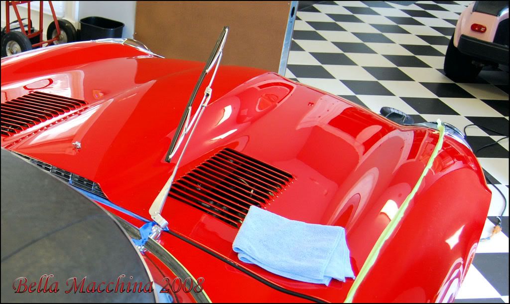

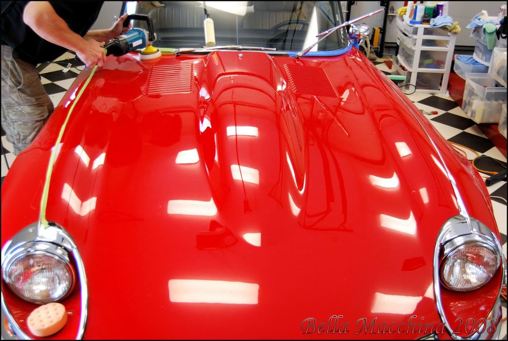

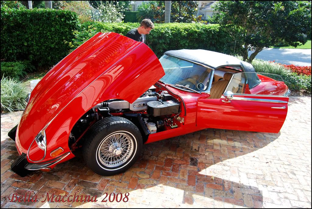

Some pictures of us polishing. Most work was done inside the garage, although we where able to polish outside in the early morning. By 11 AM the sun was over head and the temperature was climbing past 90 so we had to bring it in.
When Bella Macchina perfects paint, we do not miss any spots. Perfection is only complete when every area of the paint has been brought to its highest potential, no matter how small the area or insignificant it seems.

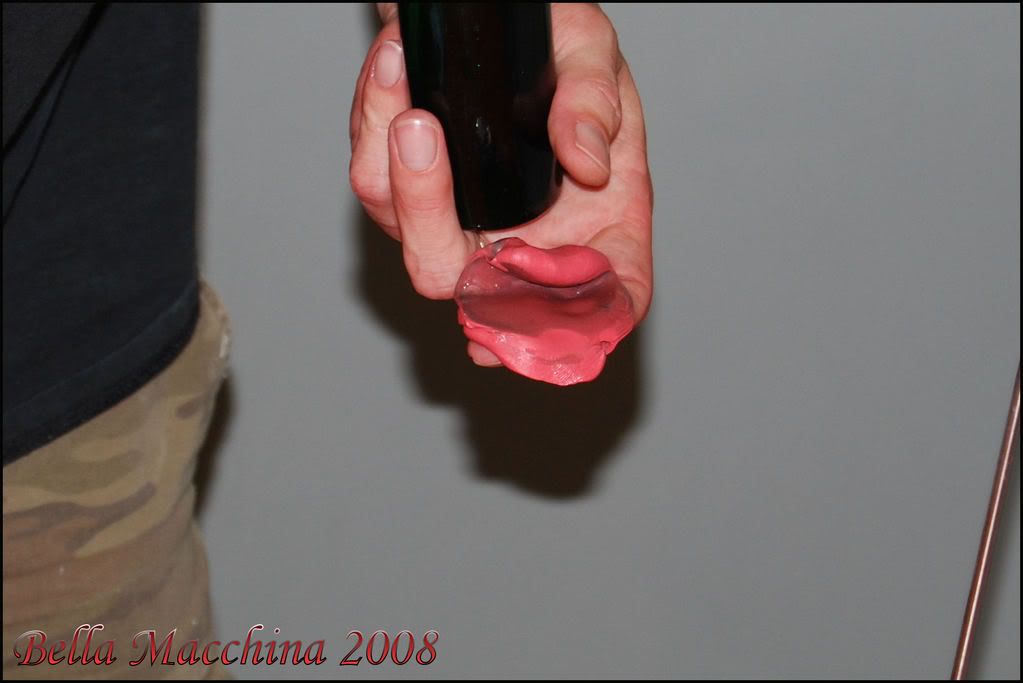

Here is a picture of Zaino Z18 clay after being used on the rear window (which is original and had 38 year's of grime, soot, and nasty stuff on it). I love this picture because the clay resembles The Rolling Stone's lips logo.

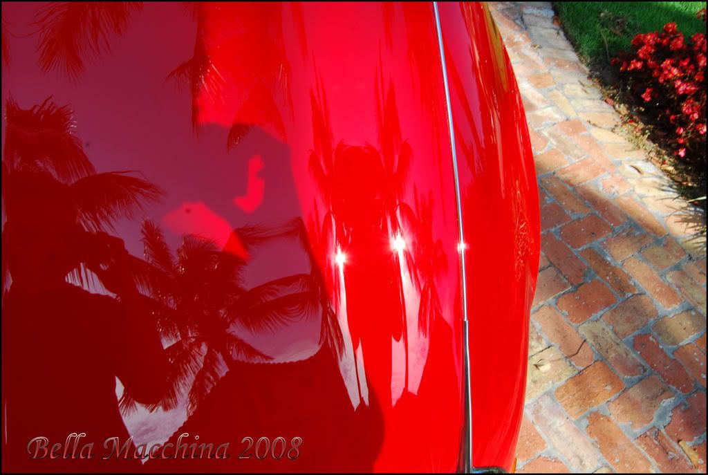

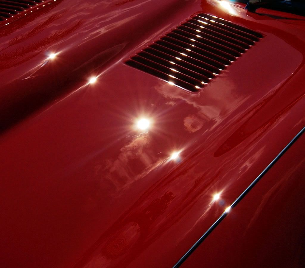

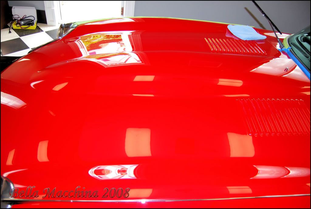

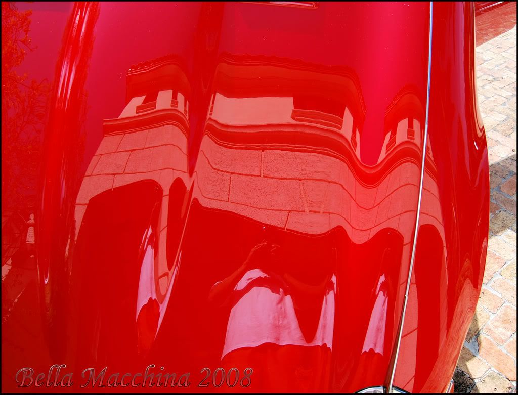

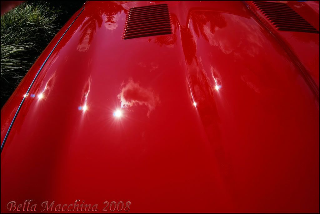

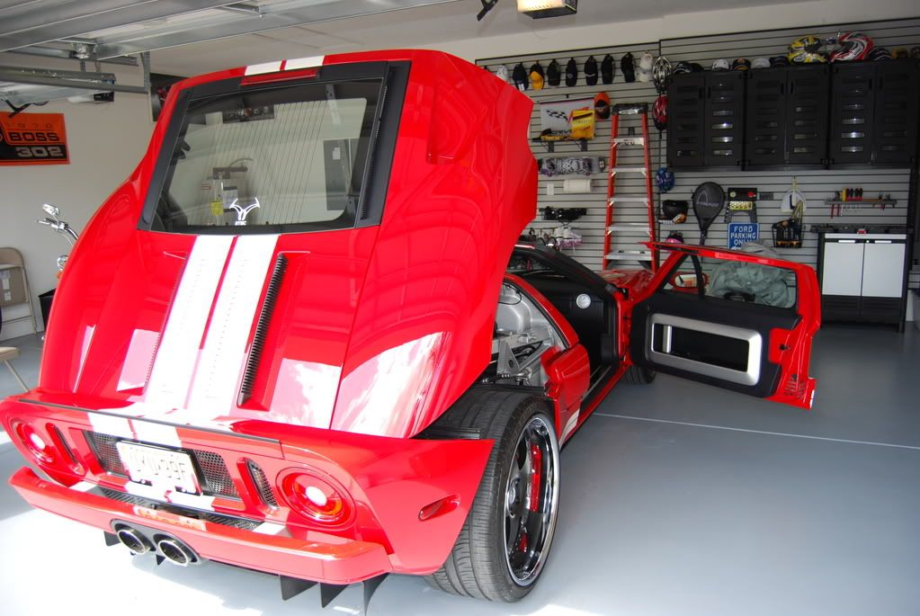

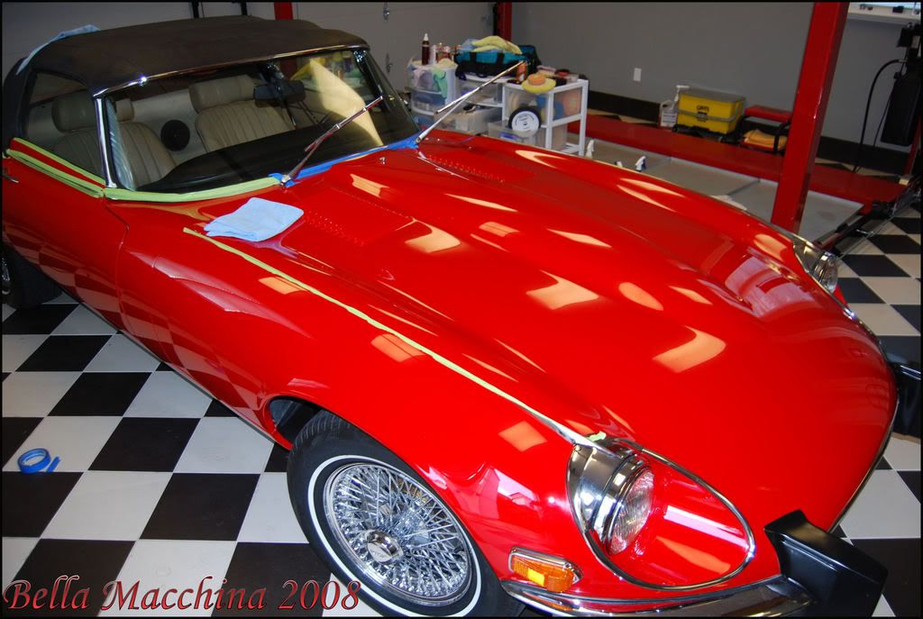

Some pictures inside the garage, after all the polishing has been done and the reflections are at their sharpest, courtesty of Bella Macchina and Menzerna's P085u.

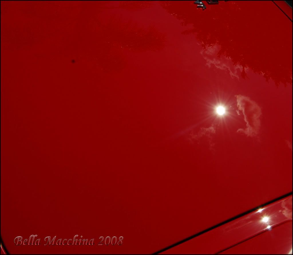

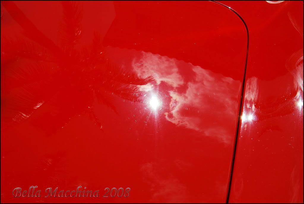

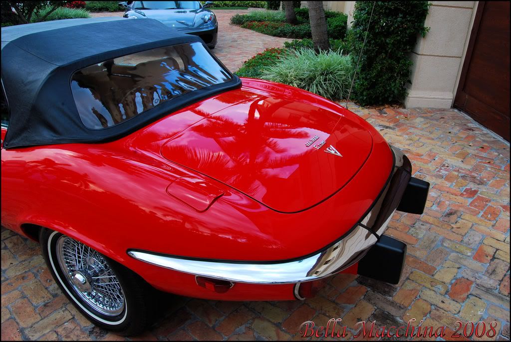

After polishing we drove the Jaguar back outside for a wash and to inspect for any swirls.
Some area's with RIDS where identified then repolished. Then we washed the car and snapped some more pictures.

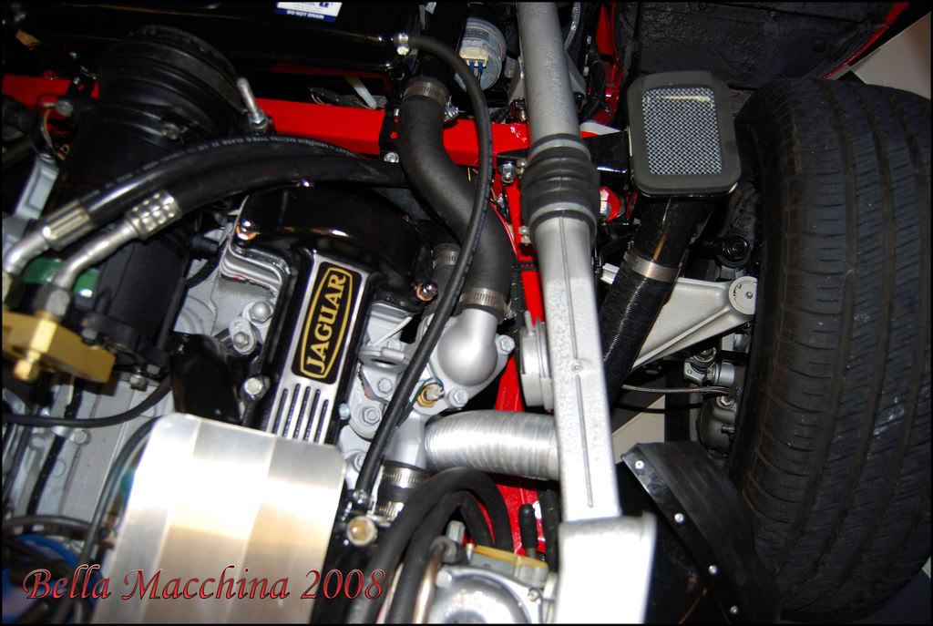

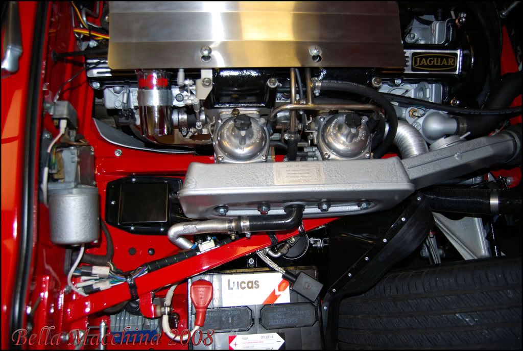

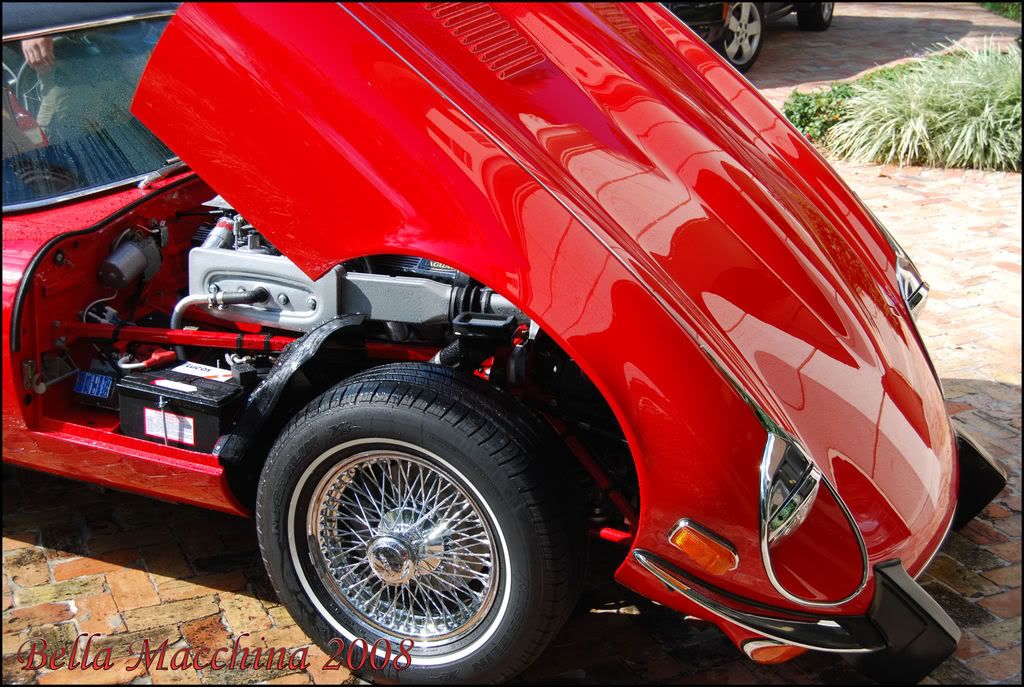

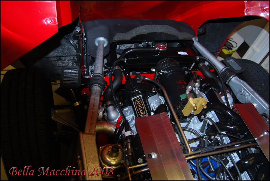

The engine compartment was very clean to begin with so I did not take any before pictures. However a lot of hand polishing went into the various metal parts, the frame rails where hand polished and waxed, the various rubber's recieved various dressing, etc...

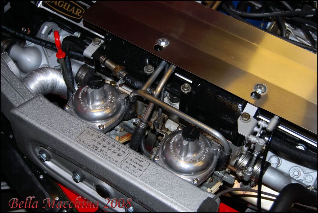

The Stromberg carburetors took at least 25 minutes a piece of hand polishing to restore the original shine.

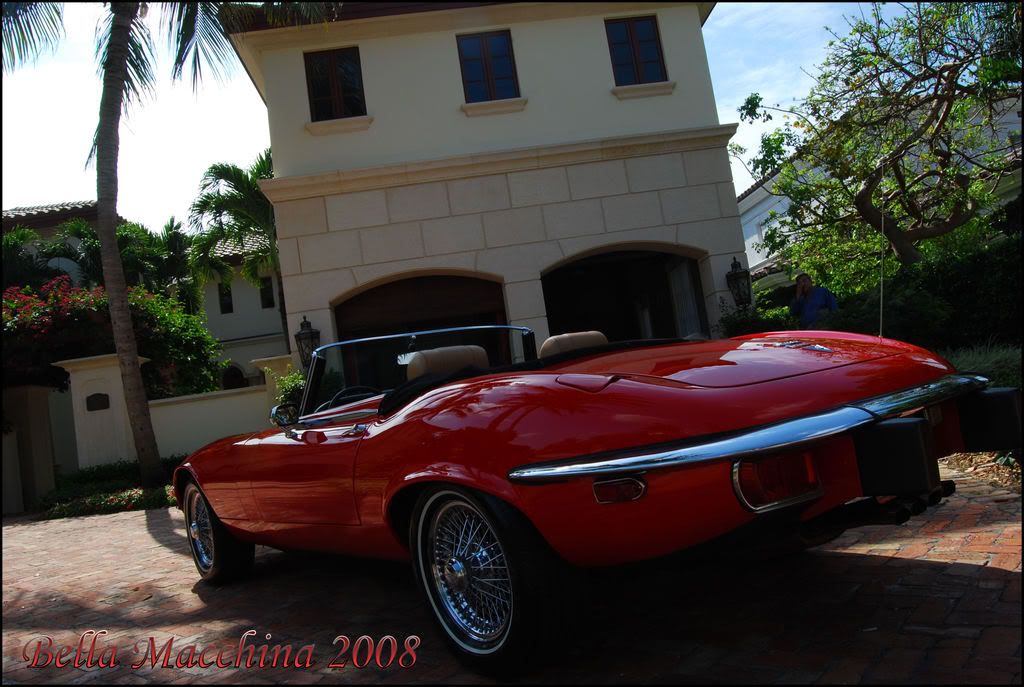

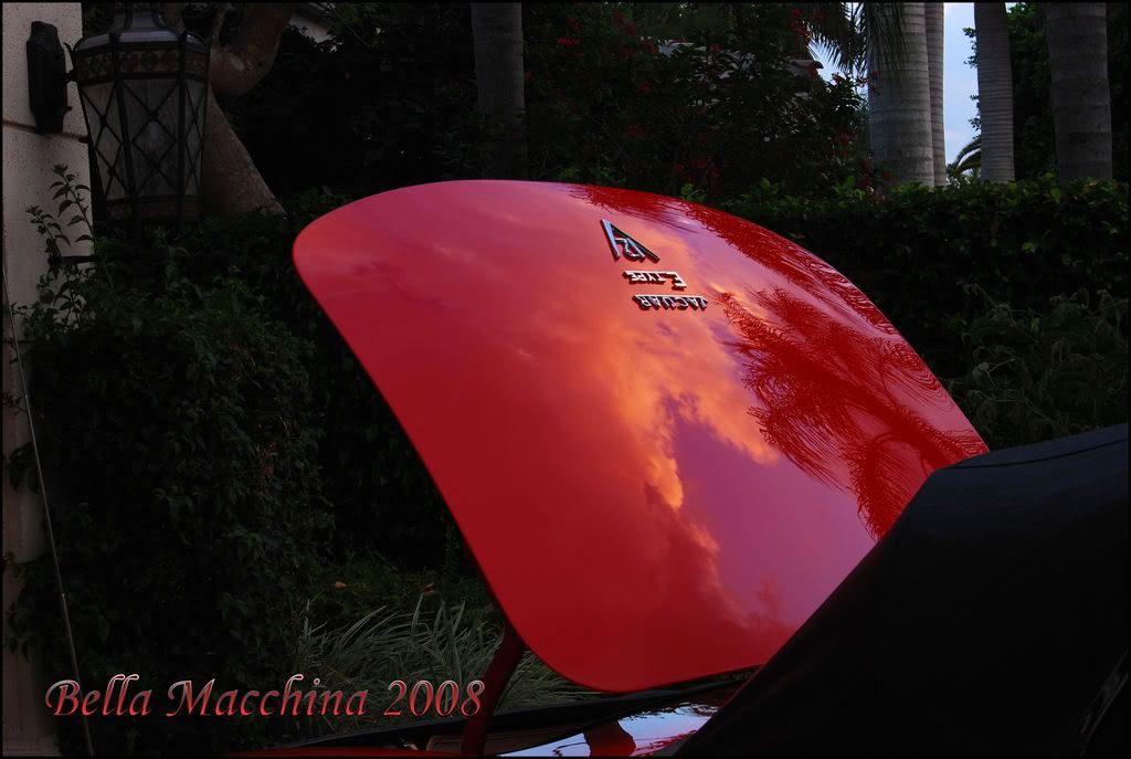

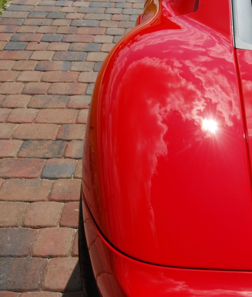

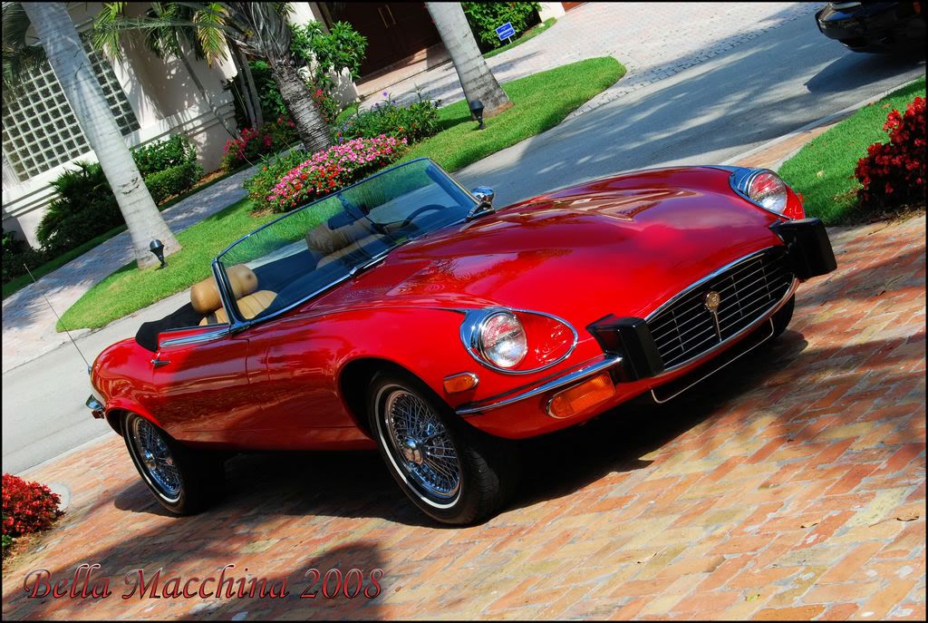

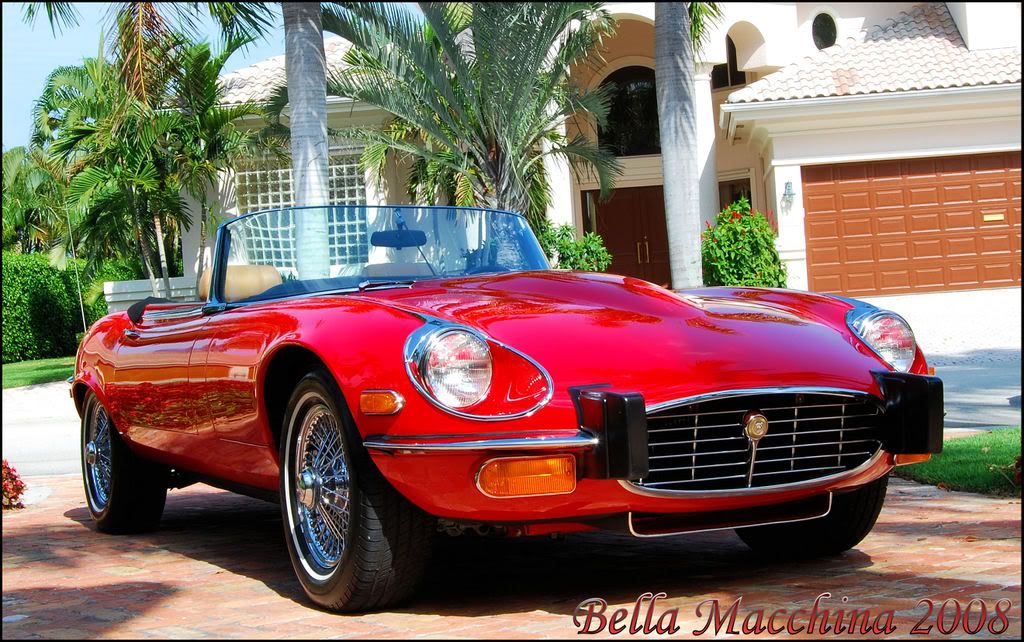

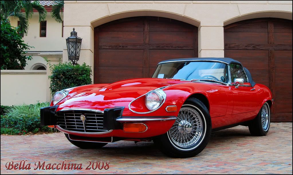

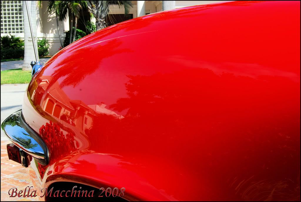

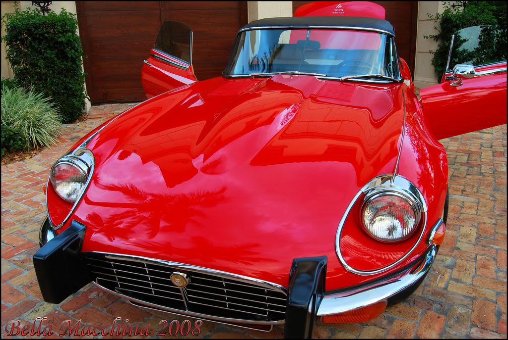

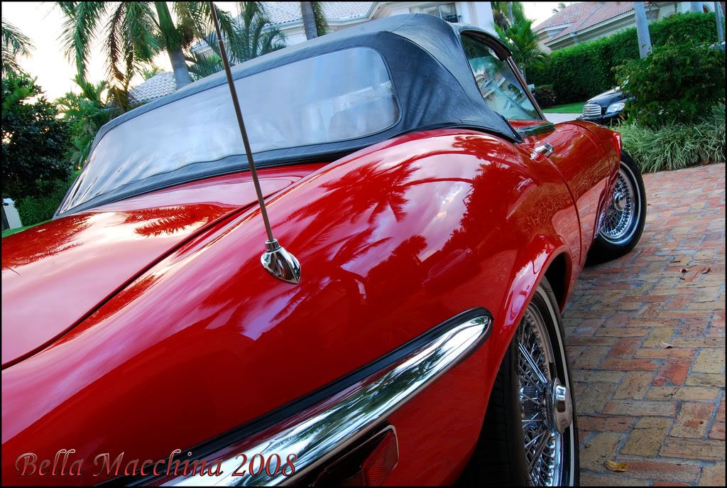

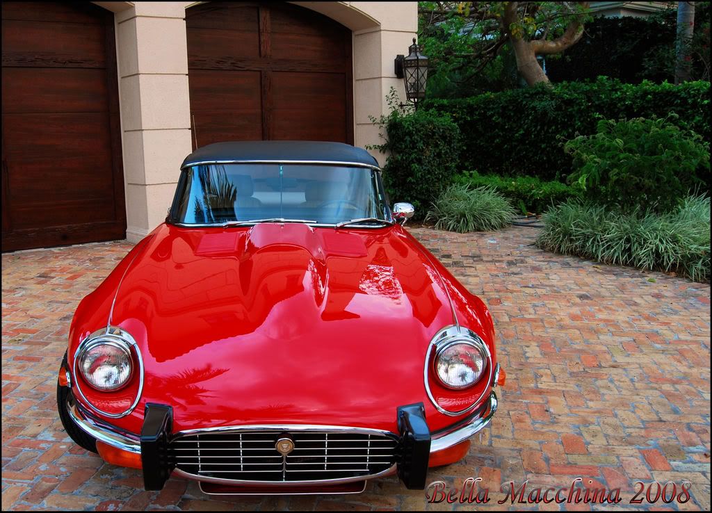

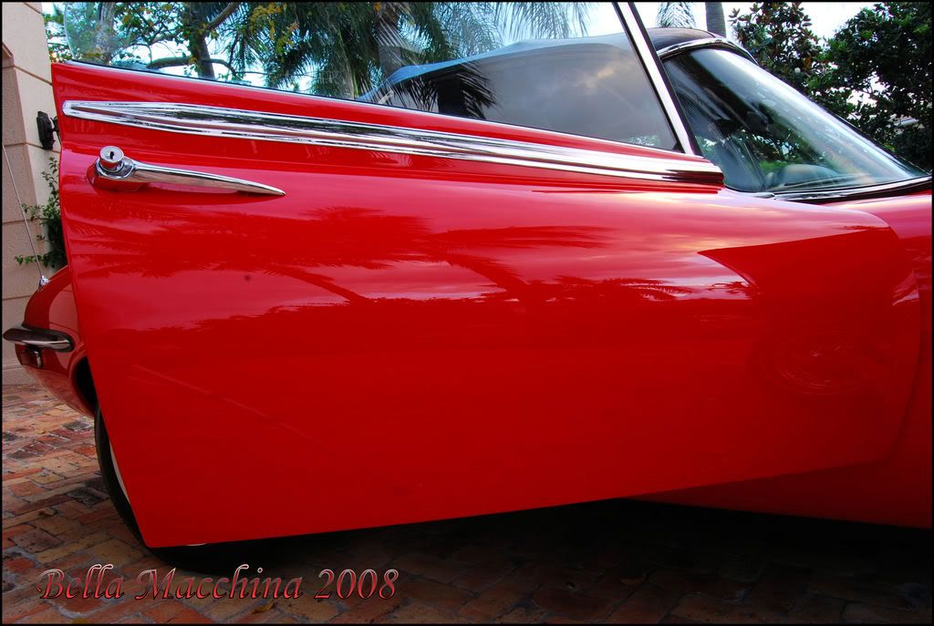

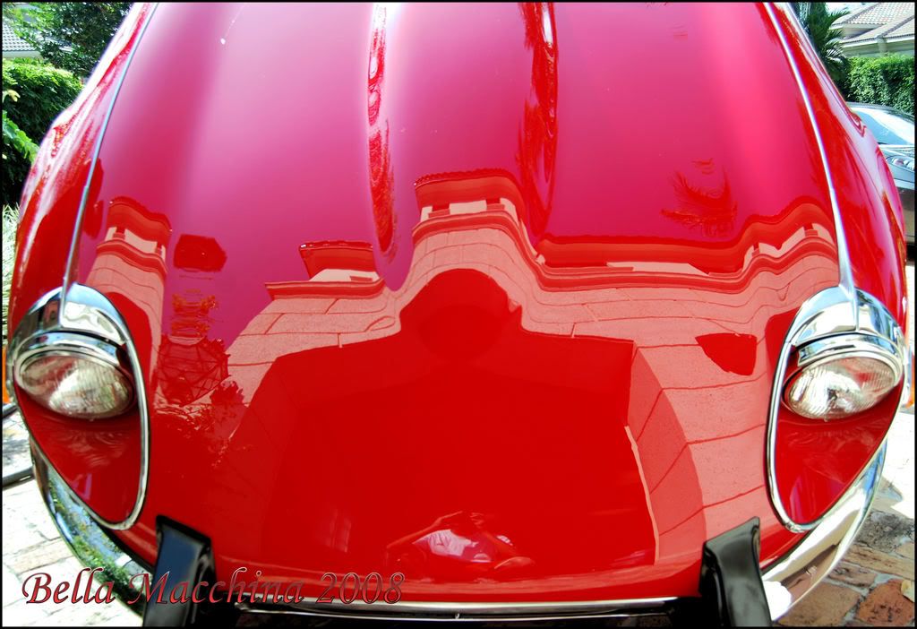

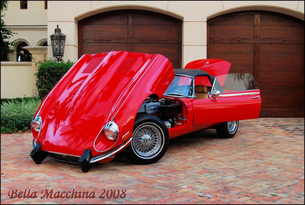

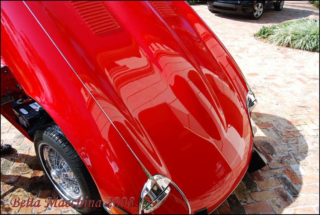

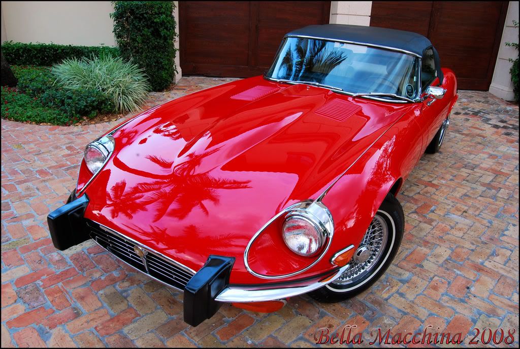

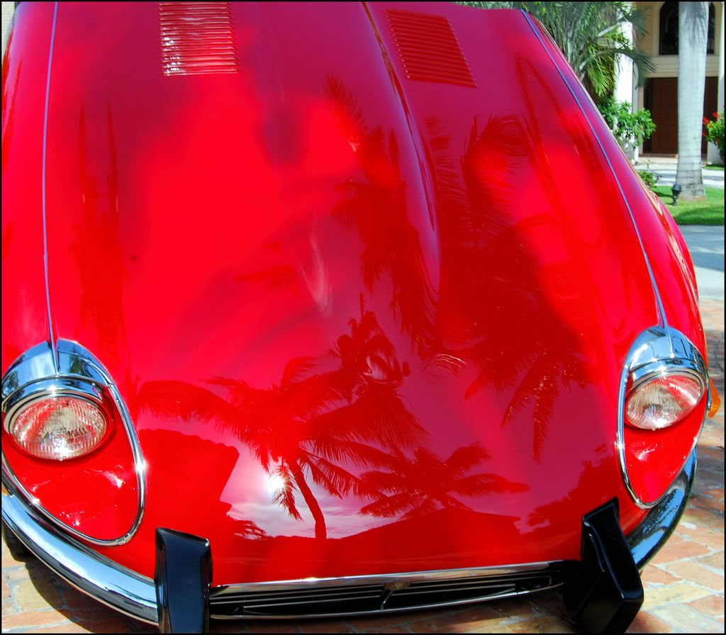

With the sun going down we took some pictures of the cat outside.

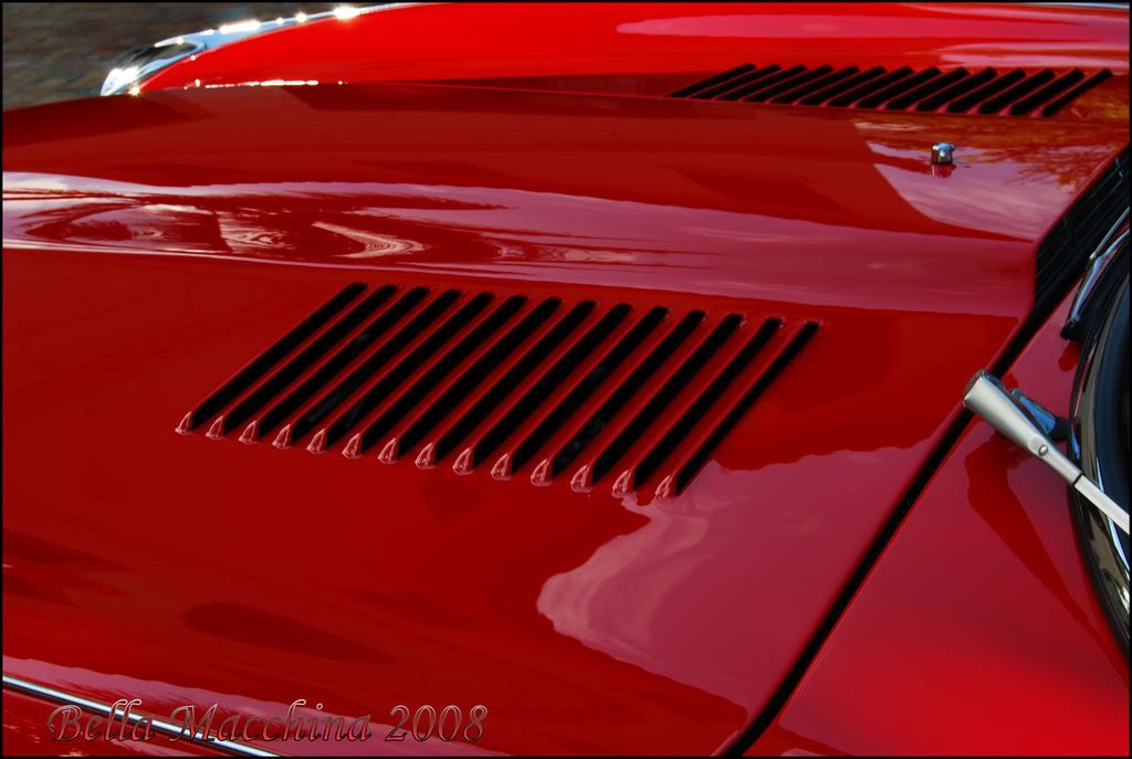

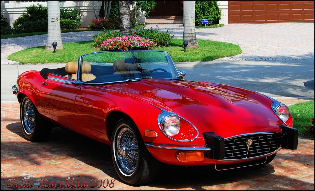

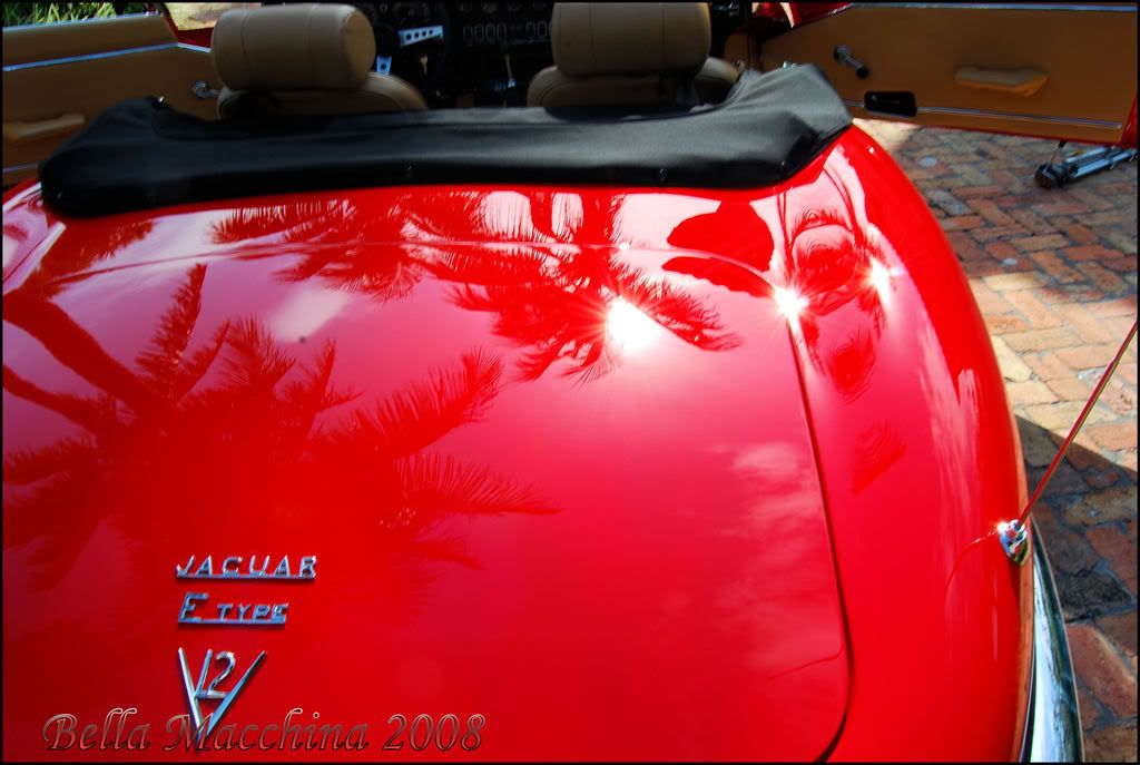

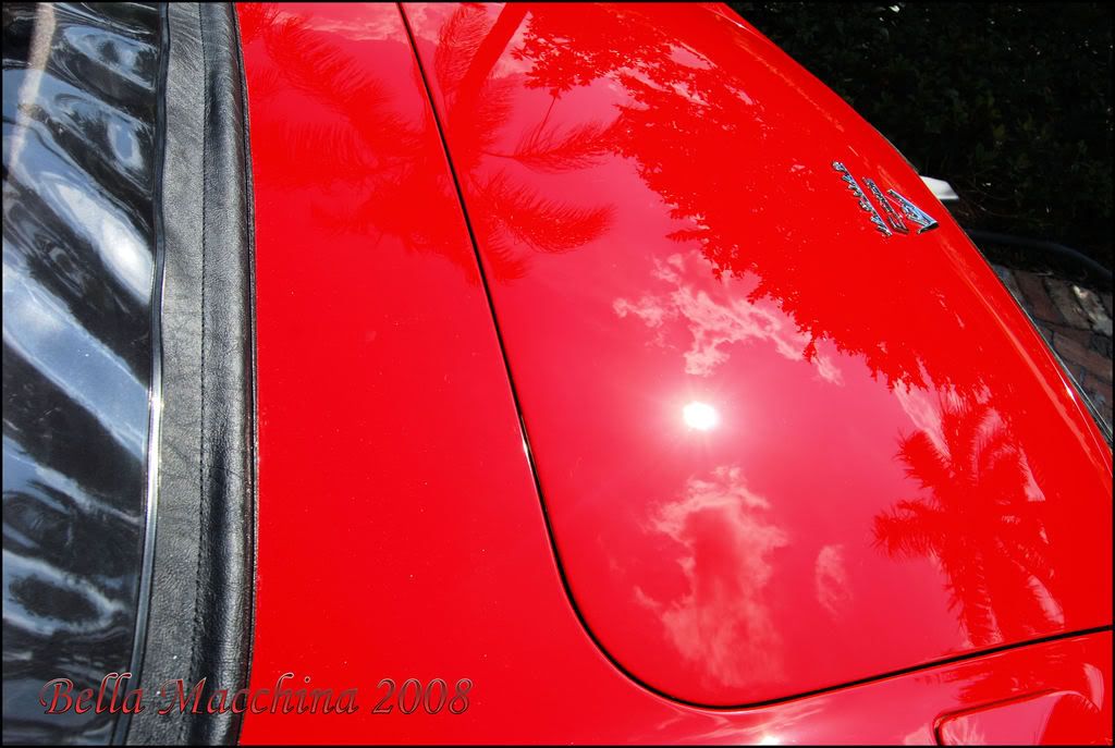

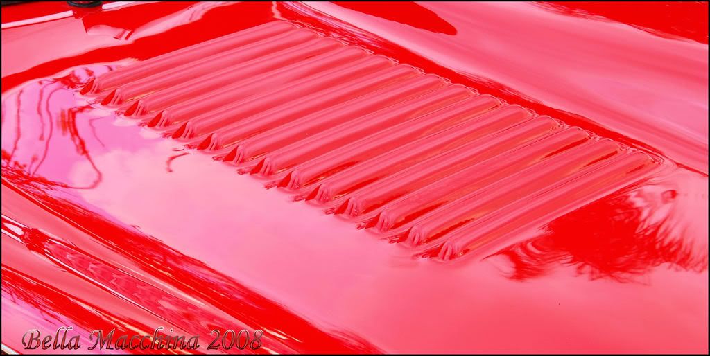

The paint was absolutely glowing and honestly, the pictures do not do this car justice. The combination of artful body lines, high quality aftermarket paint, and about 18 hours of paint correction and perfection probably mark this car as the high light of my detailing career.

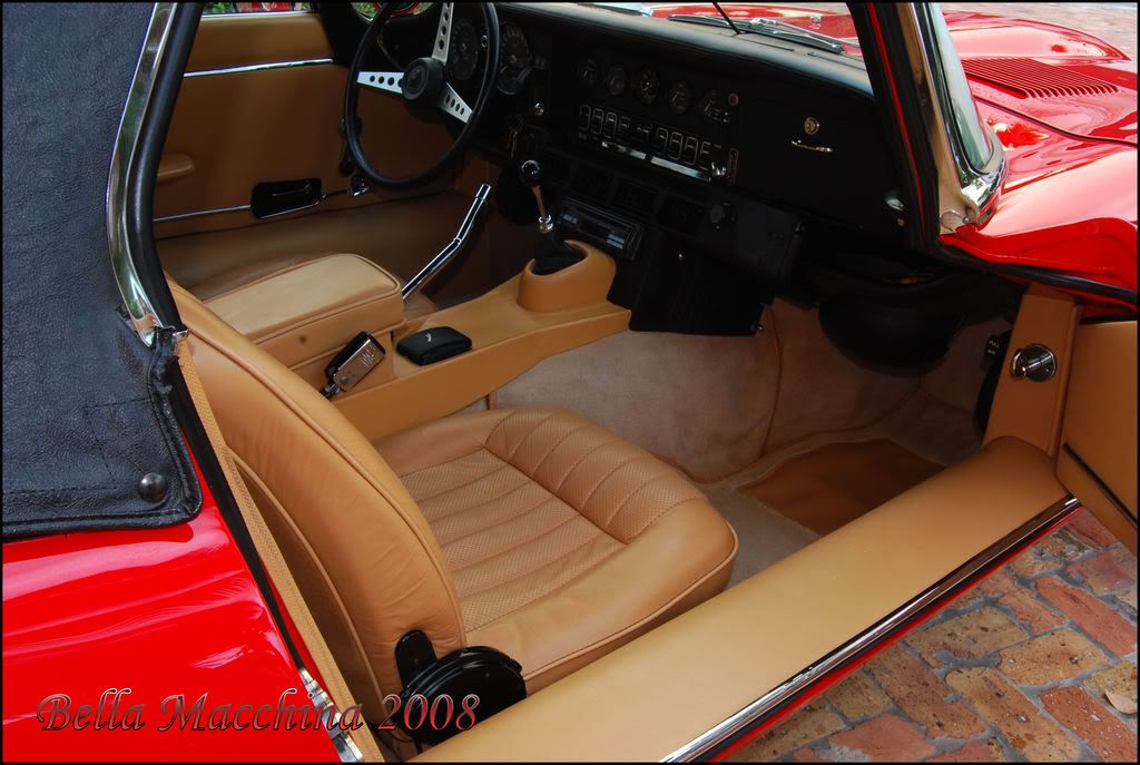

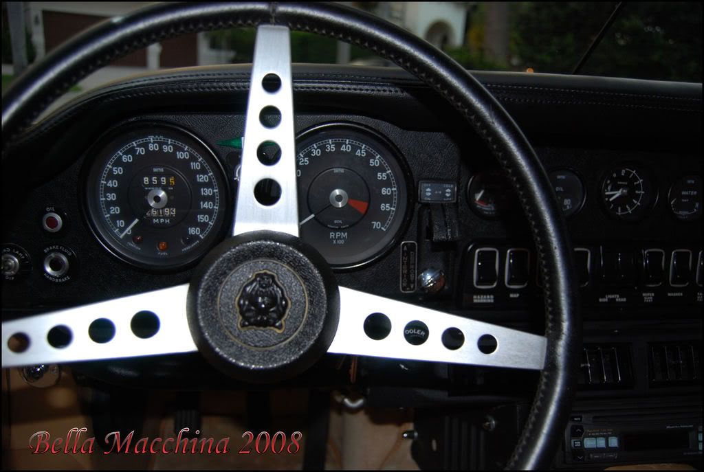

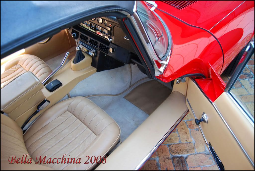

Some after's of the interior.

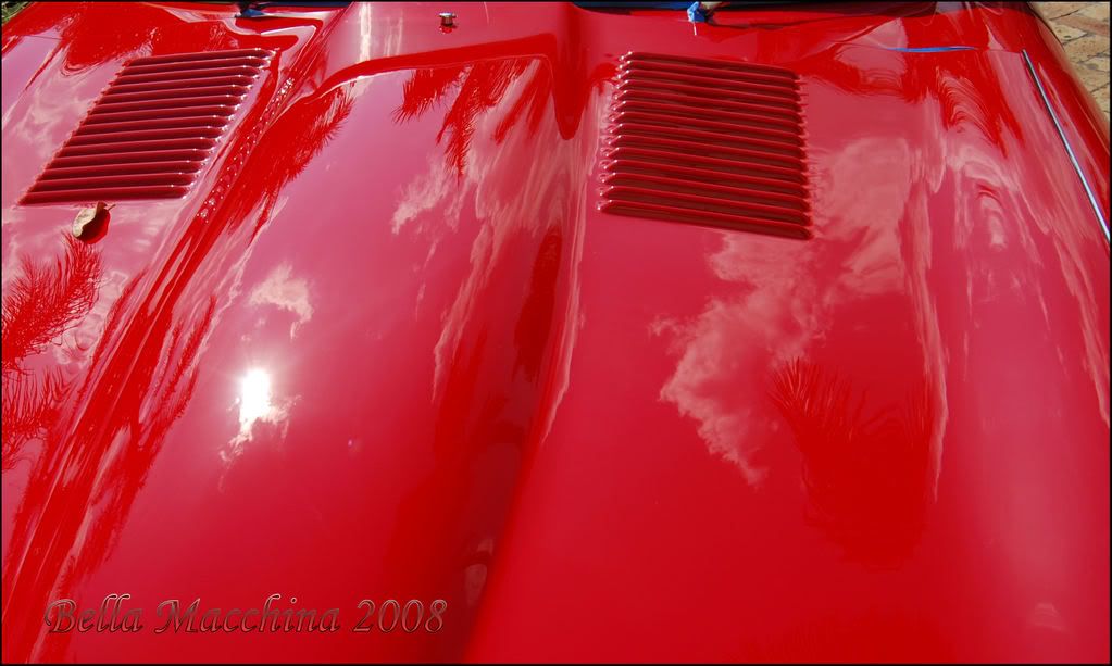

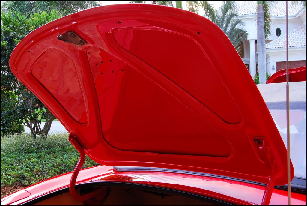

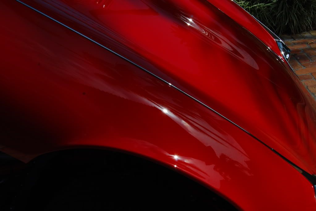

After a night of sound sleep, we returned in the morning to finish up a few details and capture some sun shots.
The early morning South Florida sun...

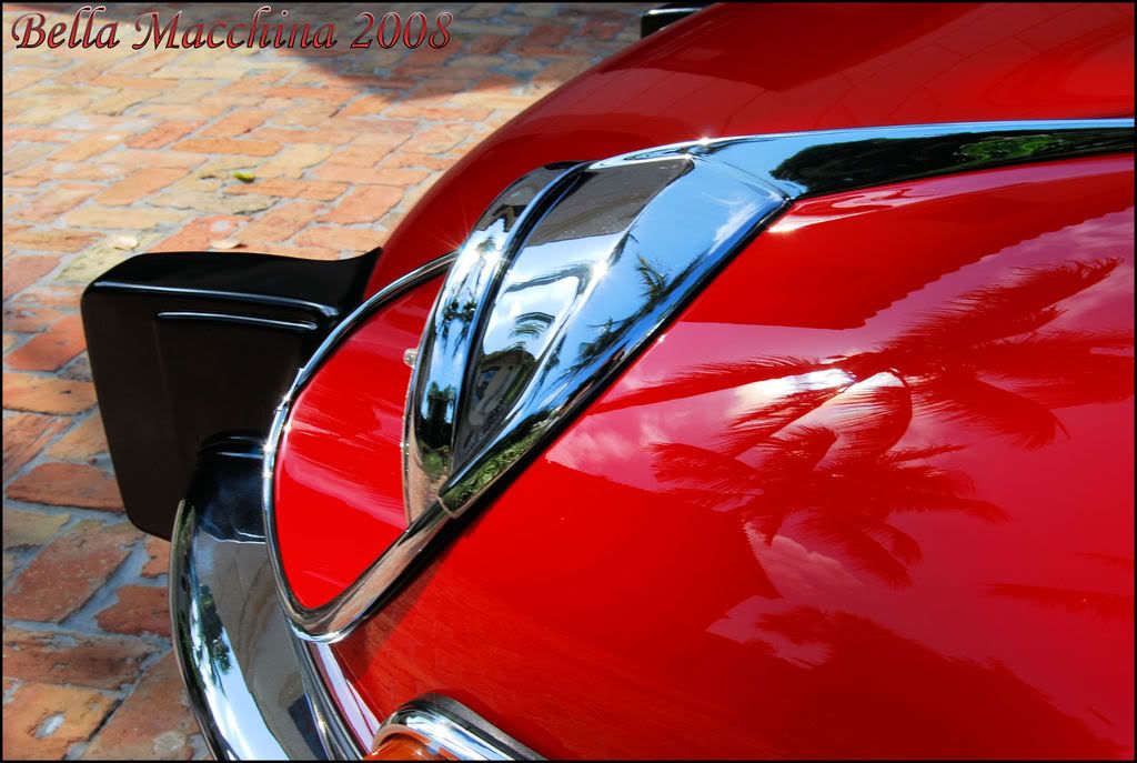

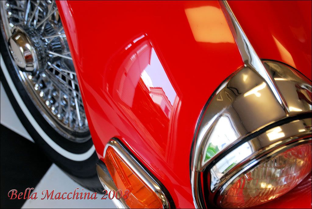

The headlight buckets after a lot of hand polishing with copious amounts of passion.

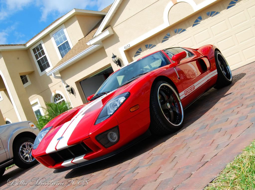

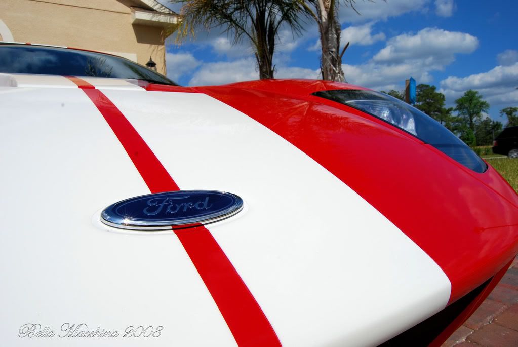

The owner of this car is an American Muscle freak. He owns a Katchek (not sure of the spelling, but the name of the company that builds C6R race motors) Z06 that has about 630 horsepower and a Shelby GT500. He also is considering a lime green 08 Viper :D

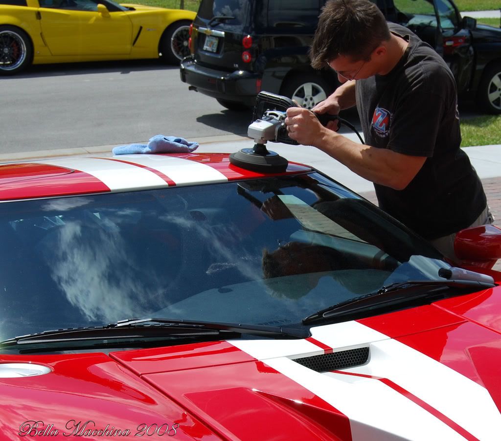

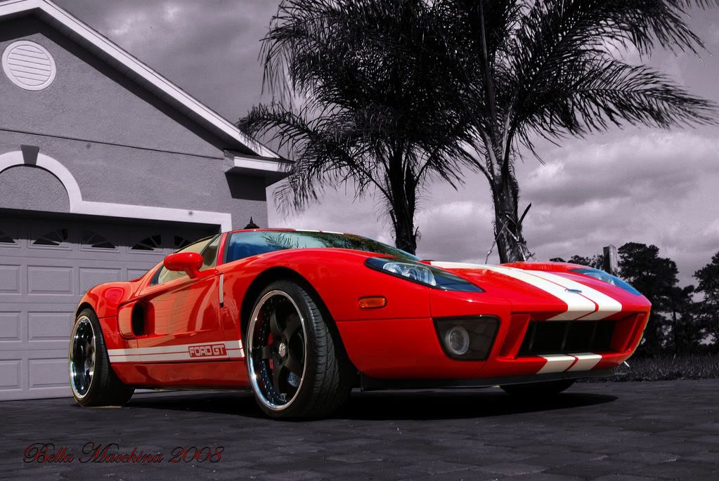

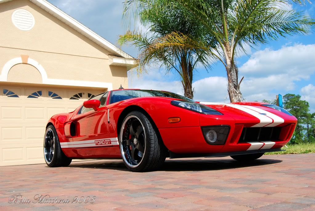

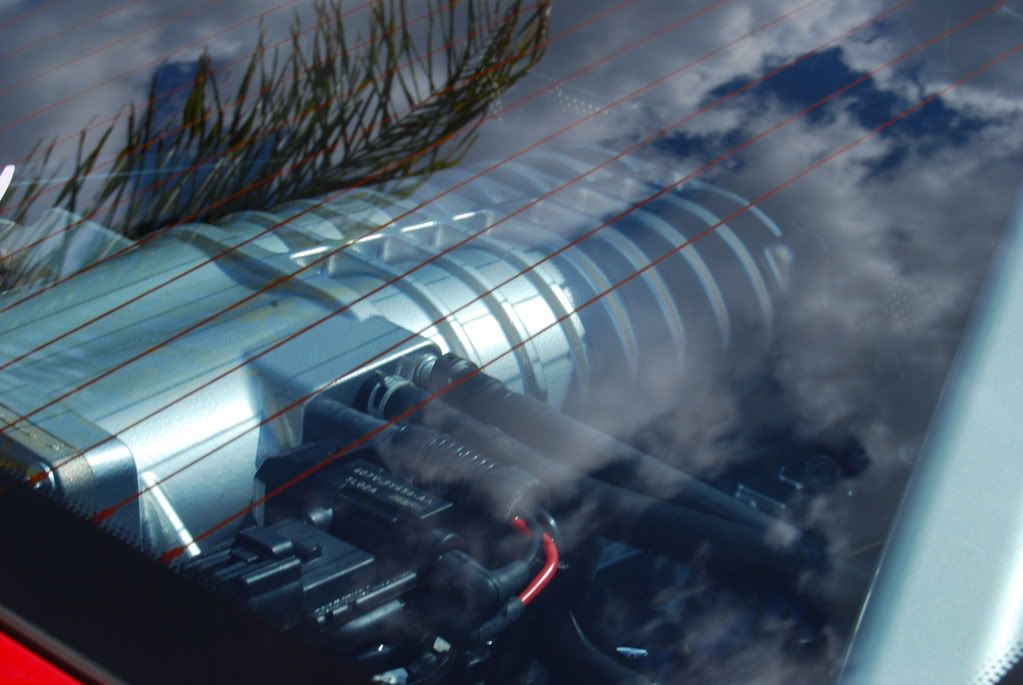

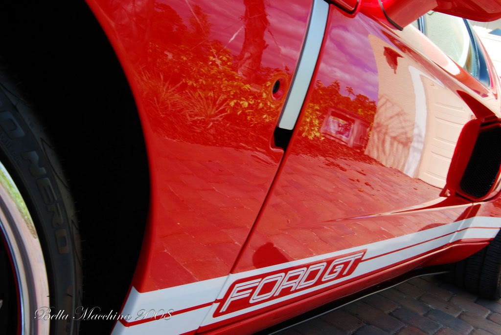

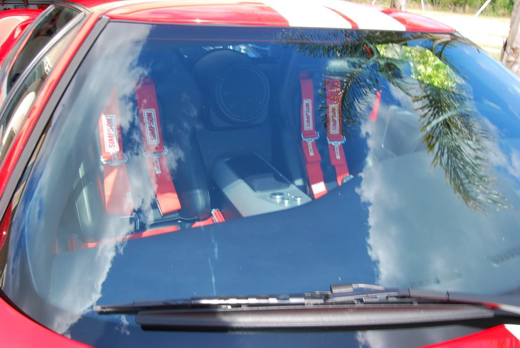

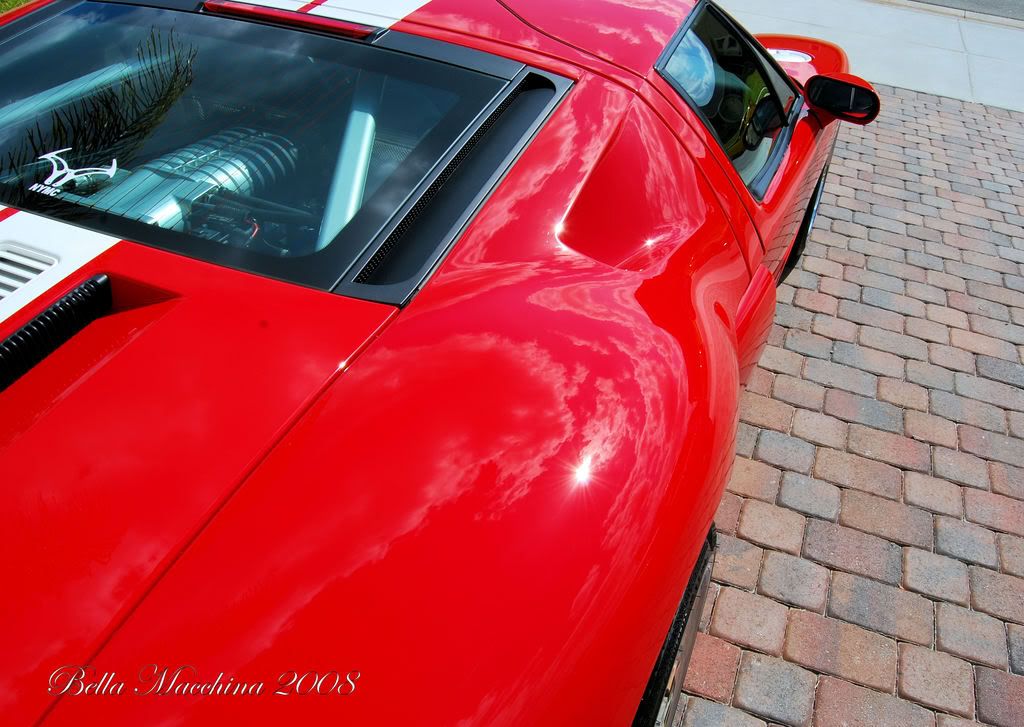

The GT was washed with Z7 and clayed with Sonus Gray.
The paint had moderate swirls and very light RIDS...
The paint was compounded with M105 on a Edge Black Wool pad. This was followed by Menz SIP on a white pad, and finished with 3M UltraFina SE on a Lake Country Blue pad....

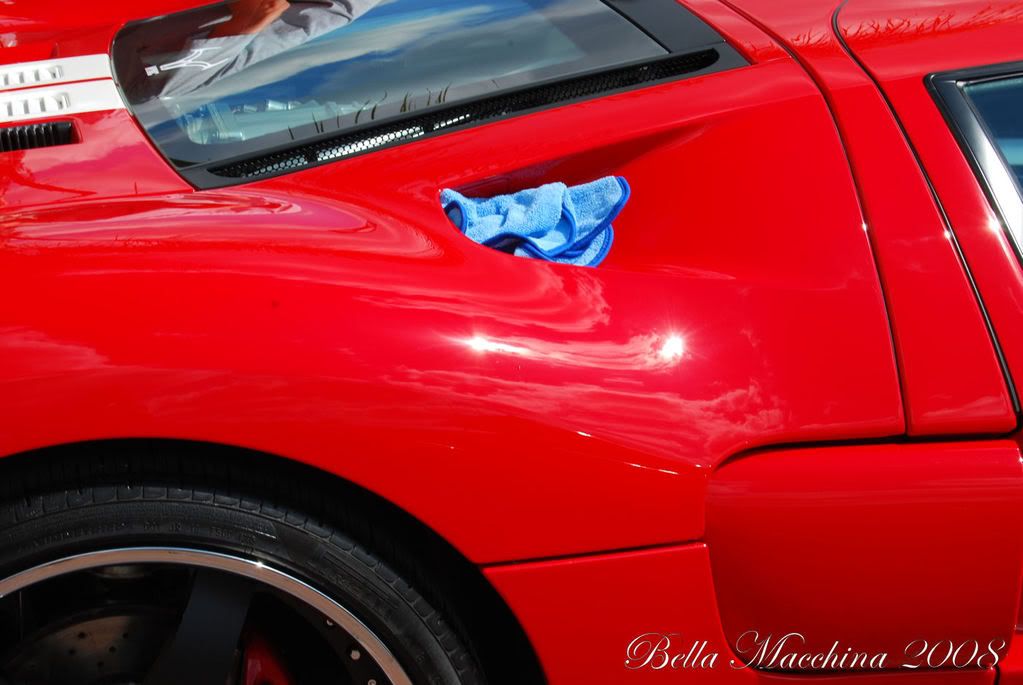

This was one of the easier cars I have worked on lately and only required about 7 hours of correction. The most time consuming parts consisted of working the various scoops with 4 inch pads. Even then, compared to the 20+ hour paint corrections I have been doing lately, it was nice to have a break, lol.
The bottom has been polished...

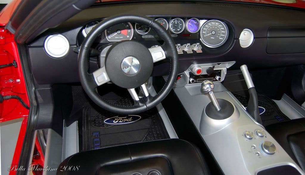

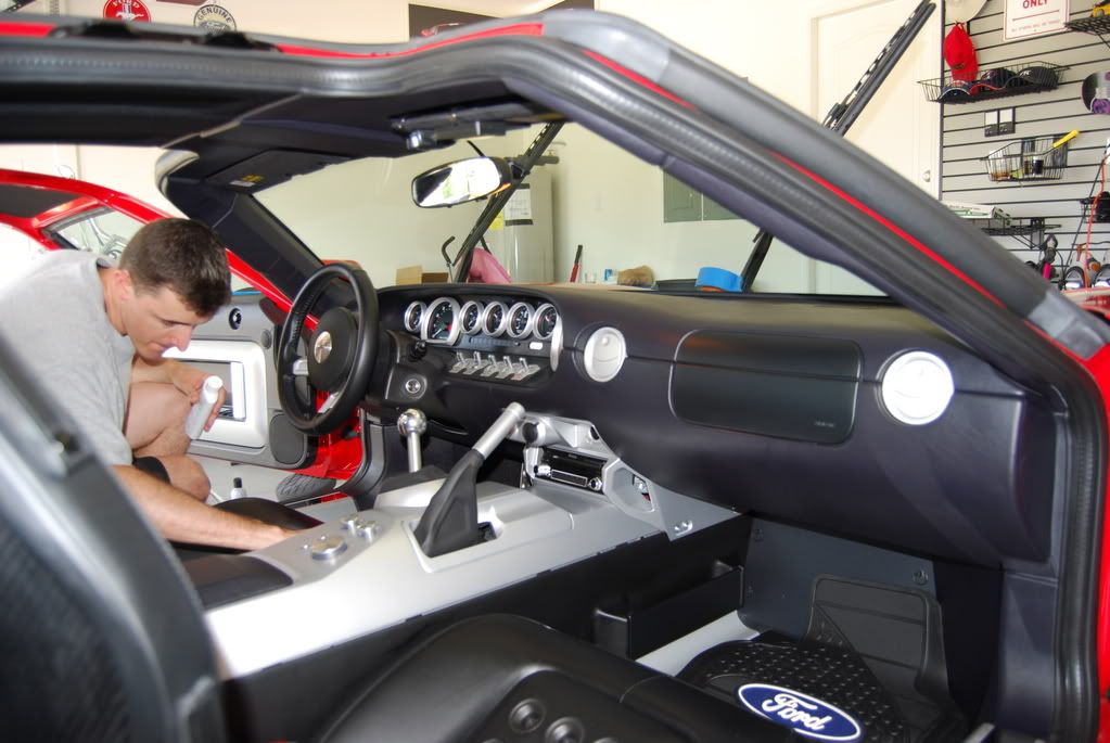

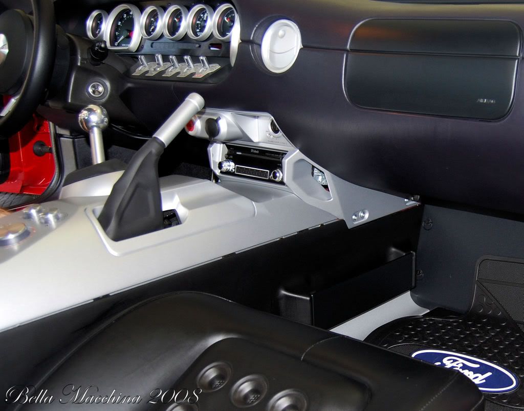

Jon did an amazing job going through the interior with numerous 1Z products, boar's hair brushes, and conditioning the seats with Z9/Z10. 303 was used to add UV protection to the paint and 1Z Gummi Pledge was used to condition the weather stripping.
Your's truely polishing...

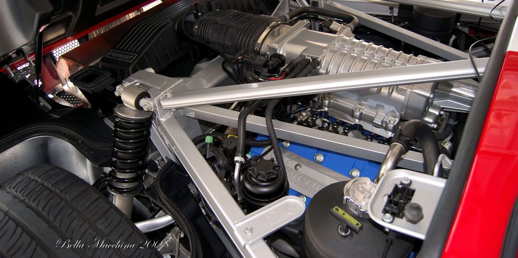

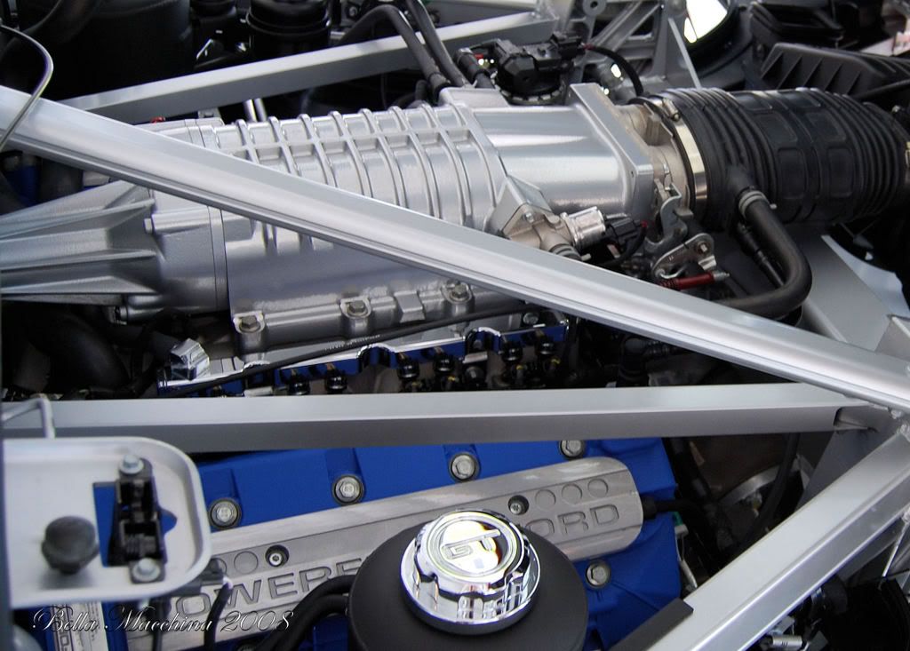

The engine was degreased with Meguiar's Super Degreaser and rinsed with de-ionized water. This was followed by CD2.

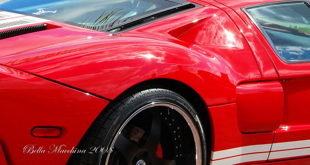

Finishing up with P21s 100 percent.
Che Bella!

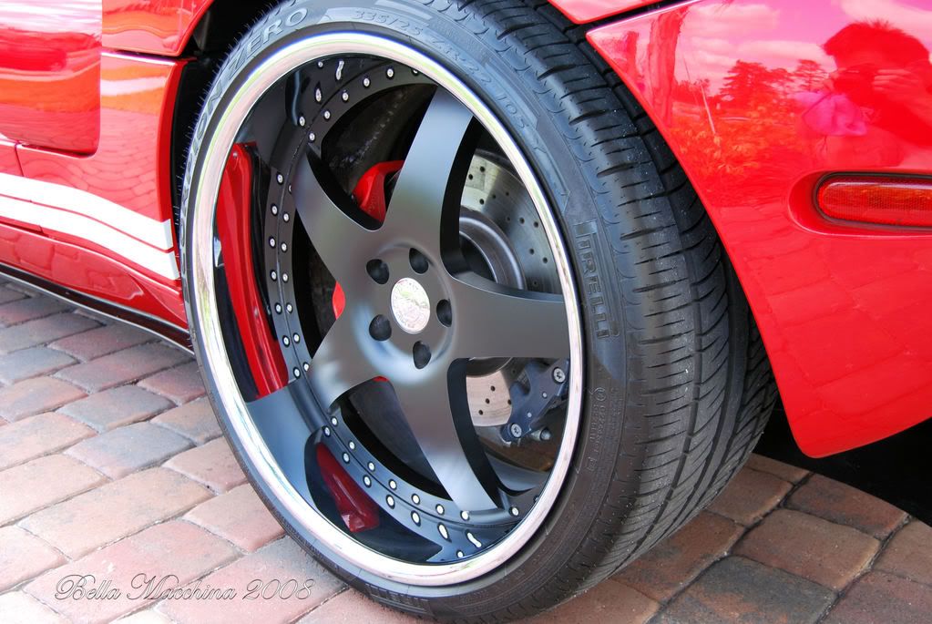

Wheels where cleaned with P21s Wheel Gel and various qtips, brushes, and boar's hair. The wheels where protected with Werkstatt Prime/A Trigger. The tires where cleaned with Meg's APC 4:1, then dressed with Meguiar's Endurance Gel.

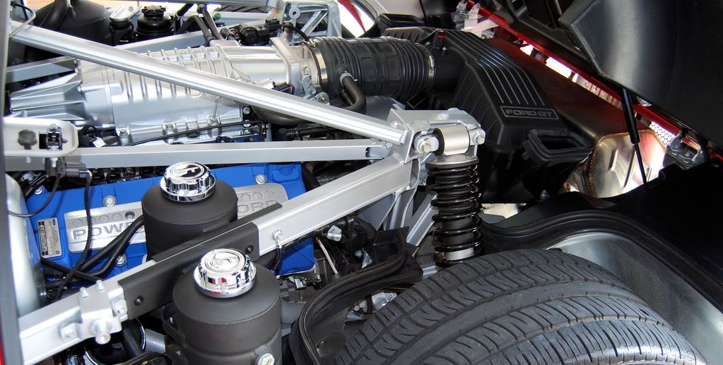

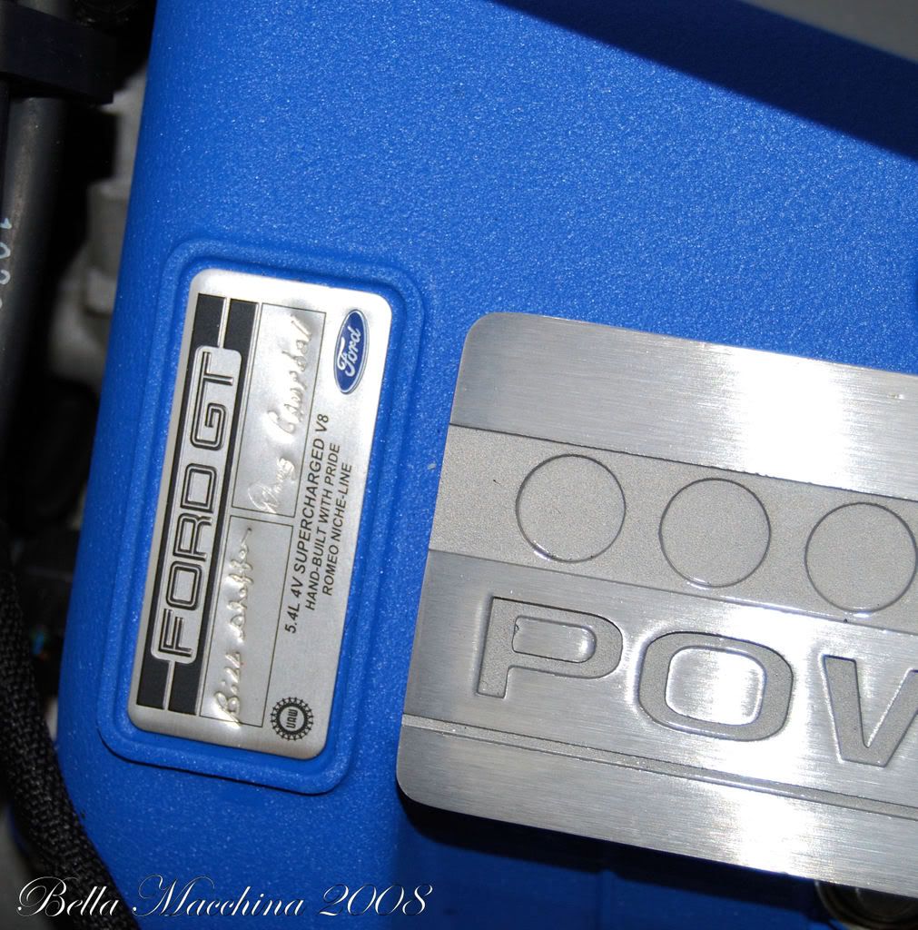

P.S. Does anyone know what kind of paint is used on the valve covers of the GT?
