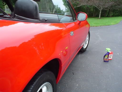

Personally, on oxidation jobs, I usually hit the panels with whatever polish I think will do the job, and use AIO by hand on areas the machine can't reach or where I fear the paint is very thin. This is a single stage Miata I did:
On the half and half hood shot, one side has been polished with OP/LC orange/1500rpm. The paint was very soft.
OP/Orange LC/1500
OP + RMG/Black LC/1200
Souveran
I do tailor my aggressiveness to the color (black, red SS are soft, SS white is hard) - e.g. I have a white SS civic coming up soon, and it's going to get a wool pad and OP to start. For black SS cars, I'd go to the opposite extreme, possibly OP/LC Green/1500 to start, and a PC to finish out.
