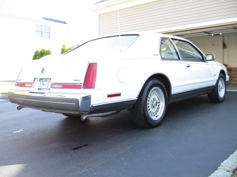

challenge from Saturday 91 Lincoln LSC in white
Saturday was a rainy day here in NY. This was a neighbors car so I was lucky enough to get pics the next before I started working on my 2 drop offs (see prev post with Honda and Ford Mustang). Pictures in the Sun came out a bit on the bright side. I am still learning how to use my Canon SD550
Process as follows
Wash with QEW
Polish via rotary w/ white pad at 1200 rpm with Menzerna Powergloss.
Polish white pad via PC at speed 5.5 with Menzerna FP mix with VM. 75%FP 25% VM
Seal w/ Collinite 845

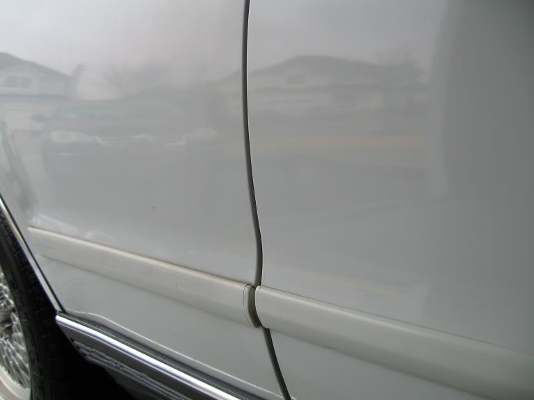

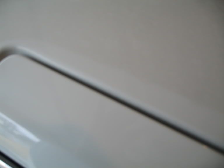

Some before
Bad pic but you can see the brown dirt line over the door gap on this one

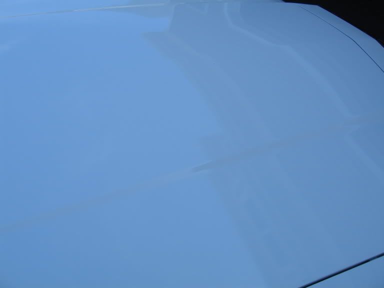

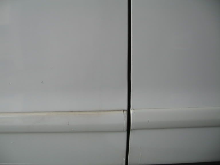

Getting better

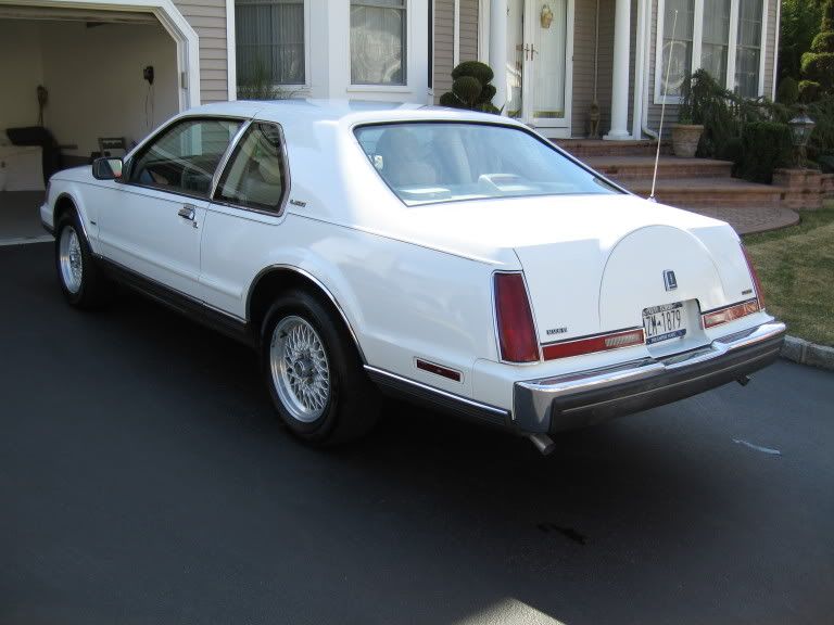

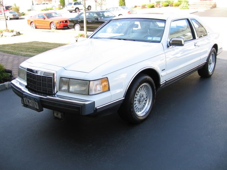

Done... the day after

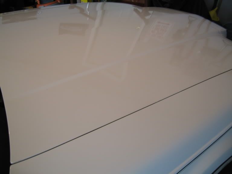

1 garage shot while working the hood, finally got some reflection
White is tough to shoot, especially with a bright background.
Looks like a really good job, you even got those PITA wheels clean!
the clear on the wheels was shot so I polished them carefully and put some rejex on the lips to make them shine. I need to practice some more with these pictures.
