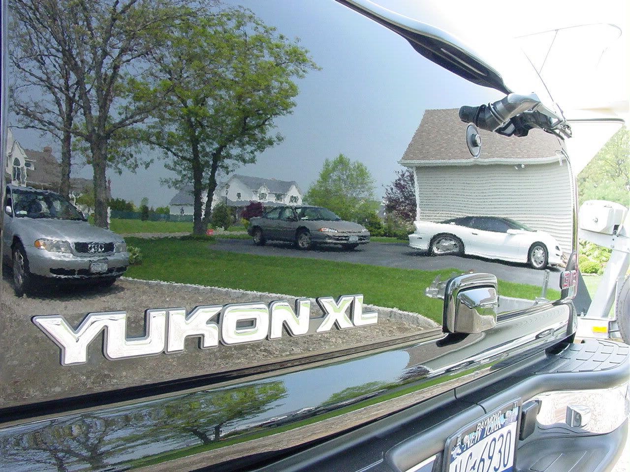

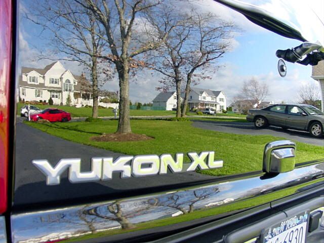

I've been waiting to post these pics for a while. Here is the same truck (exact) detailed at two different times.
The first time it recieved a cleaner wax and S100 topper.
The second time just NXT via rotary and a polishing pad
Difference...You tell me.
Sean, admit it, the first picture is after you wet sanded it ;) I can see your car way in the back.
Seriously, the difference is obvious. I believe DaveB mentioned that the carnaubas have distorting properties thus creating that "warm, fuzzy feeling", err, I meant look.
Different angles, different distance from vehicle and also the exposure appears different.
These differences are quite evident when comparing the reflections off the chrome where not LSP and orange peel exist. Check it out. The OP is also in the chrome and rubber????:nixweiss
